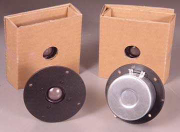

"This tweeter measures very well and is by far the most dynamic non-horn-loaded tweeter that I have encountered thus far with whopping 96db@1m/2.83v senitivity coupled with excellent power handling and best used with a 3Khz crossover."
Is that tweeter 4 or 8 ohm? Eff seems high. The 12lta is clearly more efficient than any of the fostex drivers I have rated in the mid 90s.
Pano, what's the inductor for?
The inductor changes the 2nd order low pass (built into the plate amp) to 3rd order. Can be useful with lower Qts drivers on OB.
It's 4 ohms, but yes, it is unusually high. The ideal tweeter choice would obviously be the fostex FT17H; but at $15/pair, if that sensitivity is true then it seems like a good way to get something going on the cheap!Is that tweeter 4 or 8 ohm? Eff seems high. The 12lta is clearly more efficient than any of the fostex drivers I have rated in the mid 90s.
If the tweeter is 96db at 4ohm it's only 93db at 8ohm... i am not sure it will provide enough output partnered with the 12lta... But... have a look at these!
