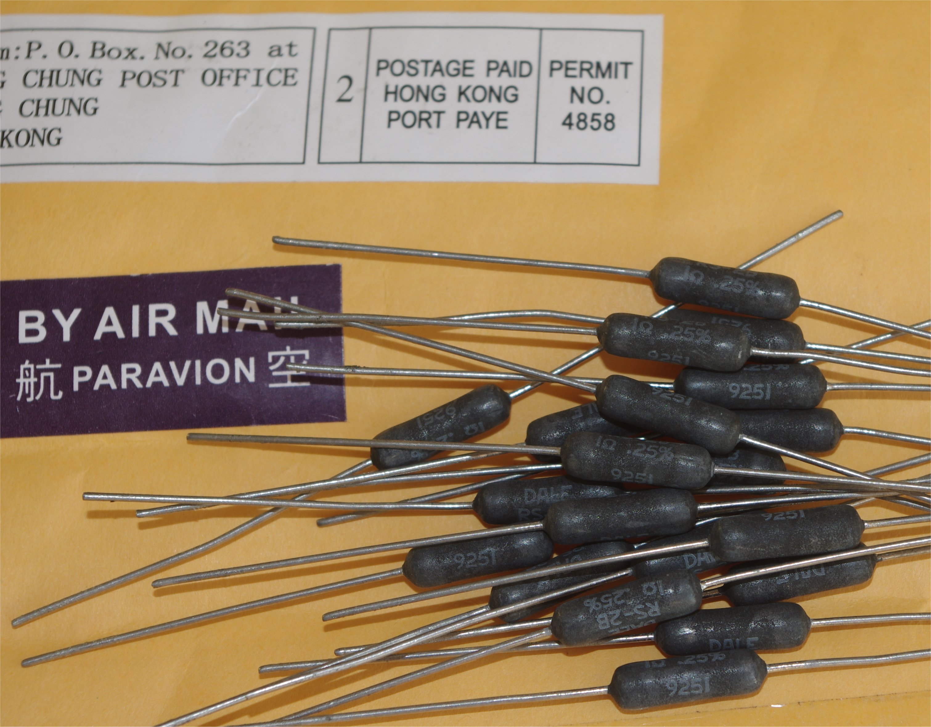

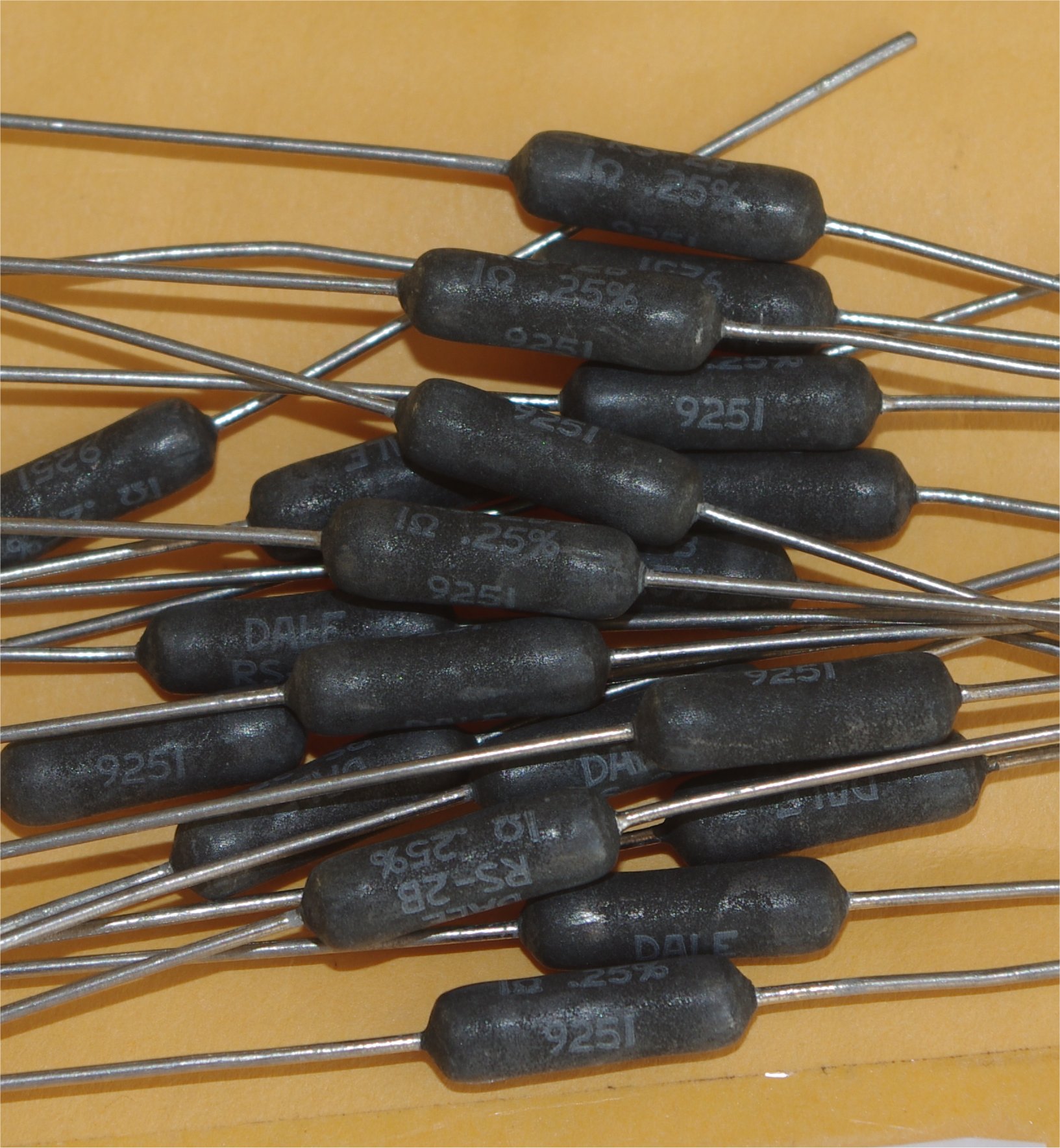

I know is that I was fooled again by a chinoca, bought 20 x 1ohm 3W resistors of 1%, and the liar sent me 25%.
Fortunately there are still some honest.
Does anyone know where I can buy the original R 1ohm? grateful

Blink,
What do they test at? Brrrrr.... terrible grammar.
or;
Do they test within the .25% rating? If so then they are real. Nice!
Ron
Blame it on the Google Translator 🙂 The software of the forums should do the automatic translations from several languages​​, this will happen but when it will not be for our time ....

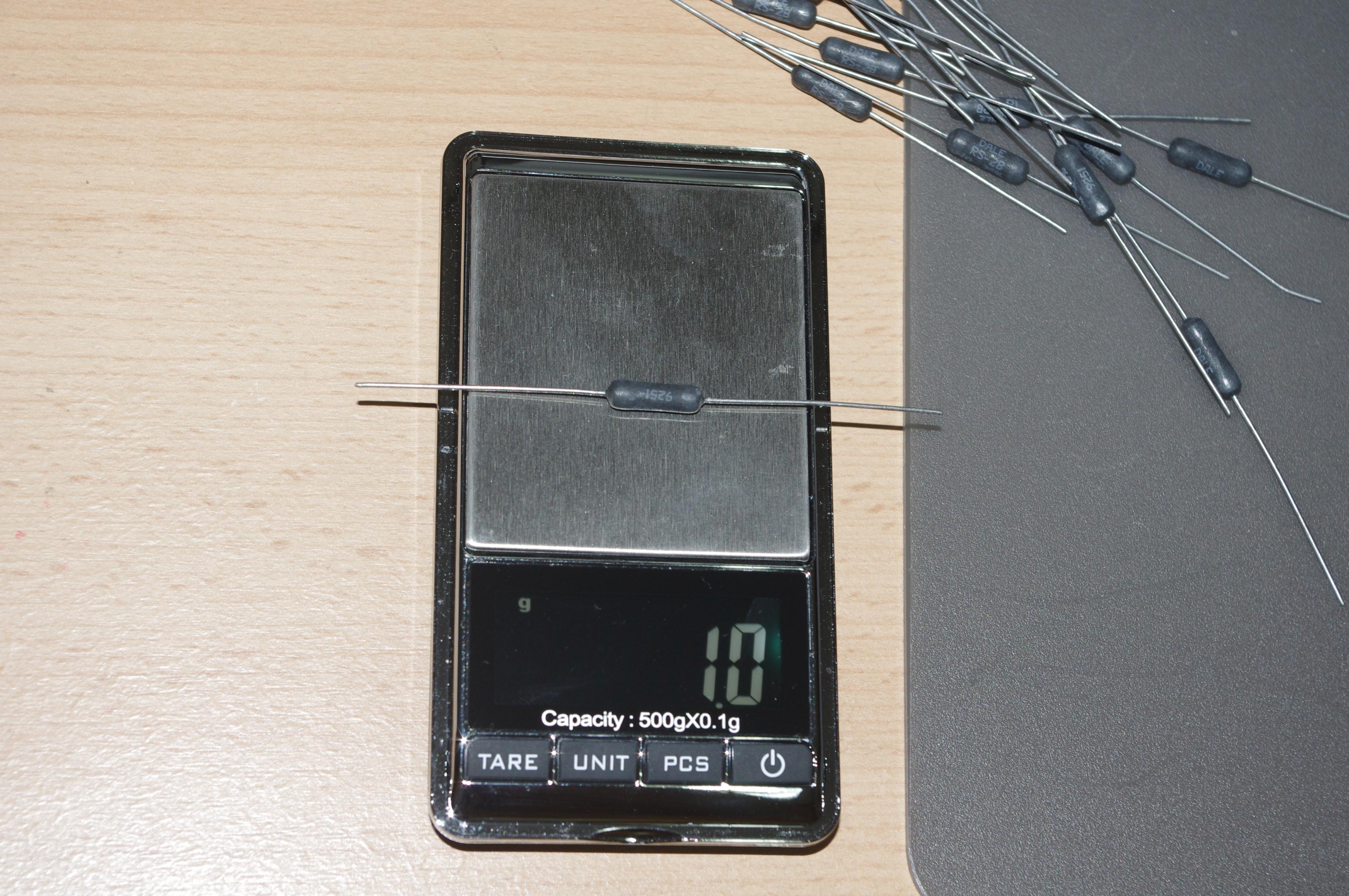

Analyzing the data sheet by Vishay, these are false Rs.
Let's see what the data sheet says (RS02B equal to RS-2B):
The most critical is the terminals are Standard Terminals: 100% Sn, or 60/40 Sn / Pb coated Copperweld.
- All resistors are attached to the magnet, the terminals are made of iron!
- Then weigh 1gr. should weigh 0.70gr (is iron)
- The format of the resistors is not symmetrical, looks more like a blood sausage or a salami.
- And no measure is correct.
I have to search on the Digikey sell to 1ohm 1% 3W!
Copperweld, AFAIK is a trade name for copper coated steel. Frankly, your resistors look legitimate to me. I have lots of similar looking pieces in my junk box and they've always performed well.
If they measure within the specification then you're fine - just like Ron says.
