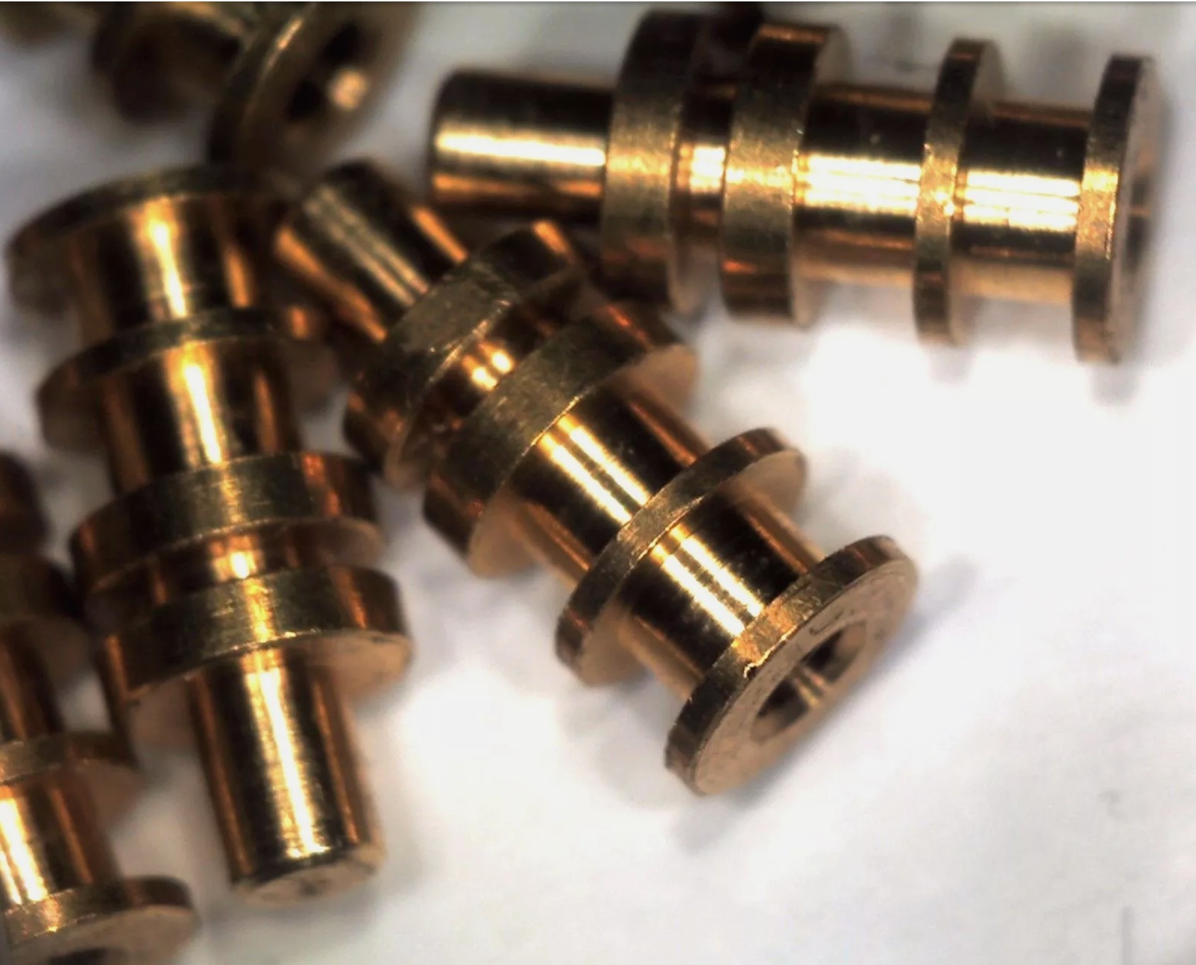

I bought a couple of packs of machined PCB turrets but haven't found the right tool or technique to support them when setting the tail. The turrets collapse when I try to set the rivet.
I was expecting the outside diameter of the wire supports to be smaller than the base OD to allow a sleeve tool to transfer the reaction force to the base, but these ones have an equal OD.
For scale, the stem at the bottom is 2mm long.
Does anyone know of the correct tool for this type of turret?

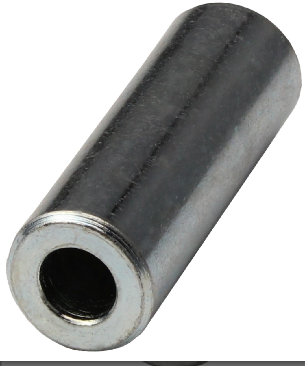

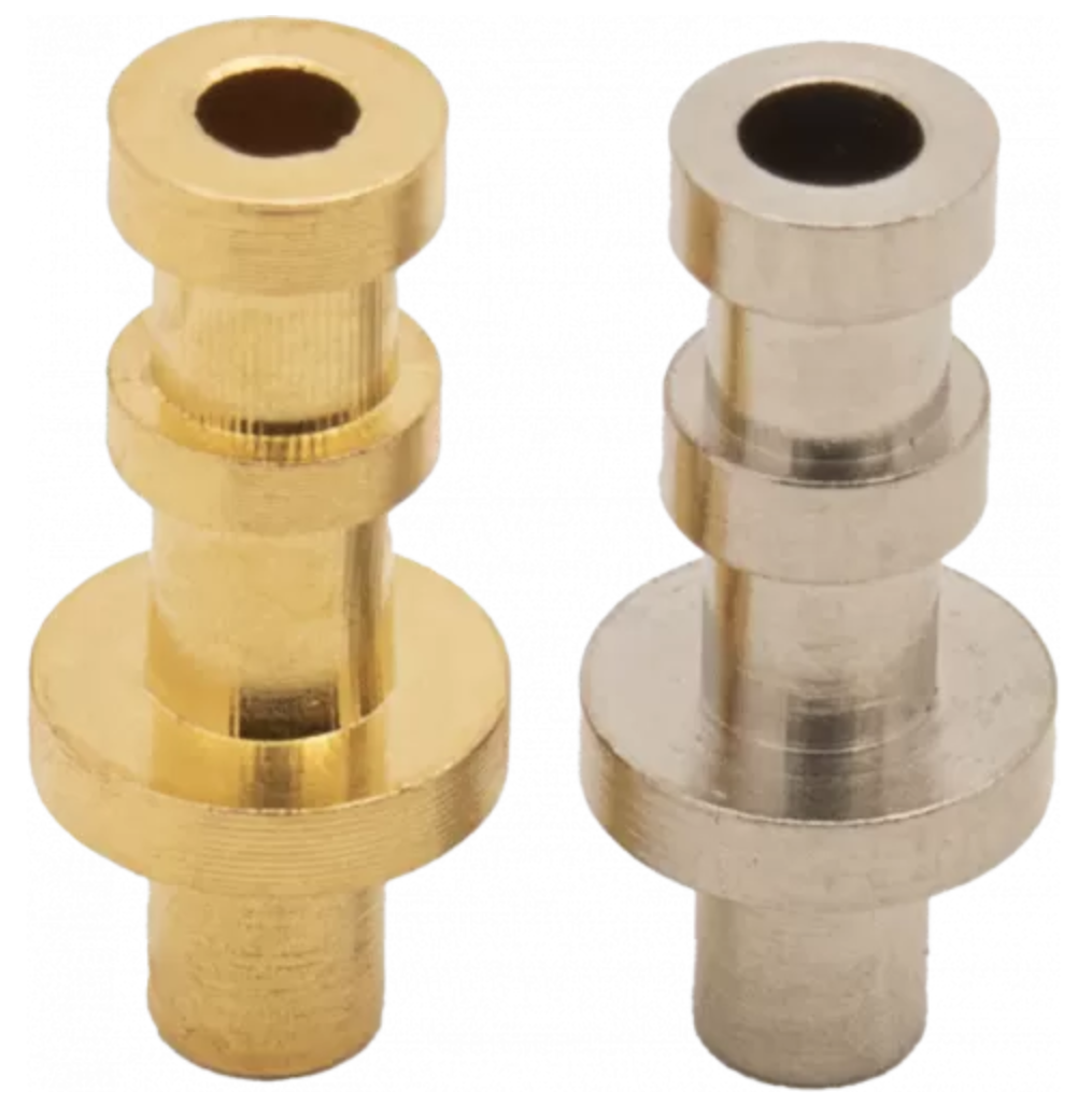

I was expecting to be able to use a tool like this:
But they need to fit over the turret to the base like these:
Thinking maybe I need to buy more turrets..

You are not fully showing the stem end, is it hollow? (so expected to expand like a hollow rivet) or solid? (pressure fit in a slightly undersized board hole)
If you expect to expand a solid stem, such pressure will certainly crush the full turret.

The bottom of the stem is solid. The turret is hollow.
Definitely a good idea to check solderability.
They are brass, so I thought they would set like a solid rivet.

Just thinking aloud:
1) the hollow is not designed to expand, but to take a component leg (or naked solid wire) in, as an alternative to wrapping it around the turret, meaning it´s not a mounting feature.
2) the stem pressure fits in a slightly undersized hole, use a tool similar to the one in post #6, not pushing a shoulder you don´t have, but turret top.
3) I hate turrets and much prefer hollow rivets "Fender style"
