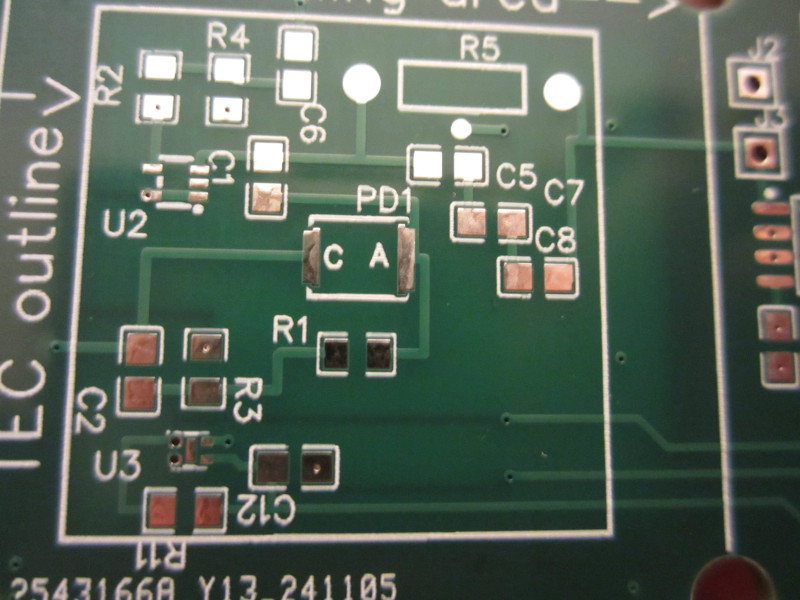

So why do I want to remove no-clean solder flux from a PCB? Well, I have a non-audio PCB that will have up to 900V across an SMT-style capacitor, and I'm just not comfortable with the idea of having that slimy stuff in that area. The other side of the capacitor feeds a current-to-voltage converter with a gain of 1e6 so it won't take much to screw things up!
The reason I'm asking in this forum is that the subject may be (is?) relevant to those among us who are vacuum tube aficionados; and, in fact, my application DOES use a vacuum tube (but it has nothing to do with audio -- it's a photomultiplier tube).
The best approach most-likely is to just use a water-soluble flux but then there's the fact that I assembled my board with the no-clean stuff before I thought of this potential problem 🙄. Water sure doesn't work...

I would have thought that as the flux from SMT solder pastes is only on the pads, it stays there or becomes a thin splattering of tiny drops around each pad, i.e. not a continuous film that might allow conduction. Attempting to clean such a surface runs the risk of smearing the flux drops into a thin film whereas originally it was isolated spots?
the conductive no-clean flux sits under the part. you have to remove the part and resolder a new clean one
Why would there be solder paste under the part? Does the flux wick under parts sometimes? I guess if that happens its not going to be easy to spot.

Not with a package this size (U2):I would have thought that as the flux from SMT solder pastes is only on the pads, it stays there or becomes a thin splattering of tiny drops around each pad, i.e. not a continuous film that might allow conduction. Attempting to clean such a surface runs the risk of smearing the flux drops into a thin film whereas originally it was isolated spots?
The "big" SMT devices are 0805's, except for PD1 which is a photodiode. U2 is a TI JFE150. Pins adjacent to the gate are biased +/-10V so there WILL be leakage to the gate if I don't remove the flux -- the JFET is used as a TIA and has a 10M feedback resistor. I would have designed-in a guard ring but one of the pins is too close. The gate is the upper-right pin.
Hand soldering will spread flux all over the place. NOT using flux is an almost-sure way to end up with solder-shorted pins. I've been there too many times, even if doing the operation under a stereomicroscope.
Back to the no-clean flux issue, I have found that denatured alcohol does a nice job of removing the flux. I have a small ultrasonic cleaner so I put the board in a small mason jar, added the alcohol, then screwed-down the lid to keep the alcohol from evaporating. Water in the ultrasonic bowl transferred the ultrasonic energy into the jar (it's necessary to have water in the ultrasonic anyway, to protect the transducer). It worked a treat, so I'm moving on to actually assembling the board.
R5 is the 10M resistor. It's an axial because I'm going to wrap some fine wire around the body and solder the wire to ground. it's a way to short out the parasitic capacitance across the resistor, which greatly reduces the bandwidth of the TIA.
