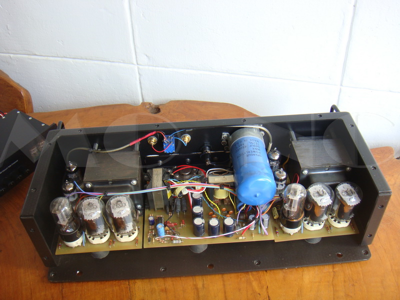

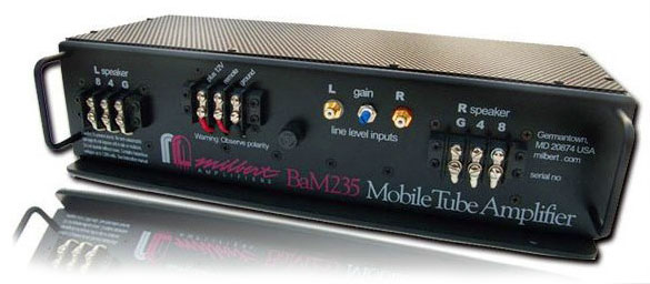

Even cooler- Milbert BaM230/235 from the 80's.
I didn't realize they were still active. Milbert, the Most Musical Amplifiers
