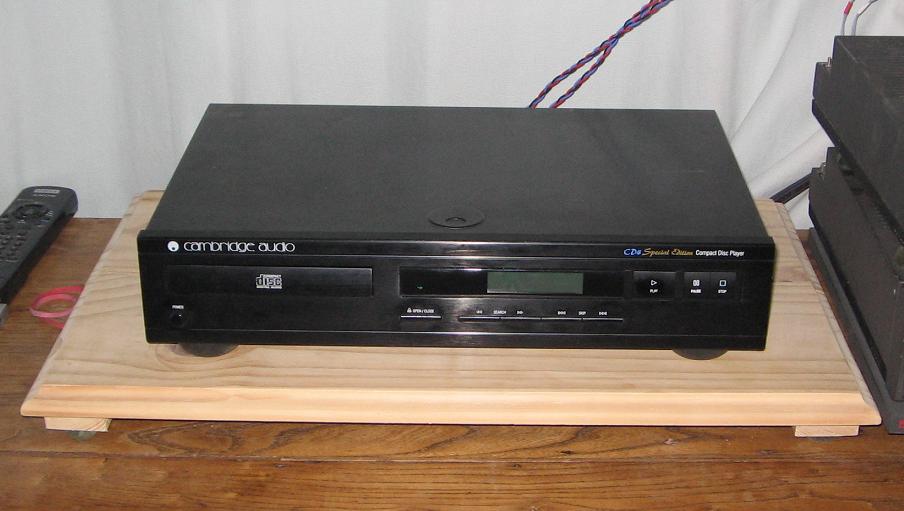

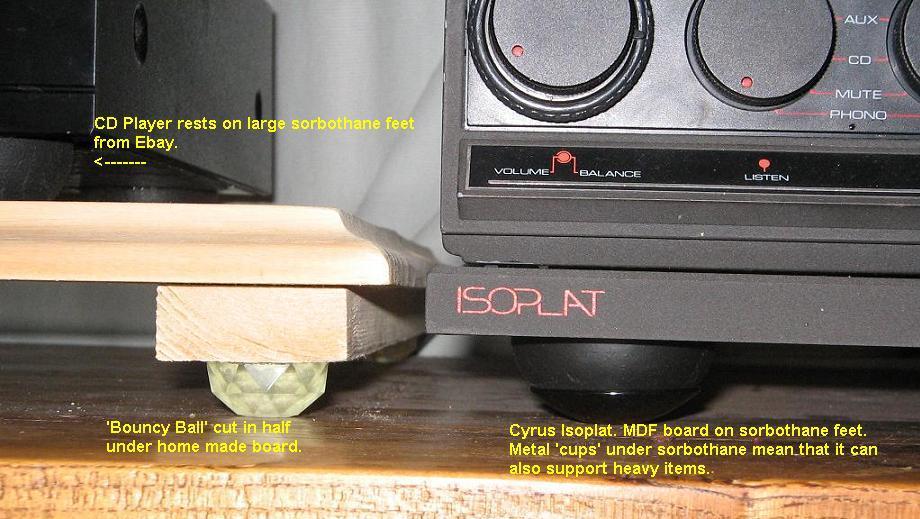

I made this very simple isolation board from two cheap pine shelves back to back. Perhaps pine is a little resonant but it was very cheap and looks quite good. It rests on cut rubber balls.
I don't use it any more because the CD player already has sorbothane feet but this particular sorbothane leaks brown liquid and the shelf is there to stop me being shouted at!!!
My amplifiers rest on a Cyrus Isoplat which is a Fibreboard/MDF panel with sorbothane/metal cup feet. This makes more sense since the fibreboard is 'lossy' and less resonant. The idea of sorbothane is very interesting since it is a visco - elastic material and possesses many of the properties of a liquid. It's worth noting that sorbothane comes in different grades and the Isoplat's sorbothane is much harder than the stuff under my CD player.
Best regards,
Martin🙂

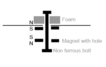

I've made a kind of prototype - I bought some round neodynium magnets to use to attach speaker grills but they were way too powerful so tried to find something to do with them and ended up making a kind of magnetically sprung bit of MDF for some reason 🙂
I haven't tried it as an isolation platform in practice - I've actually taken it to bits now - it should work fine but I think the bottoms of the bolts will need fixing in place.
