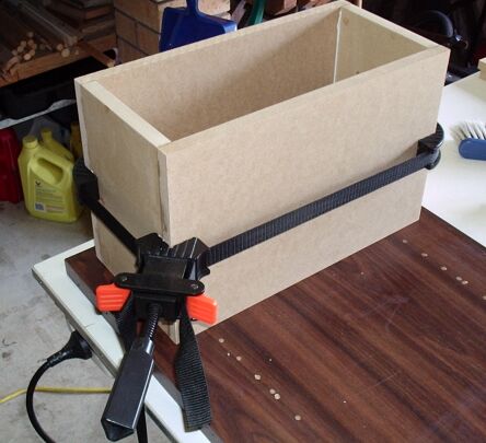

I've used weights in the past when clamps are unavailable or too small: http://www.vikash.info/audio/mtm_floorstander/build_day04.aspHow to glue wood if clamps are out of question? More precisely, how to ensure that the angles are and stay right? And how do you do it, do you glue the sides to the top and bottom first and then the baffle and the back or all at once?
I think the method used to attach the pieces together is quite important. I attach one panel at a time and in a very particular order so that only the ends of each panel can overhang. These are then trimmed off with a router and flush trim bit for perfect finish every time. For this method I use 4 precisely cut panels and two slightly larger-than-required panels.
As each panel is attached the enclosure will gradually sqaure up.

You build them in exactly the same way that I do, it works well and is easy to do. I use clamps though, you can never have enough clamps
I never glue anything, even if i have clamps (which i do) without using dowels or screws. I rarely use screws. Even with good clamps there is always a chance that due to the slick nature of the glue, the wood will slide around a little bit. Having a couple of dowels holding the pieces in place prevents this and also adds to the strength of the structure. Try placing them at non perpendicular angles to the piece of wood to better hold the wood in place.
