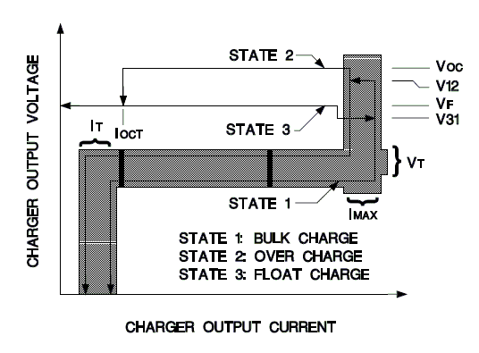

Lead acid cells are 2.21 Volts per cell at room temperature. To charge a 12V (6 cells) lead acid battery to full capacity requires about 13.5 VDC not 12. Most automotive alternator regulators actually run closer to 14V.
Several IC houses make specialty regulators for charging lead acid because the correct charge voltage is temperature dependent.
At "full charge" the charger should switch to a constant current mode to avoid over charging.

hermanv said:Lead acid cells are 2.21 Volts per cell at room temperature. To charge a 12V (6 cells) lead acid battery to full capacity requires about 13.5 VDC not 12. Most automotive alternator regulators actually run closer to 14V.
Actually, the battery is overcharged at the end of the process -- the attached pic from Texas Instruments demonstrates:
