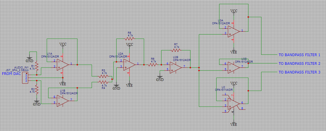

Welp. You anticipated me.
My schematic is the same, the only difference is that all resistors are 4.7Kohm and the output of the last OpAmp is connected directly to the inputs of three other OpAmps without resistor and capacitor.
There is another 4.7Kohm resistor from the output of the last OpAmp to ground as well.
And then, i will be able to use those three outputs for the bandpass filters + gain stages and that's it.
Thank you for all the info 😉

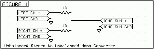

Post #2 and #3 actually have the answer with minimum parts count and complexity. The last circuit will certainly work...but...why? When two resistors will do it just fine? You don't have a PSU, you don't have capactitor type, polarity, polarizing voltage, and active parts to worry about. And the signal you get with two resistors will be identical in every way, except possibly better (if you want to obsess).

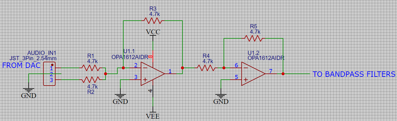

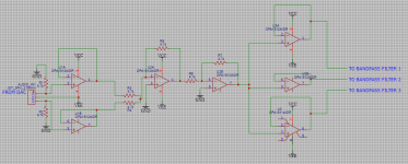

Anyway, this is my version of the schematic. I removed the capacitors because in the datasheet of the DAC i'm using, it says 'No DC blocking capacitors required'.
I used a voltage follower for both channels because my DAC can deliver very little current, and loading it will increase distortion.

Yep 🙂 and many variations are possible.
All I would add is that you could lose the two opamp buffers at the input. You have set the input impedance at 4k7 and the single opamp virtual earth mixer achieves that easily. One opamp should easily drive 3 bandpass filters and so you can get back from 7 opamps to 2.

Alright, thank you.
I noticed i made a mistake in the schematic.
The ground of the audio source is connected to VEE because i mistaken it for GND. It should be connected to GND.
So, in the end... This new circuit should have the exact same audio performance and input impedance of the first one.

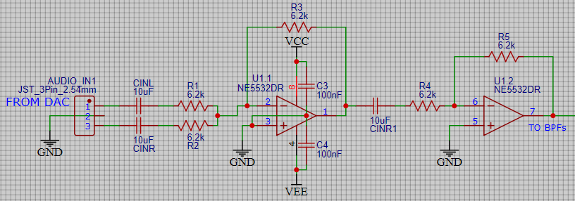

Yes just the same, but just be aware that a virtual ground will see all the opamp pins at 1/2 the rail supply voltage so you might need input and output coupling caps. It all depends how you couple it all together to other equipment. and whether the rail voltage comes from something floating (or not).
The dual supply of ±15V and GND is not floating, it's a proper dual supply, just like the one you can get from trasformers. To get it from a simple supply, i used two B2424S-3W voltage isolators, then added L7815 and L7915 to have a nice linear noise-free supply. It works and i have a ground, +15V and -15V that are completely isolated from the input supply.
I will add 1uF polypropilene capacitors on the left and right input.
Now everything should be alright.
Capacitance increased to 10uF and resistors increased to 6.2K.
The problem is that it creates a high pass filter which would block 20 - 30Hz.
With theese values it passes from 30Hz and above with no amplitude drop.
Let me know if i solved all the problems.
