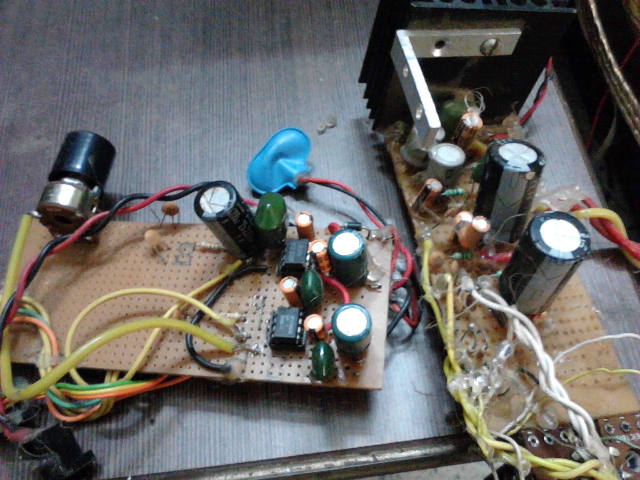

I had stopped building my DIY Amps some 10+ years ago and I always failed to achieve the true professional result at that point of time. Then I moved on to different commercial audio systems and I was happier until I realized "something" was lacking there too. I was not 100% satisfied with various (and costly) commercial products available in my locality.
So I took resort to DIY again. And I then found companions - Internet and some amazing fora like Diyaudio.com
First I built some ultra low cost low wattage chip amp ( like LM386, TDA2822, TDA2009) following the official datasheet on perf boards again for a test, just to brush up my long forgotton "knowledge and skill"( if any, hehe). And yes, I used a 9v battery for the first power up.
And now, regarding my current project, even if I, in no way belong to the audiophile category, can safely say that they do so clearly reproduce a sound/music that I never ever heard with commercially available products I used earlier in my whole life. I guess It would not be an exaggeration to say that I am rediscovering music at this age with a new dimension with my personal DIY project.
The system might not be financially feasible to a great extent but the scope you get to tweak and optimize to obtain the purely pristine sound to suit your personal taste is unparalleled and sure CAN outperform most of the commercial products. And more the system is easily repairable as it is made by you!
All the very best and merry Christmas!
Hope this post does not sound like self propaganda 😛
