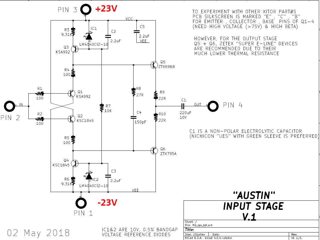

I would consider a diamond buffer as none of the ccs loaded fet followers sound any good to my ears. Of course YMMV.
The M2x power amp uses a diamond circuit to implement a unity gain voltage follower; the follower is called "Austin" and its schematic is attached below.
Another possibility is an opamp with an external current booster IC, connected as a unity gain voltage follower. This follower is called "Norwood" in the M2x, and its schematic is attached below.
Both of them are daughter cards, 35mm by 40mm.
