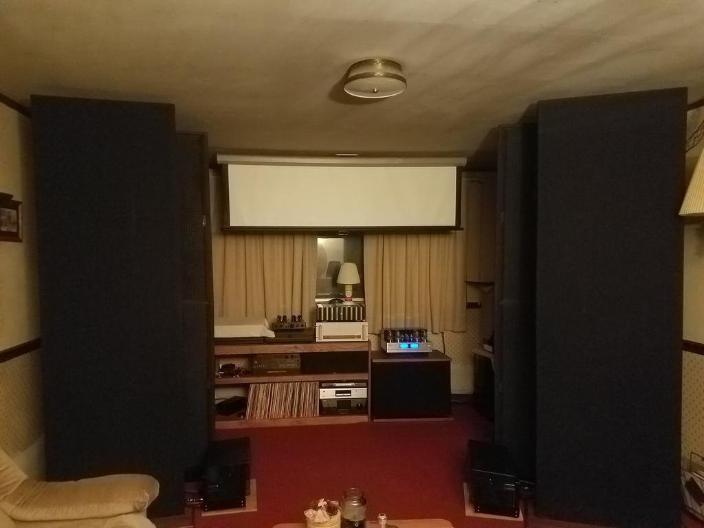

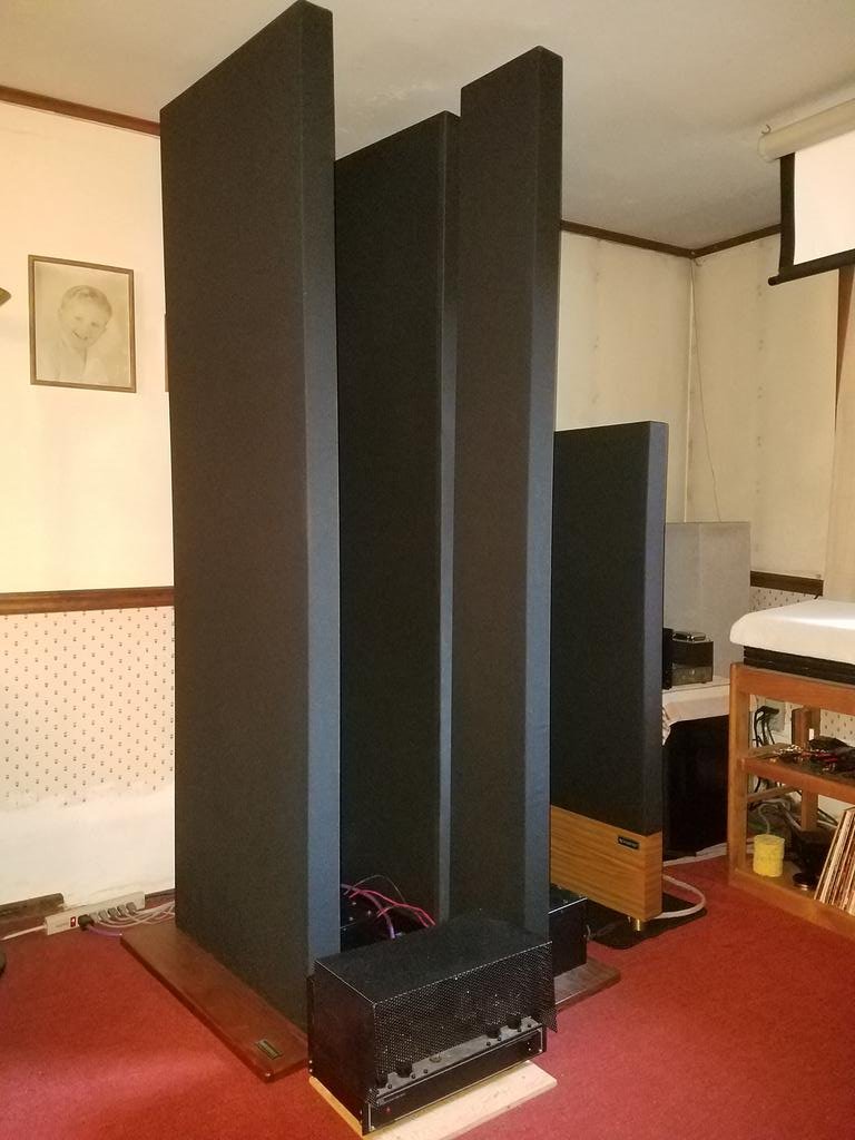

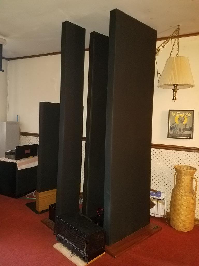

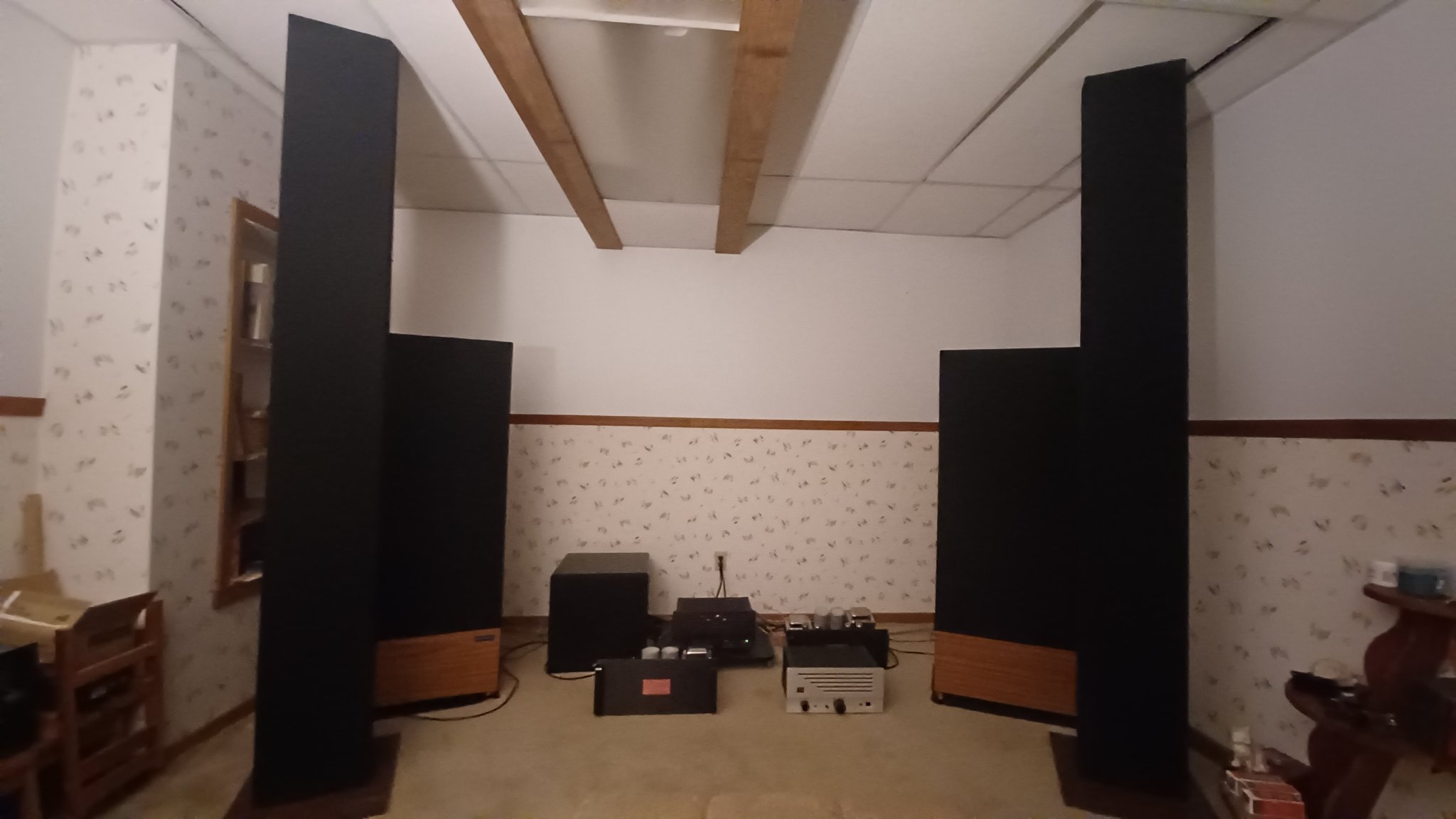

I have owned Acoustats since 1986. I now have 7 pair of Acoustats. 2 pair of 1+1's, 2 pair of model 3's, 2 pair of model 6's (1 pair with modified direct drive servo amps, the other pair with Red Medallion interfaces) and a pair of 2+2's. I have used a variety of SS and tube amps over the years. I now have 11 VTL amplifiers to drive my various Acoustat set ups. The VTL's have a tonal quality I have not found with any other amplifier. To me they are a perfect match for the Acoustat's for all types of music. They have the perfect balance of taught, tight, deep bass and beautifully rendered mids and highs. The VTL's I own are rated from 85 wpc up to 225 wpc. I hope you can find either a pair of monoblocks or a stereo amp to try with your 1+1's. I have bought all used VTL amps and have had great reliability with them.

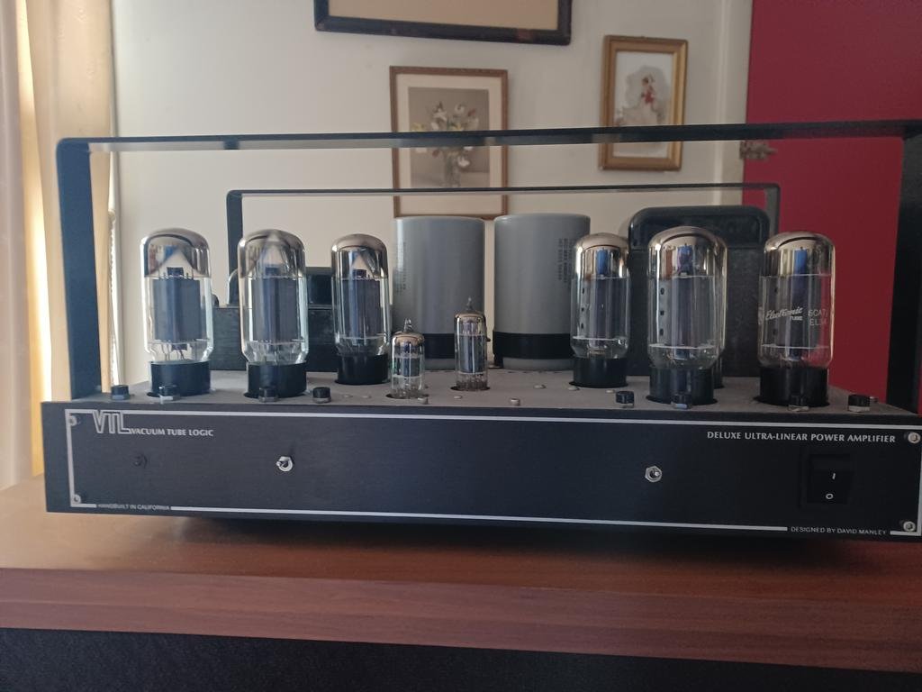

I agree with djn that a tube preamp should be used. VTL makes some amps that are similar in power to the AR D70 you mentioned. I owned 2 AR amps in the past. I feel the VTL sounds more like the real thing, less like hi-fi. Can you tell me what kind of budget you have for a pair of amps? I am using a VTL ST-85 (65 wpc) stereo amp on my 2+2's and they sound incredible. I looked on Hifi-Shark a few minutes ago and saw a pair of 100 wpc VTL's that have an auction ending Sunday. There are a pair of MB125"s in Ca. for $2500 a pair.
Below is both links if you are interested:
https://www.ebay.com/itm/1767697623...customid=d5b69bce-cd81-11ef-8a87-616335613662
https://www.usaudiomart.com/details/649640695-vtl-mb125/
