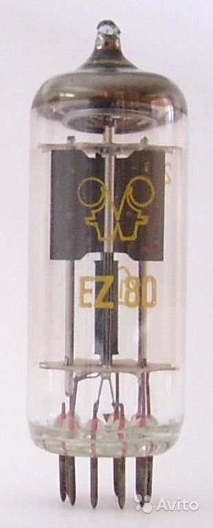

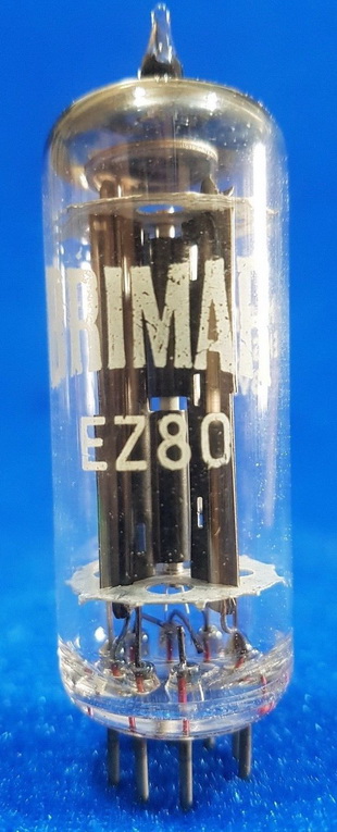

I will illustrate my question. The two photos clearly show the differences in the design of the EZ80.
Due to the fact that there is quite a lot of tubes of this type, I wouldn’t want to do a great job of comparing them (which someone may have done for a long time, and its results are known - except for me).

They are virtually the same design. The one on the left is just on an angle that you see the bottom plates on edge.

But they are both EZ80. The one on the left will run with hotter anodes because the radiating surface is smaller. The active part of the cathode/anode will be about the same for each; if not they would not be EZ80.nmsp18 said:I will illustrate my question. The two photos clearly show the differences in the design of the EZ80.
