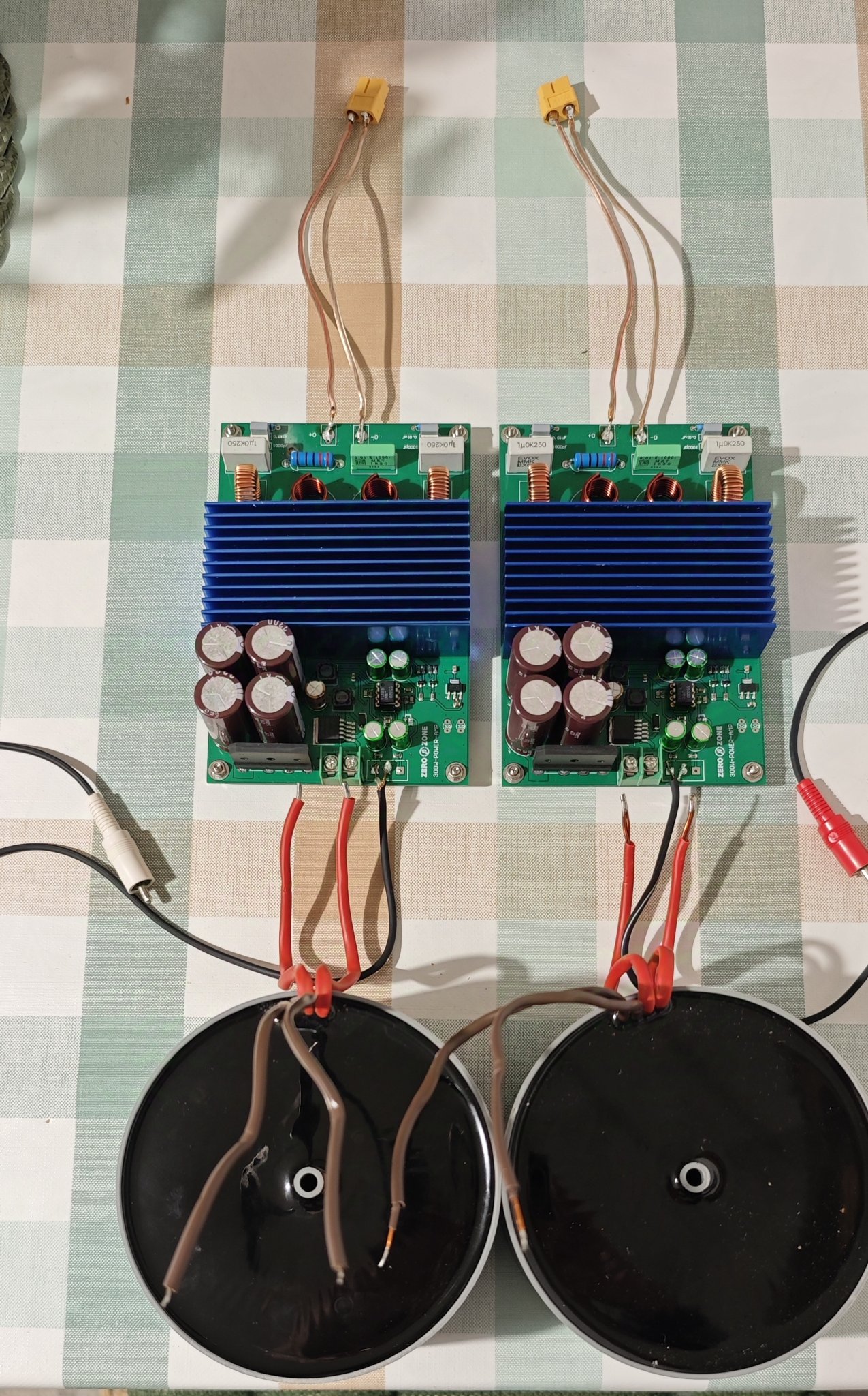

Got theese babies because of the rave review from the YouTuber HiFi Zone who has reviewed many amps of all types.
His where the ready made ones that are fed by an external supply.
These boards here are identical except for the bridge rectifier on them.
Even in stock form they sound better than my Ayima 3255 that has the OPA1656 and other mods that where suggested in the Ayima thread. I will see where some discreete opamps and some other needed changes will get me.
They are configured as SE but one bridge will make them fully balanced, which I always found to be markedly better on all these TPA and Merus boards.

Some link, please.Got theese babies ...
...These boards here are identical except for the bridge rectifier on them.

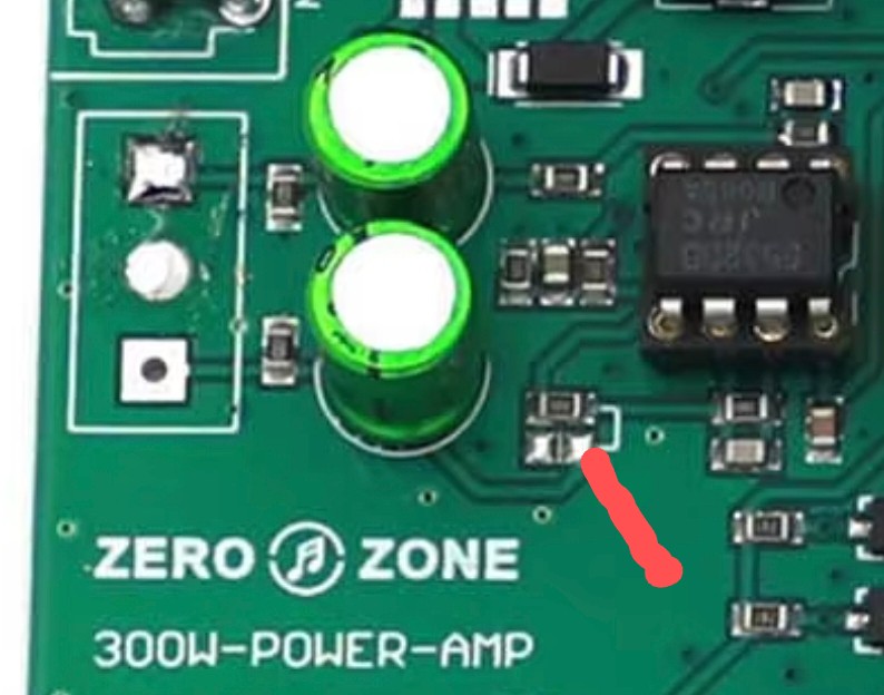

They do have fully balanced inputs.
You just have to bridge these two pads with a zero ohm resistor or with a wire
https://a.aliexpress.com/_EvAFtSN
Thank you!
They write to just fold the 1002 R 90°, OK.
Then you get an XLR input option and nicely sized coils, which is nice.
The 50 V caps on the other hand are less great, and the provider recommends a maximum voltage of 31V. That's a little irritating.It doesn't have to be 48V, but if 36 volts seems to be higher than recommended... that won't work out for me.
Please, why no 63V voltage rating? Too bad!
Not a deal breaker for me as I usually chance the caps to my preferred once anyway.

OK, I checked them twice 😉
The board is powered by classic AC transformer, then it's voltage is fine!
Back on the list 🙂
