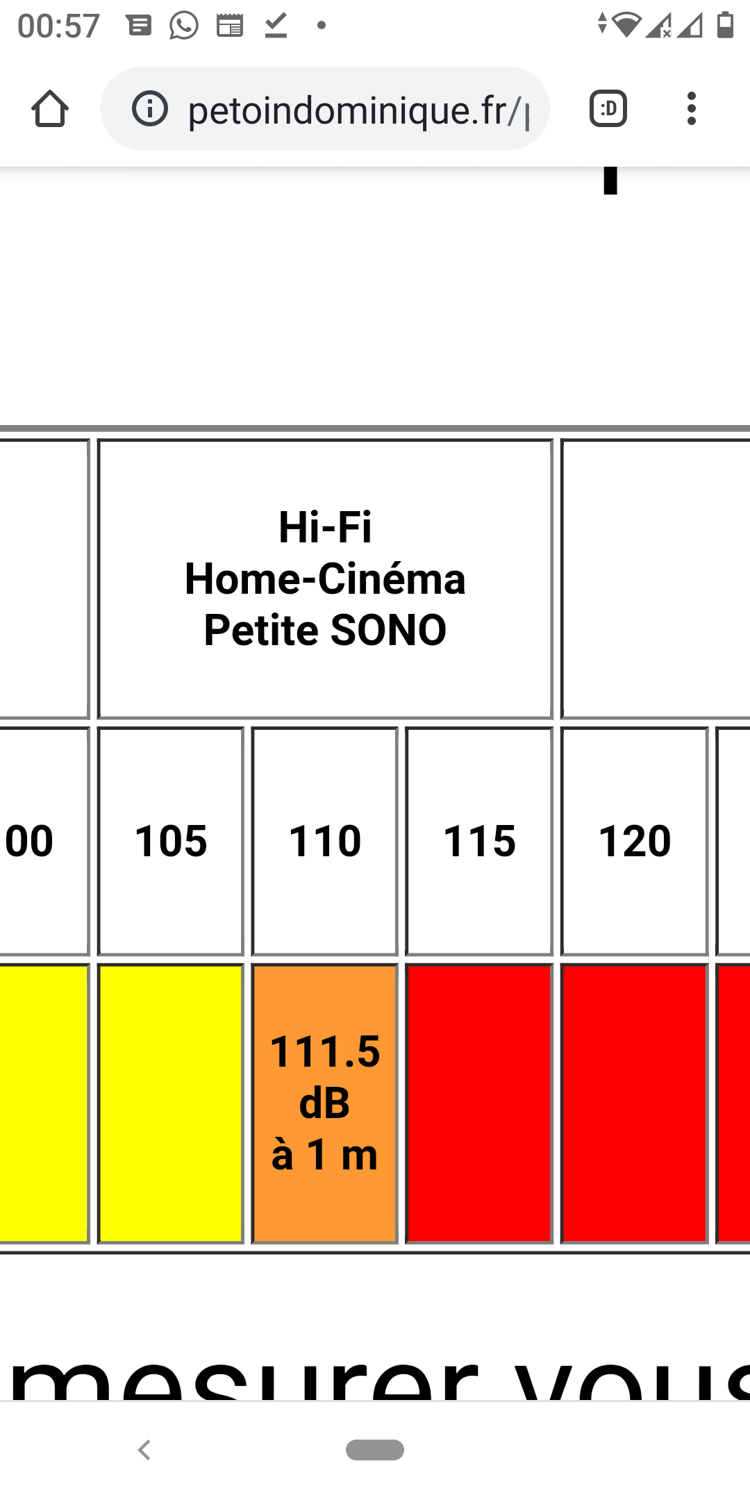

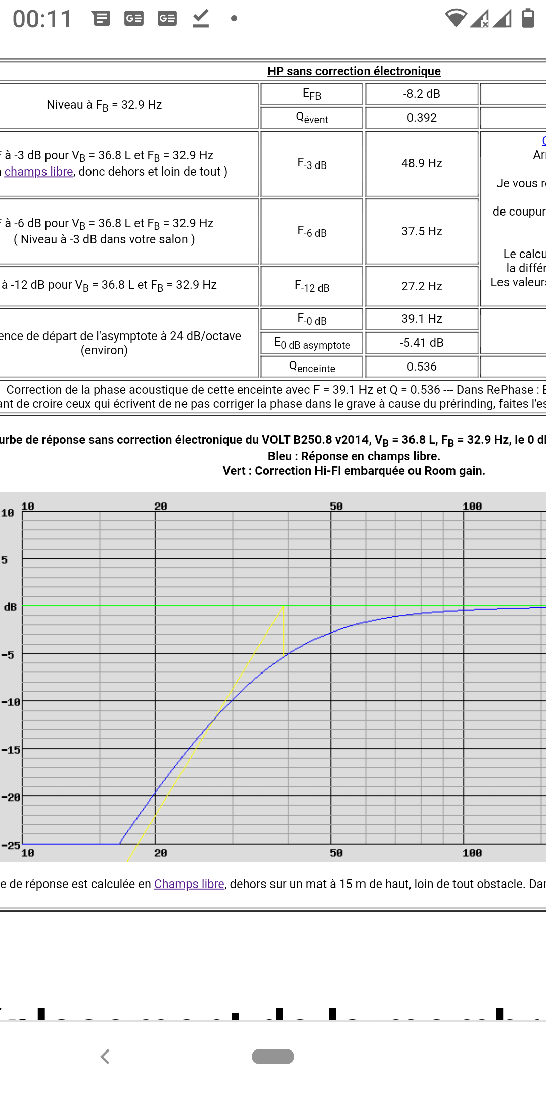

The driver with alignments for the specs below is the more adequate for the power amp you have.
Power rating at 4 Ω 300 W
Power rating at 8 Ω 150 W
Note: you have both 4 and 8 Ω drivers. Needs to check power with excursion @Xmax.
Volt B250.8 is adequated and Morel is nice but needs more power.
Volt B2549 also needs more power from the amp but they model well enough.
