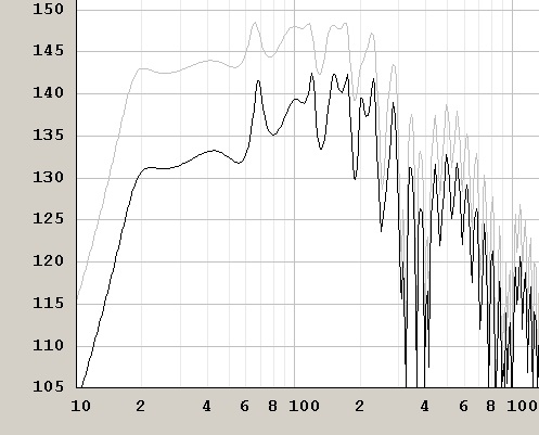

One that gets very loud down to 20Hz if you want to feel everything. Consider the content in tracks that ventures below 40Hz for DnB and dubstep doesn't happen very often, even less below 30Hz, but it does happen. Question is how much do you want to invest for that extra little feeling that only happens occasionally? Things get very expensive (dollars and real estate) to reproduce below 30Hz especially for PA work. For PA build a few of these - http://www.diyaudio.com/forums/subwoofers/189784-gjallerhorn.html and buy a high power amp. For home, several small sealed subs will do. There is no best sub, only best for your application, budget, and space. More data required.

build a couple of the Gjallerhorns that were mentioned, it should have no problem rattling the skin off your bones.

Sub bass is exactly what you won't get with scoops. Scoops are high output around 90-100Hz, good for powerful kick impact. You want either a large horn path sub (some designs suggested above) or a few ported 18", or even 21".
There are huge scoop designs that go low, but the usual JBL single and double 15 scoops fall off like a rock at about 50 Hz, an octave above the real low stuff.a good friend of mine said that scoops give the best sub bass and 4 would just be silly for 100 poeple. Is he right ? There's some pre-made scoops on the net and they dont that much really.
The JBL scoop design also has a "hole" in the upper response (can't remember exactly where, but around 100 hz IIRC) that makes it seem louder down low than it is.
The scoop response was OK for much of last century's reggae and rock, but won't cut it for dubstep.
I have some front loaded dual Lab 12 cabinets for sale (for about the cost of the speakers and shipping) that do well down to 30 Hz, or plans if you want to make them yourself.
They have a small footprint (22.5 x 26.5 x 22.5) and can be stacked four high easy.
For dubstep, you could plug one port and drop the tuning even lower, but with less efficiency.
If you want to get low and loud below 35 Hz, it will take a really big tapped horn like the Gjallerhorn.
If 35 Hz is low enough for you, the Keystone TH does quite well.
A pair of the dual Lab 12 or a Keystone are smaller than a JBL SRX 728, and have similar LF output.

There are many tall single fold TH designs that are almost as simple to build as BR, they just have one extra piece inside compared to a BR.
In some respects, an easier build, as there are no port holes to cut, and no ports to glue in.
TH will require delay to blend optimally with the top cabinets, an extra expense if you don't have DSP.
One thing will be true in every design, the lower the frequency response, the less the output will be for a given volume.
If space is at a premium (usually is in a 100 capacity club) bass reflex will actually put out slightly more SPL for a given volume (liters or cubic feet) than TH, but will require more cones and power.
