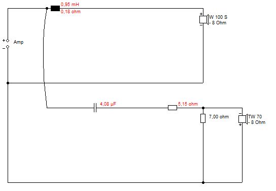

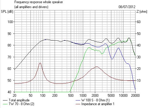

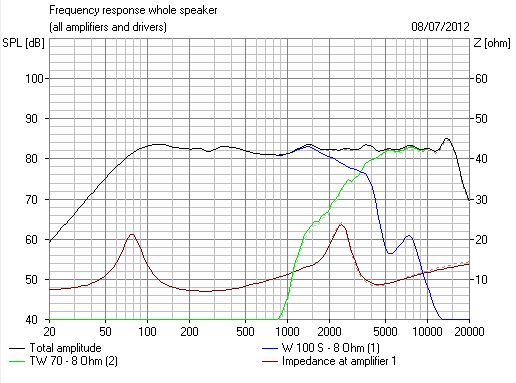

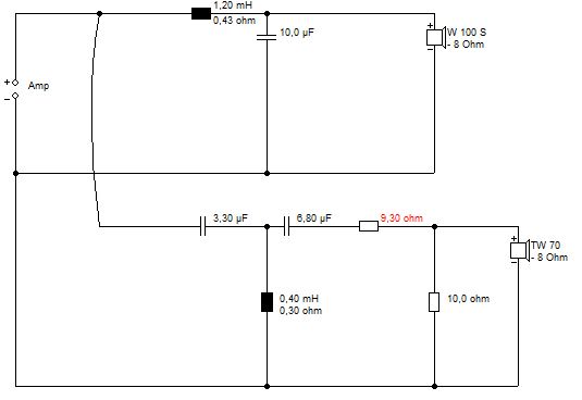

I modelled the Visaton drivers in a 5 Litre closed box to see how they faired with First order, and then with a PROPER JOB 2nd/3rd Order for interest. Hope you enjoyed that. 😎

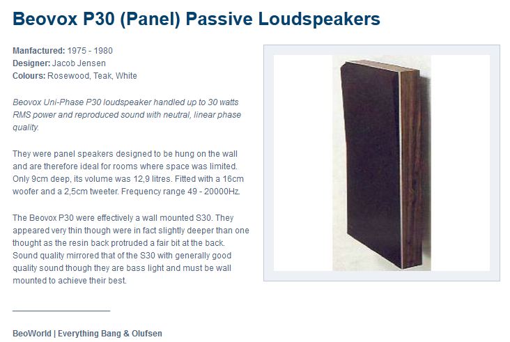

I wanted to evaluate the cone tweeter really. We'll have to see how the TW70 responds to a second order filter I think. The W100S and TW70 are looking good for a Beovox P30 style 5-10L wallmounter (reflex or closed) IMO. They work together very nicely with phase alignment to die for. 😎
