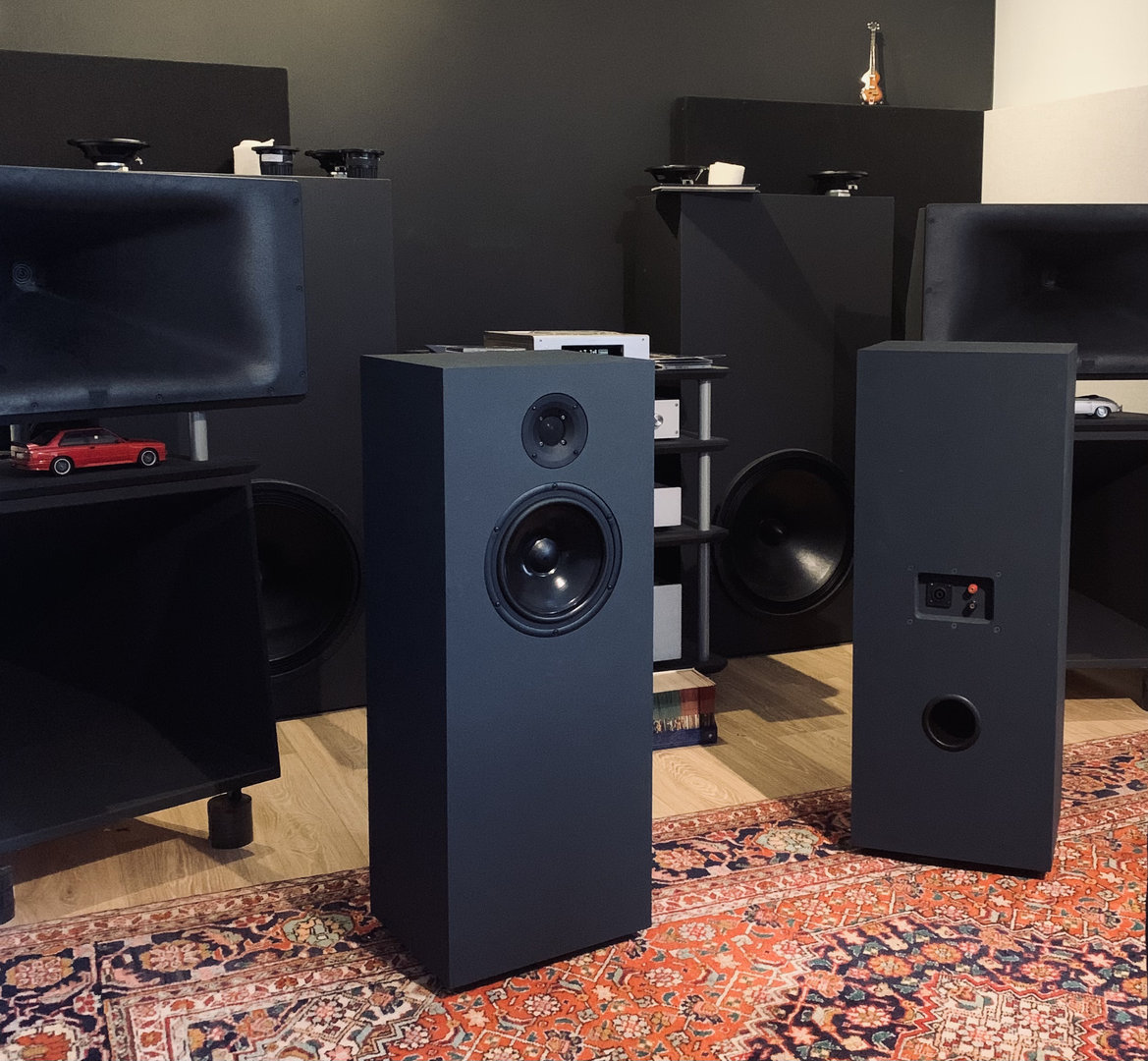

I have made this speakers with Seas DXT tweeter and CA22RNY woofer.
I will use it in my off grid mountain cabin. It has solar power and a huge 12V battery.

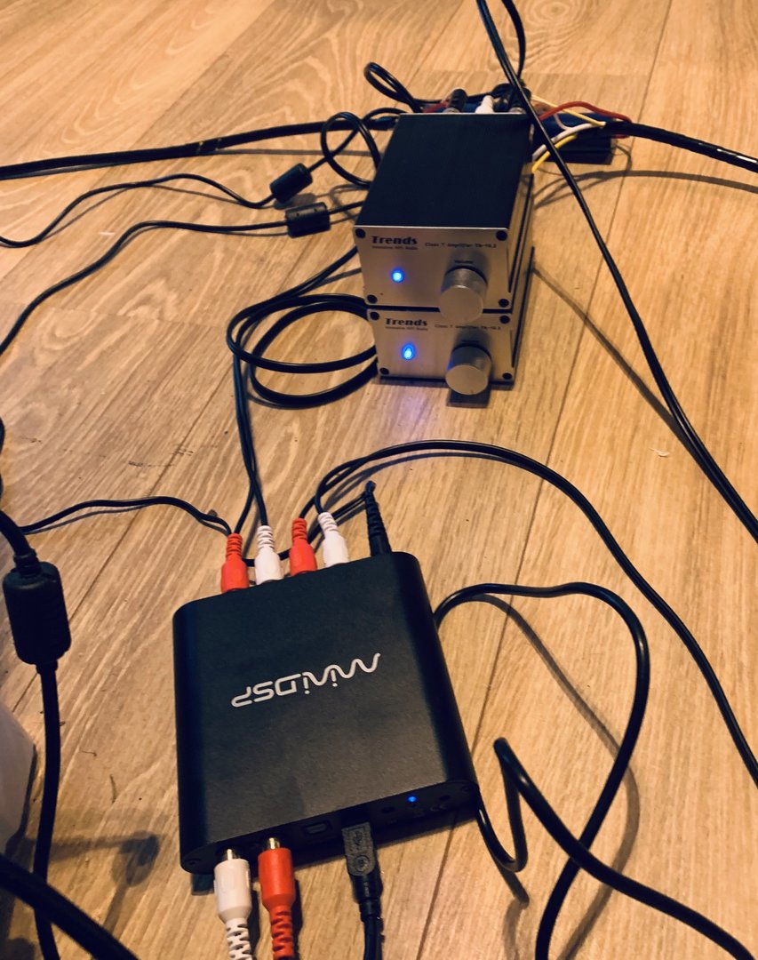

Got a similar setup, minidsp 2x4 and two Aiyima A04 (TPA3251) amps for powering my speakers. Although I´m swapping amps often and will exchange them in the future, they work fine with 24V.
As mentioned the TPA3255 will provide 50W/8Ohm at 30V.
Haven´t calculated the idle dissipation of a TPA3255 but would reckon it´s around 1-2W. Going lower in voltage (if you don´t need the power) will also reduce that dissipation a little if you want to save some more.
24V for a BTL TPA3255 amplifier will yield around 25W/8Ohm.

You should talk about all those nice looking things in the background😉
I see 4 huge horns and 2 subs?
