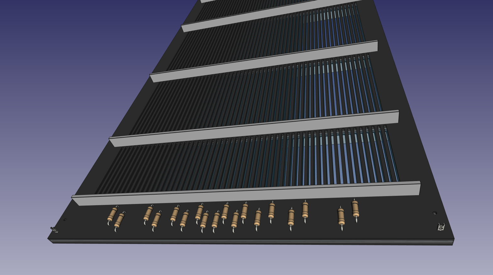

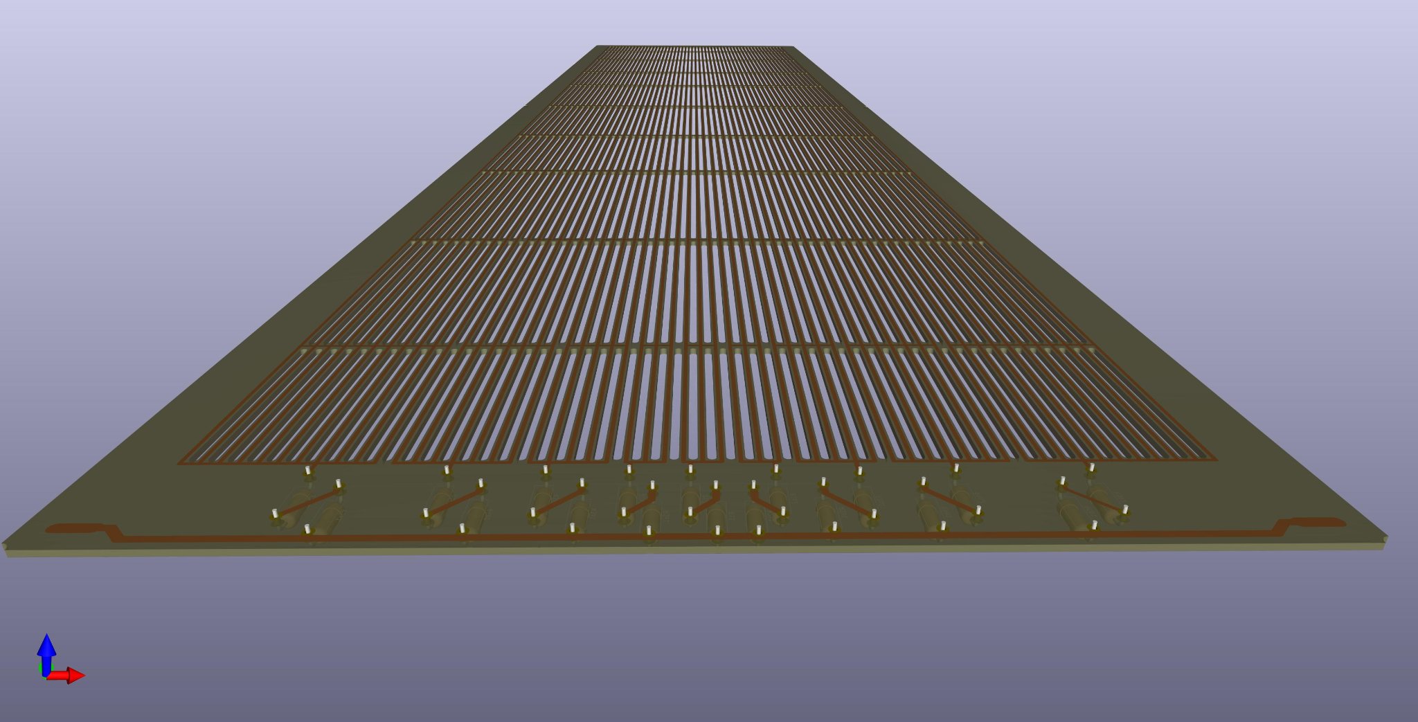

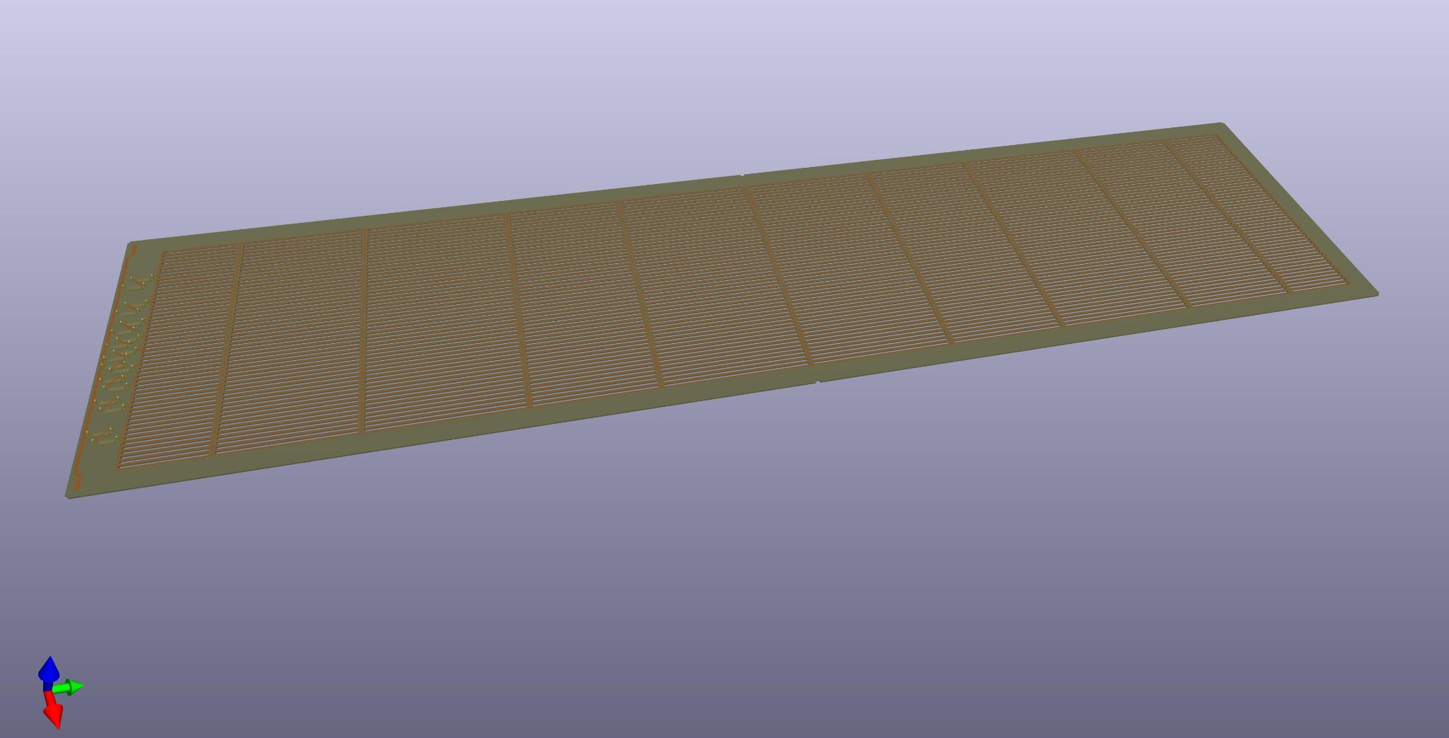

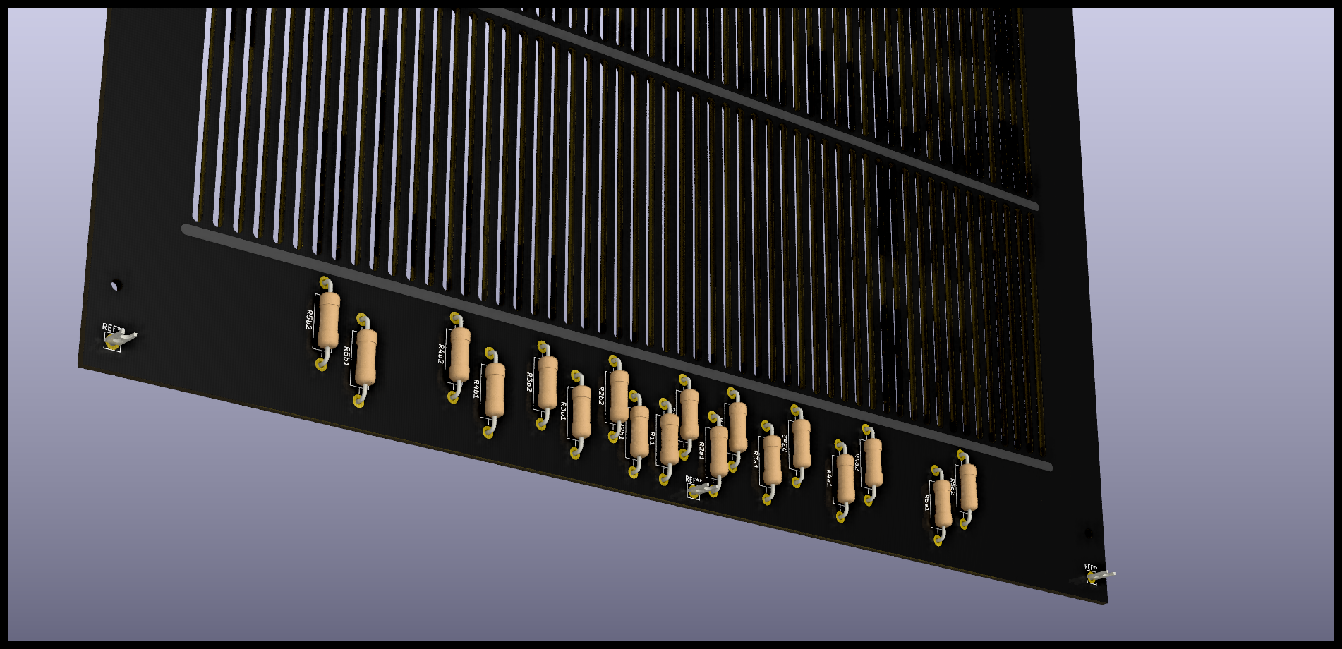

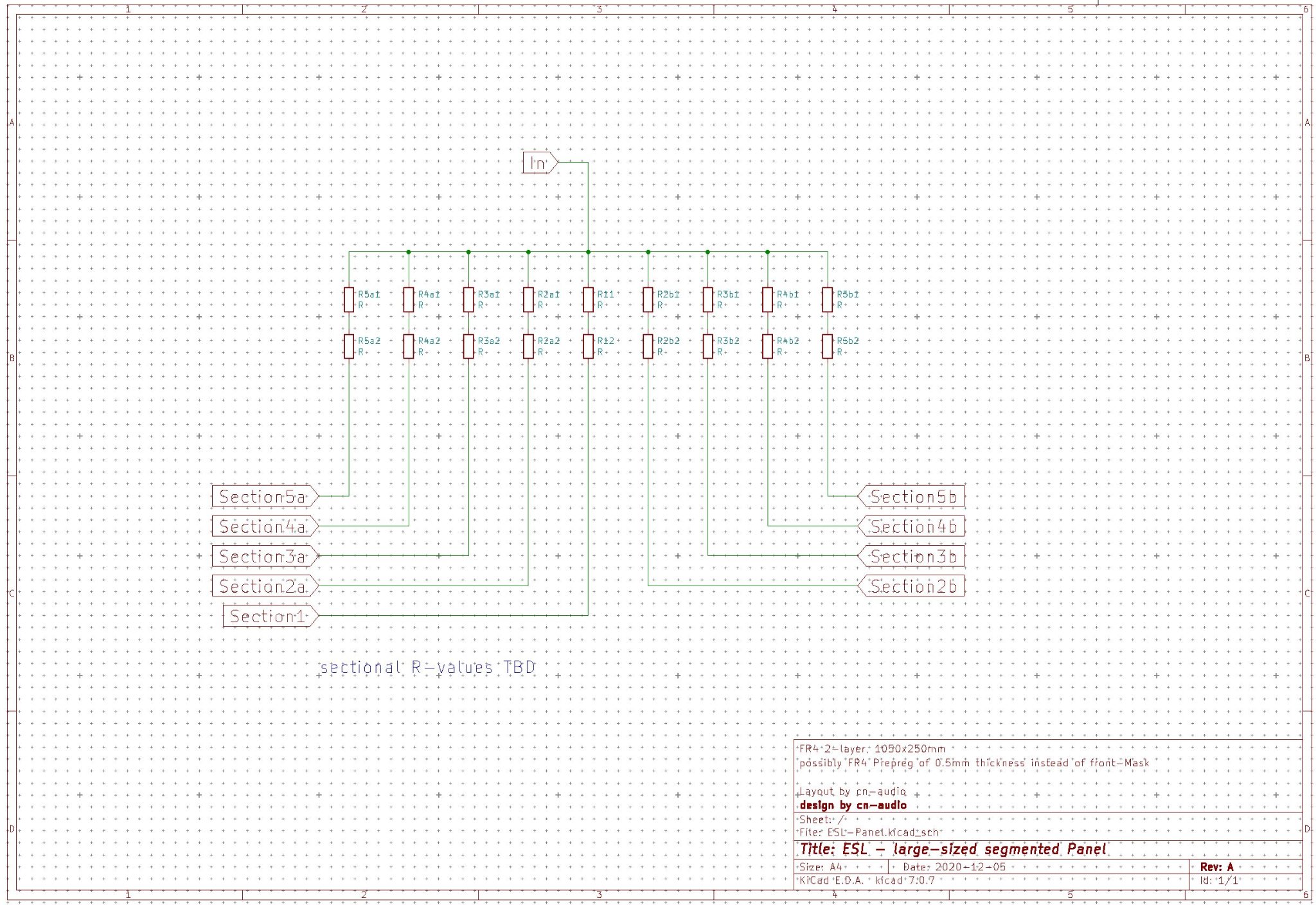

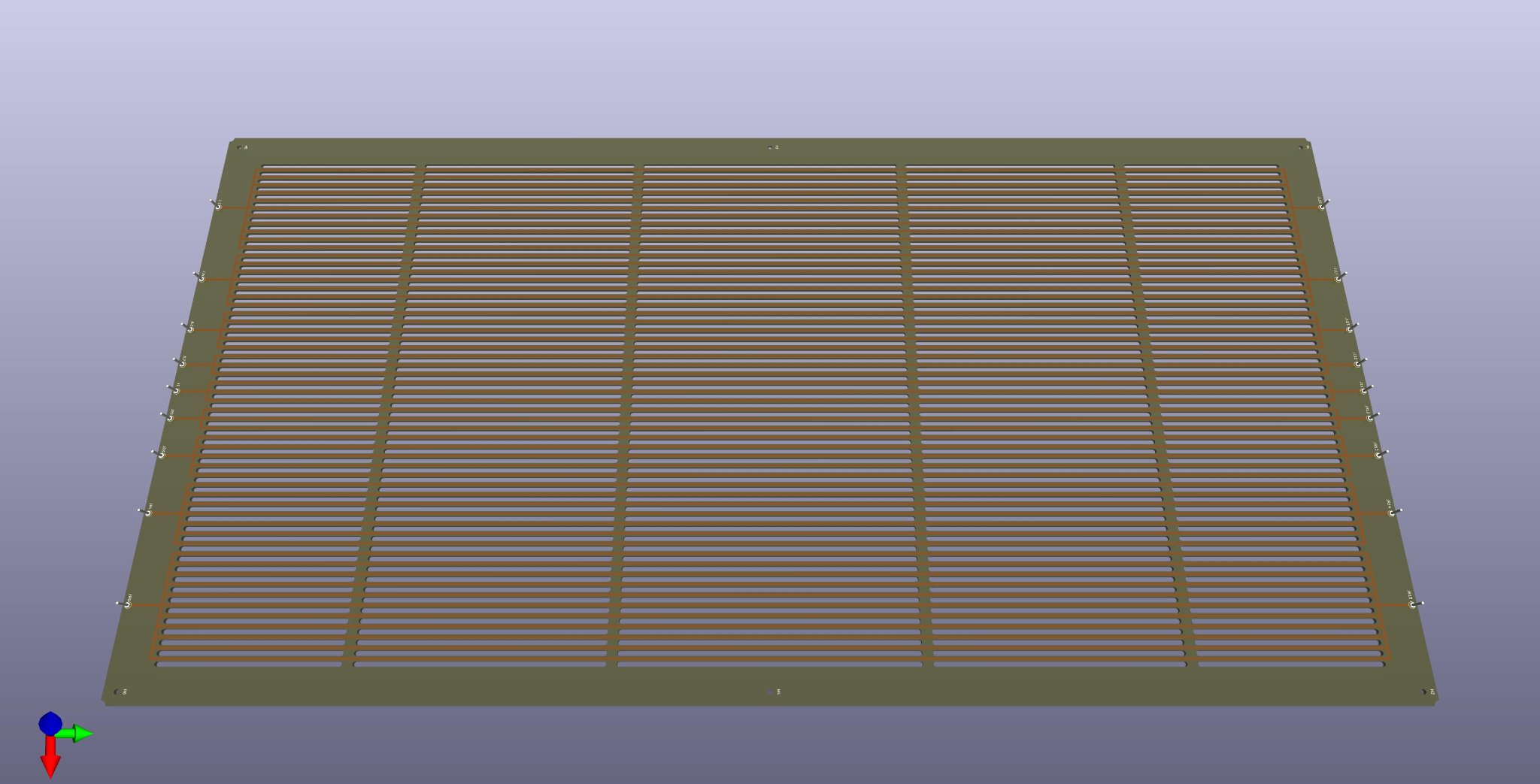

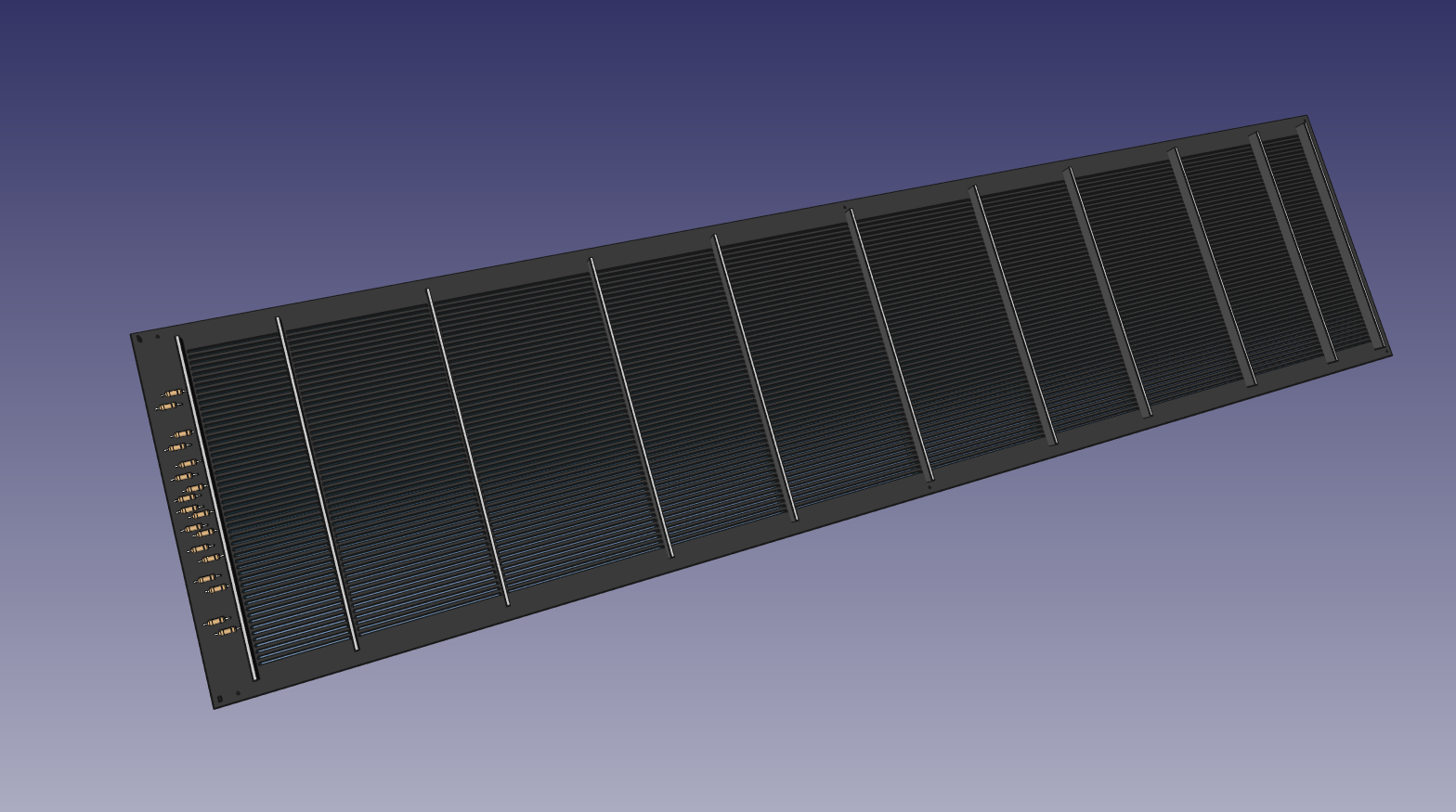

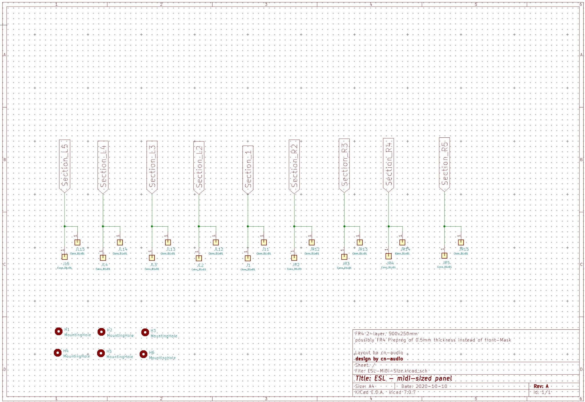

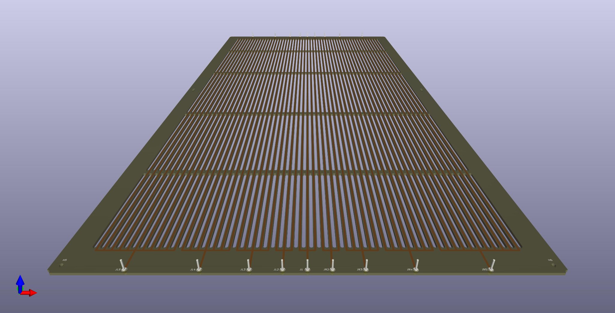

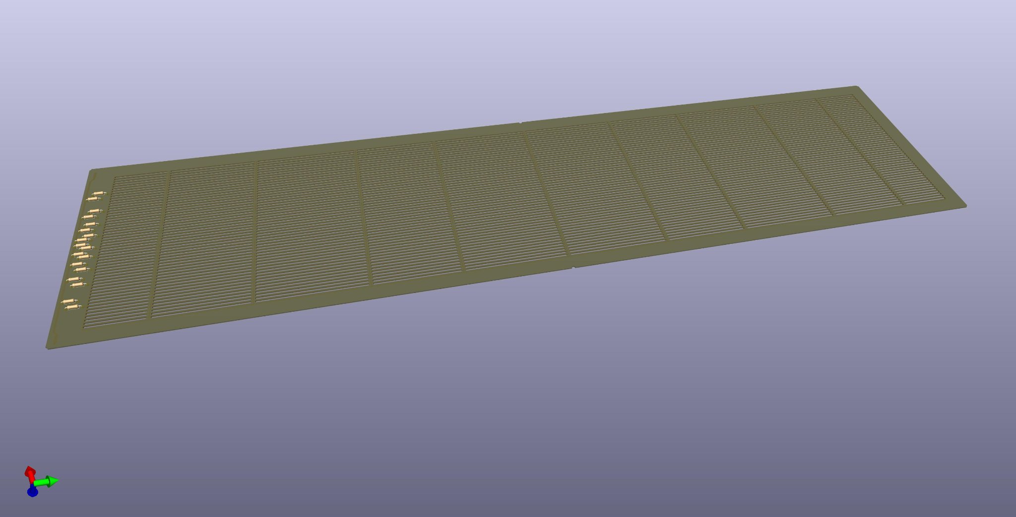

I also layoutet 2 different sized PCB-panels in KICAD.
I preferred slot-style routed openings instead of holes, which would ask for horizontal stiffening means since the stiffness of the PCB needs to be taken care of.
These could be strips of PCB-material also be designed from FR4 base material, glued onto the outer side of the panel.
I could order them at the PCB-manufacturer of choice - JLCPCB seems one of the few that would accept larger than 500mm of length.
Either the inner panel side surface could be of a Masking laquer or of say a 0.5mm thick Prepreg layer to encapsulate the copper traces.
The former allows for cheap test runs using prototype manufacturing, while the latter required standard, or even special manufacturing.
Ordering 20+ pieces will probabely come even between both manufacturing processes.
Segmenting is of course very easy - it be done with resistors mounted to the PCB or on a external dedicated PCB.
Here are some pics of my designs from 2020.
What hindered me up till now to run a test were mostly time issues and the question of will the routing process of the slots maybe destroy the PCBs, because of rattle and vibration ... how would they insure that the PCB stays really fixed flat in the router?

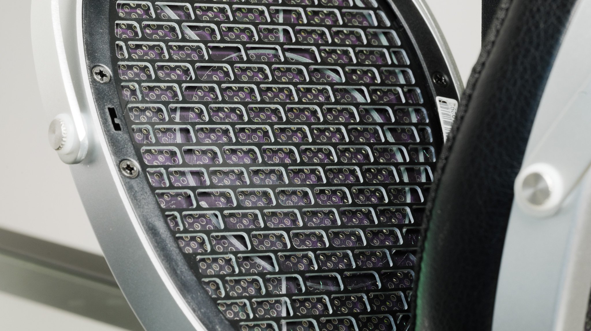

It looks like guys from HiFiMan were able to use something that looks like FR4. It's a picture of the Shangri-La Mini, which is a electrostatic headphone.
i would think they use a vacuum table of some sort. i am sure pcb can work, since many already did ofcourse. so you use kicad as well. did you draw everything up in kicad or imported parts into kidac from another cad program?how would they insure that the PCB stays really fixed flat in the router?

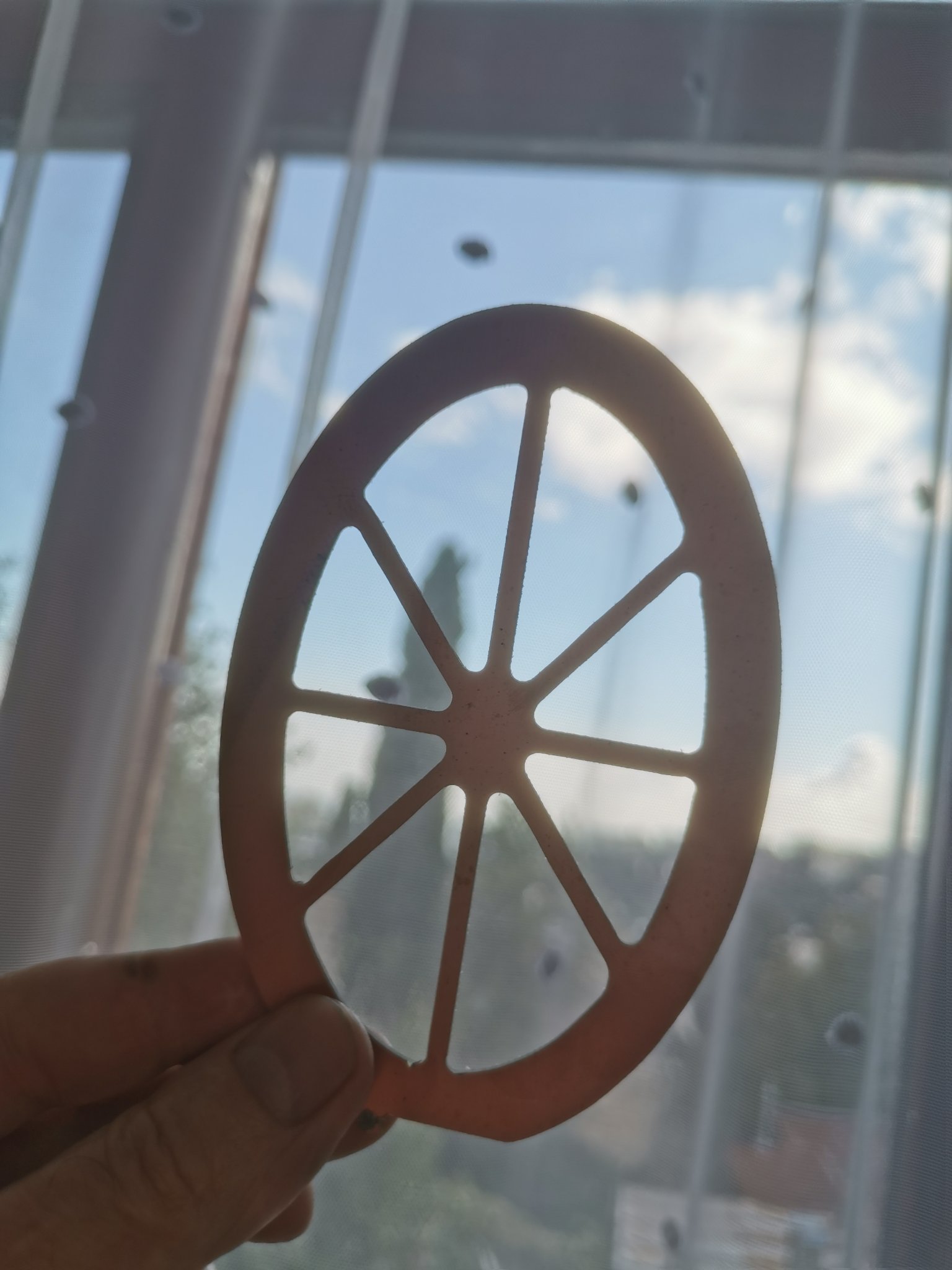

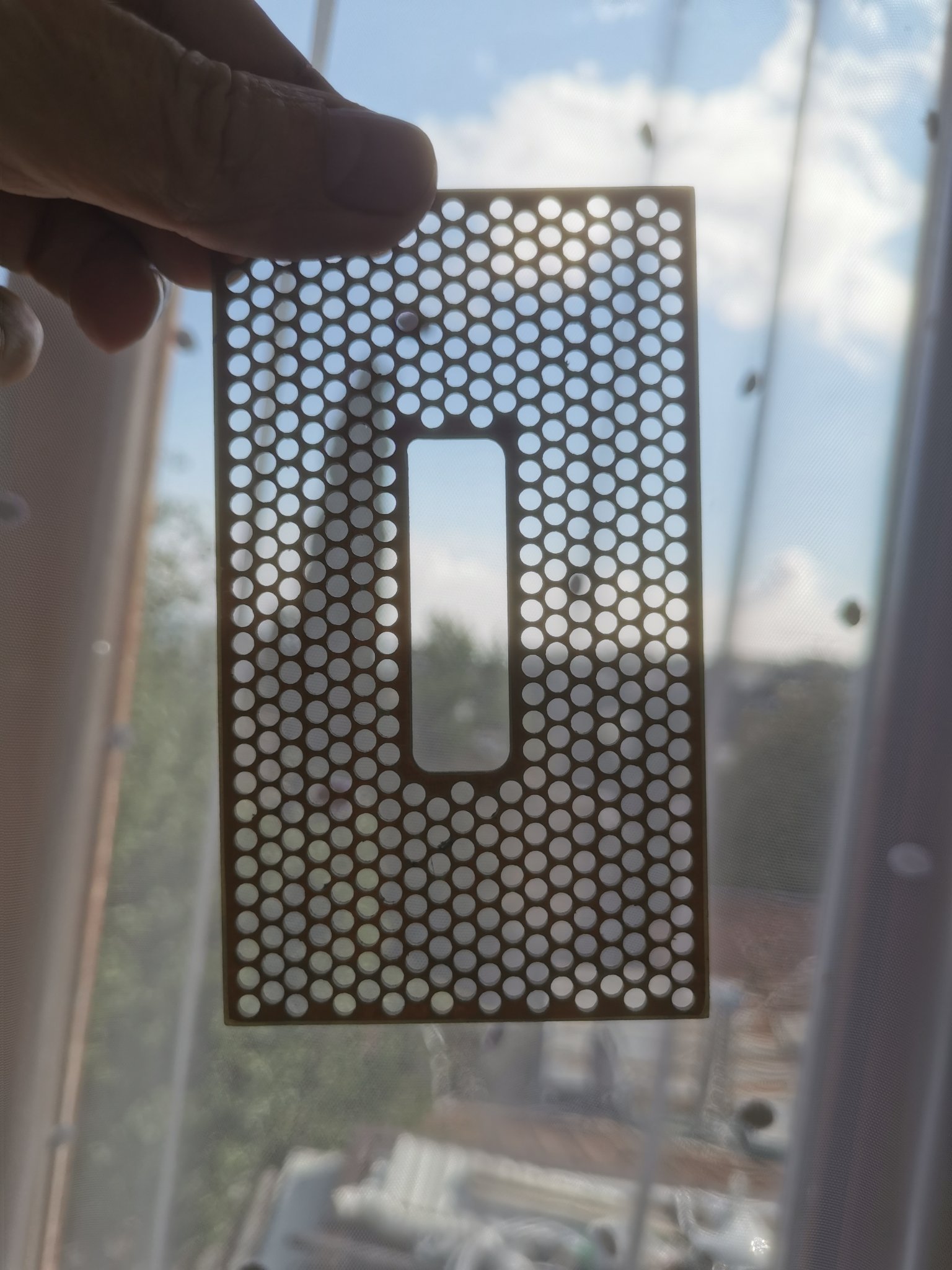

And what are the problems to fix a sheet of any material(?)all the central part of the glue on double-sided tape to the table, and the perimeter of the sheet to attach a special tool than you fix any other parts for processing.
As for the program for projecting, so any will do, I use Artcam.
Perforations can be made by drilling.
Here are similar works, these are parts for electrostatic headphones:
