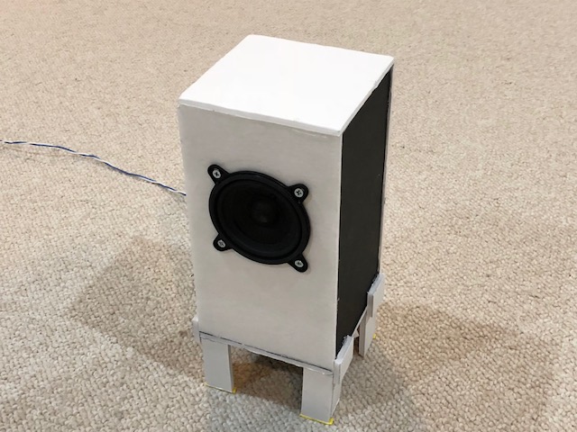

Faital Pro 3FE22 in a 2 liter BR with BSC works well. Very smooth and decent bass. It has a small Vas so allows a smaller cabinet.
Here is a photo of my test (not beautiful by any means but sounds good). speaker 4in x 4in x 8in tall, 1in dia x 2.5in in long vent, 1mH and 5ohm BSC. Vent exits on the bottom.

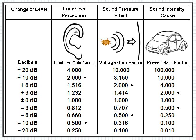

Well Toole is a tool. Users need some sort of reference when evaluating speakers and F3 gives them sort of guide when comparing bass capabilities of speakers. I notice in this thread I have no idea of bass performance of speakers listed. That's why I always list it and why most manufacturers use ±3dB in their specs.
F3 by itself is is useless other than a reference point (1/2 power).
F6 is handy as can give an idea of performance with room loading (1/4 power).
F10 is useless unless you want to equalise the crap out of it (1/10 power).
I know you are going to chime in about loudness vs power so I added a little chart that addresses this.
The numbers:
SB65, F6=62Hz, F10=57Hz
NE95, F6=58Hz, F10=53Hz
SB12, F6=66Hz, F10=58Hz
Even though the last one shows it's bass performance is worse, the larger Sd gives it better real world bass performance by a large margin.

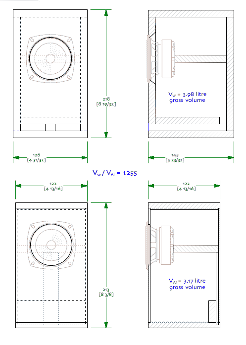

I've looked at MarkAudio Alpair 5.2, could a 6.2 fit also?
I have done 2 and 2.5 litre miniOnken for the A5.2. I haven’t tried anything smaller, i found with other drivers (A6.2m in particular) that the vent in a smaller box becomes so long that when one considers the overall enclosure one gains little gross volume.
The A6.2m in miniOnkens from 2.0 to 3.6 litres. I did at least one that was smaller, but it is mostly a thot experiment and has not been built as far as i know and suffers from the large vent issue mentioned above.
The A6.2p in miniOnken 2.5 to 5 litre. It should be noted that the 2.5 litre enclosure can be fitted with either of teh A6.2 with no changes.
If you want smaller then you need to explore more exotic build material then 12mm (or 9mm) plywood. I have drawn a 2+ litre enclosure for the FF85wk (choosen because it does not need a rebated baffle) that is built using a recycled aluminum RAID enclosure that has 3mm walls. Removing unused solid material volume aids significantly in reducing gross enclosure size.
