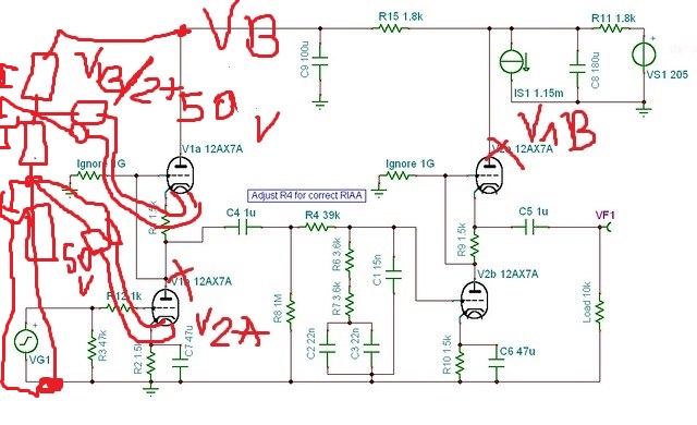

I suspect it's a different problem:
The stages should use the valves differently so that you can have floating filaments that you can independently elevate with a dc bias .for 12ax7 you need about 50vdc bias over the cathode voltage to cancel the hum completely.
I never need any shielding to get no audible hum at max volume with no cartridge connected!

I'll try elevating the heater supplies although I am not sure how DC heater supplies effect mains EMI pickup. Easy to float the heater supply, so not a problem to try it.

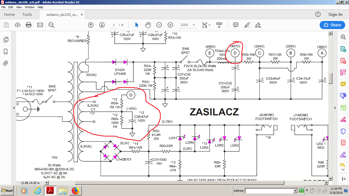

This is an usual misconception, that the dc supply of the heater is getting you any low noise unless it is filtered and regulated down to microvolts level which is kinda hard to be honest.Most of the noise come from the cathode-filament induced hum through capacitive coupling and the ripple current can be as low as picoamps (depending on the gm and gain of that stage/tube) and still produce significant noise.The lower the noise of a tube, the higher capacitance between cathode and filament and subsequently the lower Vkf Max breakdown unfortunately.
By elevating the filament over the cathode you fight the intrinsic capacitive leakage between them and you find that you don't even need dc supply if you lift both taps of the filament to 30...50v.You can do it to the filament in both ac or dc .In ac its even simpler if you have mid tap like soldano amp does , but you can do it with no mid tap, just two resistors from the +50v tap to both ends of the filament.

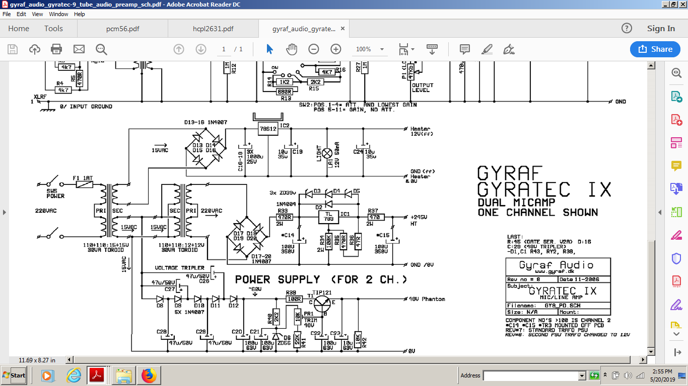

Look at Soldano Slo 100 schematic which is one of the highest gain amp for guitar pick-up where the hum is even more problematic than in normal phono preamps.Actually if you study some of the best guitar amps or preamps wiring you can easily do noiseless phono preamps with no shielding at all:
SOLDANO SLO100 SCH Service Manual download, schematics, eeprom, repair info for electronics experts
Read this post and the whole article if you want as they talk about all the techniques used to kill hum:
Any advantage using DC for filament?
I used to clone Mesa boogie dual rectifier amps and do the dc filtering trick they do, until i found that the original Soldano design that they used had no such thing and had even better hum removal than the Mesa...
Study both, Soldano and Dual Rectifier wiring and grounding techniques and you know almost everything it is to know to get low noise valve preamps.
