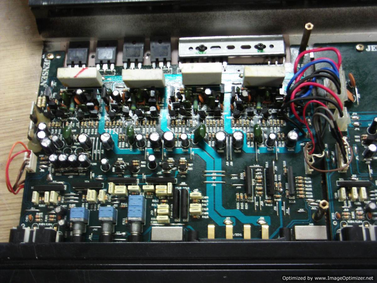

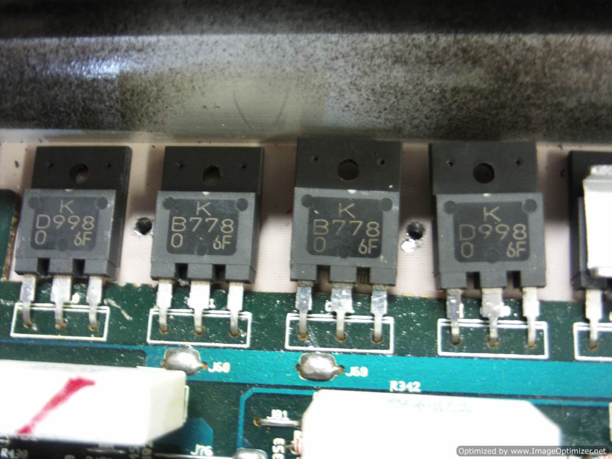

I was hoping that someone could tell me what would be the best transistor(mosfet) for my amplifier. It's an car amp and ia has 200W on 4 speakers. A friend gave it to me becouse he broke it. I've found the problem (a trasistor was blown). and i want to know what would be the best replacement or even better how much stronger could I make it. 😀
thanks

The transistors on your first picture are Bipolars (not MOSFETs) and they are fakes (no name, Chinese crap ... so this is the reason of failure).
You can't really use a different transistor than the current type, otherwise the bias current would be different and it doesn't seem to be adjustable.
One powerful alternative could be e.g. 2STA2120 and 2STC5948, but I doubt that replacing the bad transistors will really help, because certainly other devices are damaged.

I already know that 😀 ... I want to know what would be an replacement and if I could make it stronger...

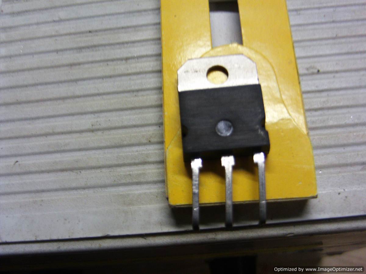

and their all the same. Only two were replaced I think becouse there were marks on the pcb. but they their names scraped off.

nitroboy:
I'm confused, are these 2SB and 2SD types the originals or not ? They aren't isn't it !!

You cannot make it stronger because the extra heat is a problem and also the power supply is not big enough.
Try to find the correct parts or similar good quality ones.
