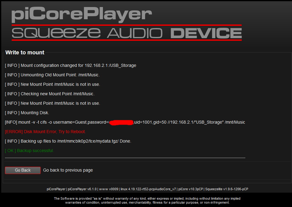

TNT - I must be using the wrong version (rtcore) of picoreplayer, as I dont see the word "Advanced" anywhere in the Main Page GUI...
MSHAVS - here's what I get using the "Setup Network Disk Mount". Seems no matter how I juggle "Music", "readyshare" and "USB_Storage" in the fields available. I got rid of the "vers=1.0". I've been ticking the enable box and using the Set Net Mount button.
The full Windows style path to my flac music collection would be readyshare/USB_Storage/Music. There's other directories / crap on the share...
I did enable the additional filesystems some time ago, prior to my initial post. I'm listening to the NPR news radio via LMS as I type, so I know the wireless connection to the router is conveying a signal to the system. LMS says Music folder is empty.
Thanks for your help!
I did the in-place update successfully and got rid of the realtime kernal...
With a casual look about the net for linux connection to this style router, I see slightly different structured mount strings than -
mount -v -t cifs -o username=guest,uid=1001,gid=50 //192.168.2.1/"USB_Storage" /mnt/Music
Such as;
mount -t cifs //192.168.10.1/projects /c/projects -o uid=....
and .... //192.168.1.1/USB_Storage/ /media/public/
If the quotes about USB_Storage that picoreplayer puts in are hard coded and that's what's the matter in my personal instance with this Netgear router, there's little I can do but fold 'em - unless there's a way to go through editing / entering via a SSH terminal or something.
I suppose it must've worked with some other cifs server during development and perhaps was programmed as a user convenience. Rather than saying "dont forget the "" about your share name - needed in many cases"

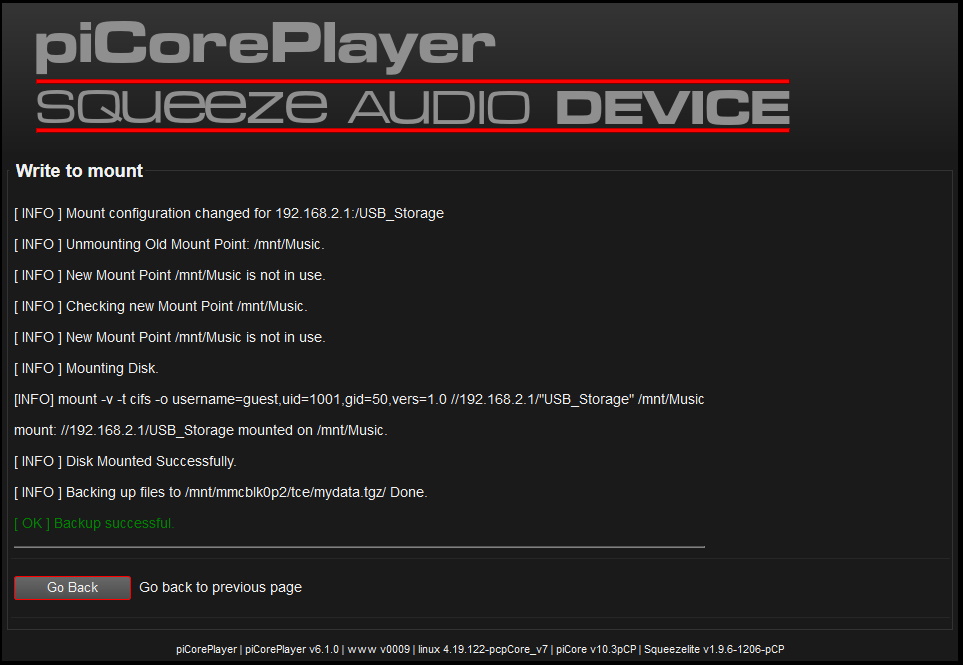

I put the "vers=1.0" back and success, apparently; mount -v -t cifs -o username=guest,uid=1001,gid=50,vers=1.0 //192.168.2.1/"USB_Storage" /mnt/Music
Music from the USB_Storage drive is playing!

GREAT !!! You solved it yourself 😀I put the "vers=1.0" back and success, apparently; mount -v -t cifs -o username=guest,uid=1001,gid=50,vers=1.0 //192.168.2.1/"USB_Storage" /mnt/Music
I didn't understand that your storage is attached to your router (and therefore that you need version 1). I hope it's doing what you want. About the Advanced Tab: when you go to the end of the page you'll find 4 Tabs: Basic / Normal / Advanced / Beta. The levels give you more possibilities to customize your pCP-configuration.
