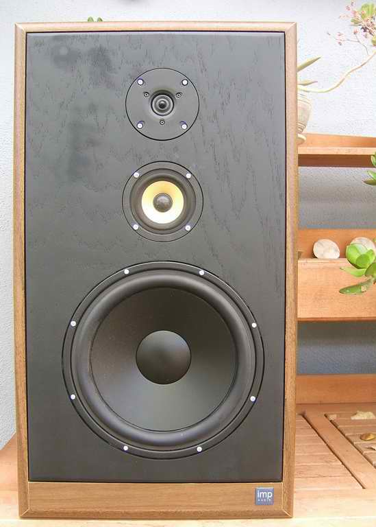

I got a pair of AR3b's for $25. Foam surrounds were rotted out.
I sawzall'ed out the baffle and reloaded with Vifa/Morel & DSP XO tri-amp - sweet!
I couldn't build a cabinet like that for $12.50! That's a deal!!!!!
