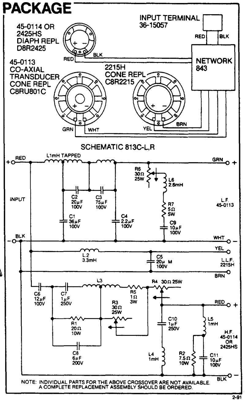

...how far might my 2 GPA 416-8C get me in place of the 3 2235H?
I was hoping to KISS with the 604-8A XO's (maybe make copies with upgraded parts), but if it's suitable to fake it (get 16ohm phragm, then 416 and 604 LF in series to make 16) ...the system/amp might like the higher impedances. I tend to chase my tail playing with XO's so disinclined towards anything terribly complex. (this ultimately why the 828 system came down in favor of playing with the 604s)

WRT peak SPL/'slam', not very since it has 2x + Xmax, power handling + a third driver. That said, dual 515B/channel has more than enough in the mid-bass and bass, corner loaded, and don't recall anyone walking away muttering anything about lack of 'slam'/'grunt'/'thump',/'rumble', etc., so dual 416s will come close plus have more bottom end.
"(get 16ohm phragm, then 416 and 604 LF in series to make 16)" ???

The XO comment explained: I was proposing that if I match the HF and LF impedances by wiring the LF in series (16 ohm), and replacing the HF 8 ohm diaphram with a 16 ohm, that the XO points for the N604-8A would remain the same (as with the existing factory 8/8 arrangement). Perhaps that simplistic approach only applies to low order XO's (or specific types of low order XO's). I realize it would also not account for disparity presented by the sealed vs MLTL sections.
