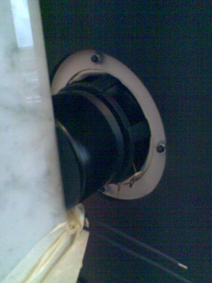

The technique that I used to good effect was to use a product called "no more nails" to stiffen the basket.
No more nails is a product designed to attach dado rails, coving etc to walls. it is a very strong adhesive also designed to fill gaps between the objects it is fixxing.
In the diagram (not the best I know) you can see the basket of a typical steel basket. The areas in red indicate the space that has been filled with the material.
Using a spatula I apply it to the baskets in the gap between the magnet and the pressed steel frame. Others have used duct seal in the same places.
The no more nails when dry goes hard, so is effectively stiffening the frame. As I see it this is different to the duct seel which is acting as a dampener. No more nails on the other hand is not a reversible modification. Not that I expect that would be a problem.
I intend to go back to the speakers to apply dampening later. I had planned to use dynamat to damp the legs, however its costly stuff. Another thought was to glue bitumen backed carpet tile material instead of dynamat.
With just the no more nails, I got a worthwhile improvement in the sound of the speakers. Clarity in the lower and mid ranges was definately better. The sound of the speakers as a whole was more transparent after the mod.
I had the speakers apart several weeks later, what I had found was that the no more nails had contracted. I had filled out the gap to be flush to the magnet, but now it no longer fills the whole gap. I will apply another application of NMN or alternatively pad it out if I can find duct seal.
Well worth doing for any pressed metal speaker. If anyone reading has not tried this cheap and easy mod yet you are probably not getting as much out your speakers as you could.
