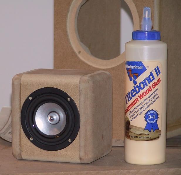

I am always using standard wood glue rated at 2500 lbs. No screw. Clamp all night and that's all.
http://quicksitebuilder.cnet.com/wrnch2/diyspeakerbuilding/id2.html
Use YELLOW WOOD GLUE.
$2.50 per small bottle.And after even 2 hrs you will not get 2 pieces of MDF apart.
Check out my quick pics of a dato assembly.
Al

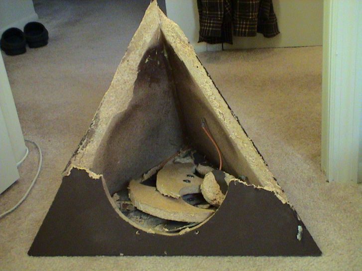

I don't think your box is going to fall apart no matter what you use. But I like to use "liquid nails" that polyurathane thick stuff because it fills in gaps if you have any. I've never tried to take 2 pieces apart that are glued with that stuff, but I have tried to take pieces apart glued with regular wod glue and they never come apart where the glue is. They always take a piece of MDF with them. So both are very strong I'm sure. And both are very hard to sand. And the "liquid nails" stuff I used dries hard.
I think I have tried just about every glue out there at one time or another. So far, the best is just standard yellow wood glue like the type in Brian's picture. It lasts in your bottle longer, is very strong and cleans up with water easily. The poly glues won't last in the bottle well and if you live in a humid area the "swelling" or foaming that occurs from its reaction to water (it's catalyst) actually weakens the joint. You can test this by dampening the joint of two pieces of wood (about bookshelf speaker size), clamp it, and let it set overnight you should see quite a bit of hardened foam at the joint. You should be able to give the pieces a good wack and they will separate at the glue joint. If you try the same test with the yellow glue the wood will break away, not the glue. Several woodworking magazines have tried this and similar tests with like results. The "Liquid Nails" construction adhesive is very strong but doesn't flow well, is much more difficult to clean up, more expensive and doesn't last worth a damn in caulking tubes, even if the tube is new and unopened. The best way to guarantee strong joints is to make sure you have a good fit in your joints. Nice straight and square edges are stronger than swelling glue filled gaps, not to mention better looking. If you decide to build some larger speakers, use biscuits or a locking joint (Tongue and groove, dado, finger joint, etc)to get the most strength from your joints.

That is not MDF, it is definatly chipboard or particle board.
MDF is hard to break,and when it does it breaks cleanly.What I saw was a load of woodchips,sawdust and mess,definatly broken chipboard or partial board.
Anyway I use MDF or plywood, never particle board or chipboard[because this stuff is absolute crap,and flakes off when cutting,and doesn't hold it's shape for years like MDF or plywood.]

It might be particle board, but it's definitely not chipboard. It might look like it now that it has been thoroughly destroyed, but this came after hours of trying to make the pieces separate. Honestly, this is the result of 6 hours of painstaking work.
The picture reflects that sort of destruction I wreaked on it and board that is cut at a sharp angle. In addition, the wood shown had already been recycled from some other project.
At any rate, I thought it was MDF. Maybe it's not. Whatever it is is a tragedy.
