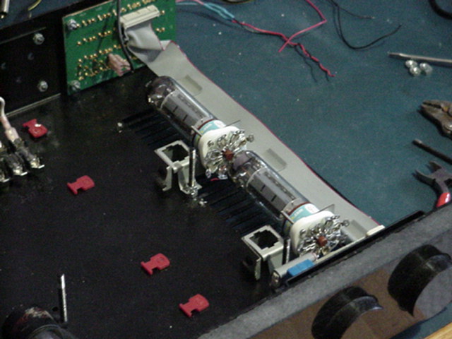

This is an ideal place to use perfed aluminum, if you can find someone to bend it. The usual difficulty with side-mounting is ventilation, and perfed material can be a useful aid.
Please tell me that the heater wiring isn't that red/black twisted pair that goes straight through the audio wiring.
EC8010 said:Please tell me that the heater wiring isn't that red/black twisted pair that goes straight through the audio wiring.
If I count pins correctly, they are going to 4 and 5, so...
Many tubes do not like to be mounted sideways. Vertical up or vertical down is fine.

It is true that some tubes do not like being mounted sideways. The small signal types shown in the picture are fine. In general most indirectly heated tubes can be mounted in any position. Directly heated tubes like the 300B, 2A3, and 45, do not like this. Operating these tubes on their side will cause the filament to sag when it gets hot, shortening its life. In extreme cases it can touch the grid leading to all sorts of unplesant things. Mercury vapor rectifiers don't like being on their side either. The data sheet for each individual tube type (found in a tube manual, or on the net) will usually explain the allowable mounting positions.
eeehh, yes it is. And thats probably why i get a strange high-pitch pulsing sound when i turn it on.
But how the h**l can one keep the wires away when you have to get the tubes heated?
Heater wiring goes in first and is best done with solid core wire (stays in place better). It doesn't need to be very thick for small-signal valves, so it's easy to push it into the corners of the chassis. It should never float in the open air.
However, I doubt that your "strange high-pitch pulsing sound" is due to heater wiring. It's more likely to be due to a wire (or component) from the output going near to an input wire.
ah, it is my first try as i said so some mistakes are bound to happen.
i might just as well desolder and remake the layout. thanks for the help and sorry for hi-jacking the thread.
