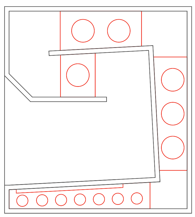

I want to put an amp and boost converter inside my Tham 12 - any suggestions on the best (or least bad) place to put it?
Should I worry about air turbulence caused by the physical intrusion of the electronics into the horn path? I'm thinking about putting it on the back panel, to one side of the brace with three holes shown in red on the right of the drawing attached. It's one of the new 3e TPA3255 amp and Wondom Boost converter.
Any better suggestions? What are the chances of this causing audible noise / impacting the sound of the speaker? Thanks!

It depends on how much space your amp will need in the hornpath.
I had the same idea with a Tham 15 but did not realize it in the end , as my amp installed in the backpanel would have reduced the hornpath by 50%.
That means that if you want to use a plate amp you need to add another spacing panel in the back of the cabinet, so to not disturb the horn path?
