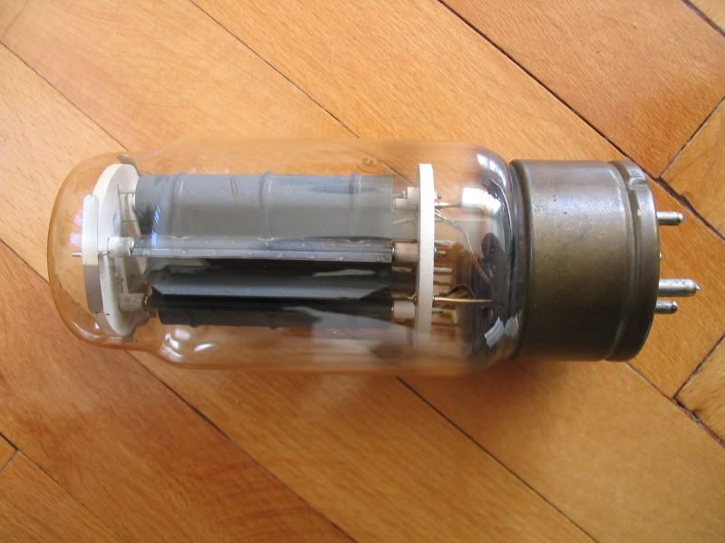

Please, what is the best GM70 tube version suited for a SET parallel amp??
I know three versions of this tube:
Copper plate(Ulyanovsk),
Graphite plate(Ulyanovsk)
Metal Plate(Photon Uzbekistan plant).
Anyone know what is the output plate impedance of this tube??
The PDF specs files I have see do not show this detail.
Thanks for any info, Gustavo

Many people will tell you the copper plate version is best (probably because it is the most scarce 😉 )
Technically the graphite plate should be superior, it can radiate heat more efficiently and can stand higher temperatures.
My suggestion would be (and some people will disagree with this), to use the cheaper graphite types and spend the saved money on better output transformers.
You can calculate rp as rp=mu/transconductance. However, for the GM70, the parameters vary a lot with B+. Most schematics I have seen use quite high load impedances, such as 10 kohms, for high B+ like 1000--1200V.

To my point of view copper plate is better sounding, but graphite plate version is more powerfull.
I am building a 12HL7/GM70 and have the graphite tubes for now. I have friends that have the copper plate version. Once the amp is done and broke in nice, I will roll the coppers in it and see how they sound. Do you have a scheem yet? What B+ are you running? two stage or three stage?

Hi Gustavo,
the values for mu and transconductance in the datasheet have such a high tolerance on them, that it's hard to calculate the exact rp. The best way would be to determine it graphically from the curves.
Take a look at the Ia/Ua curves in this datasheet: http://frank.pocnet.net/sheets/084/g/GM70.pdf
You can graphically determine rp by measuring the slope of the curve, in the working point (bias point) of your tube. In most cases you will find something around 2000 ohms.
With a triode, you should always use a load impedance somewhere between 2 to 5 times the rp. This is why you typically see GM70 with output transformers with 6 ... 10 kohms primaries.
As DJN says, if you use low load impedances, such as 2x rp, you get high power but high distortion. If you use a load impedance of, say, 5x rp, you get lower power but much less distortion. It is up to you, to decide which you want 🙂
I read in your first post that you want to use two tubes in parallel. If you do that, you make one big virtual tube with the same mu but half the rp of a single tube. So your OPT primary impedance must be halved, too. And you need to take precautions to insure that both tubes will share the load 50/50.
