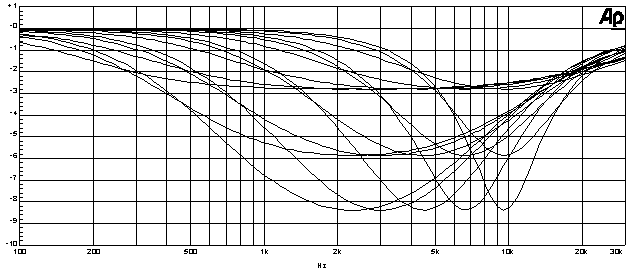

I have (or have had) all of these drivers in systems with a woofer, so
I will share my conclusions about what works most often:
Acoustic crossover point (not necessarily electronic point) at about 150 Hz,
and this takes lots of adjustability, with as many as 4 poles.
Low Q equalization centered anywhere from 2 KHz to 10 KHz and variable
from -2 to -6 dB. Here is an example curve set:

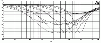

Acoustic crossover point (not necessarily electronic point) at about 150 Hz, and this takes lots of adjustability, with as many as 4 poles.
I doubt that the natural fall-off for the enclosure will end up being 150Hz and as I said I would want to crossover at almost an octave above the box resonance point. I was probably going to leave bi-wired and bi-amped to allow linkwitz riley crossover use.
I don't know what you mean by adjustability with 4 poles, thought that an acoustic cross-over is the natural fall-off of the enclosure.

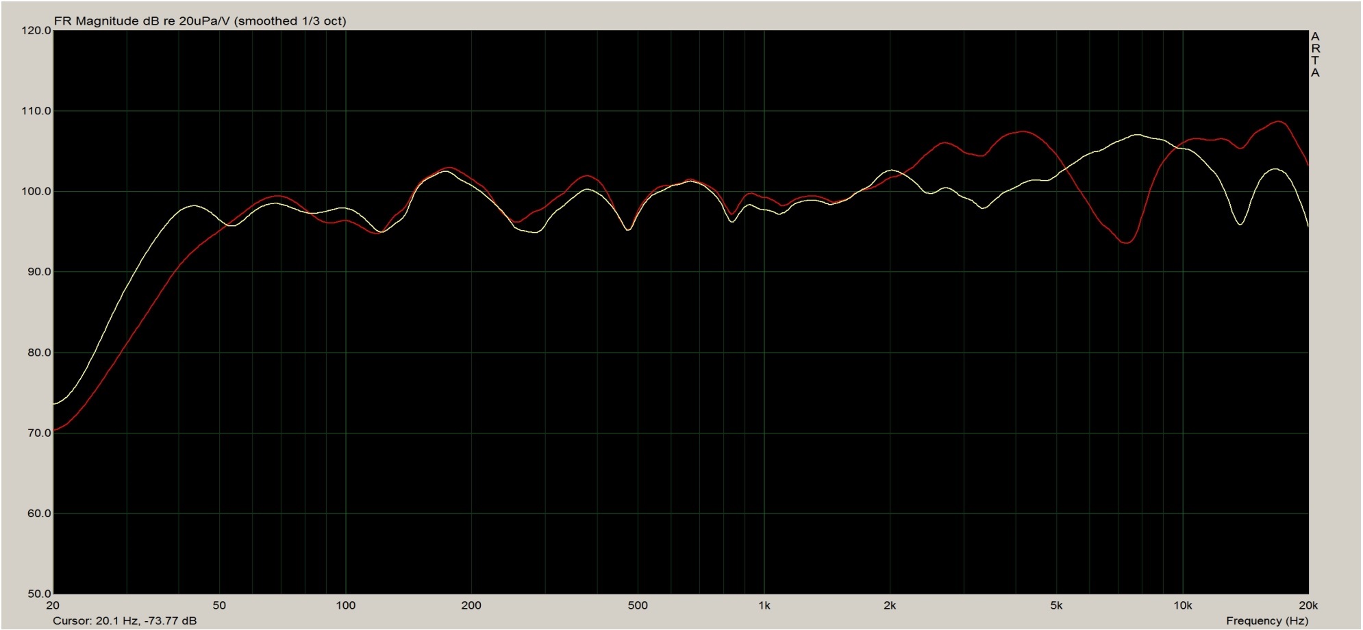

The SAL drivers are very cool looking but they don't share response graphs as usual with the full range companies. I like to know where I am roughly at least.
I am leaning towards the Voxativ as they are offering me a pair at a good price and they are more attractive than AER. here is a frequency response for the driver in 2 different enclosures. (I love how different the response is at the high freq. for both units, exactly why freq responses are only rough guides for us to use
yellow is Voxativ Pi, red is Zeth
Dan
