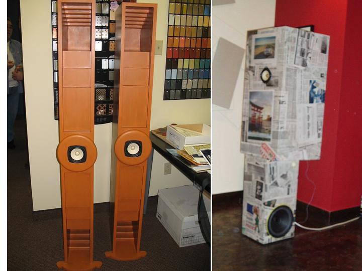

Here's an idea I've been wanting to try for a while: mirror the factory design, so you end up with a double horn a la Terry Cain's BEN. I seem to remember Terry mentioning that it's possible to do with the factory 166 design, providing you keep the compression chamber the same volume as the original, or slightly larger. As the drivers are so cheap, and we have proper distribution in the UK at last through Wilmslow audio, I'm running out of reasons not to give it a go, now my Zigmas are complete and playing in the attic office.
My only concern is that the layout would mean that the first passages of the two lines would be directly behind the driver: would this cause problems for the compression chamber anyone, and any ideas about a solution? I don't think I'm the first to try this out; I ran across this (attached) picture a while ago, but I can't remember where -apologies if it's someone here! I'll ask over in the full-range driver section too.

Hi all,
One correction on my previous post....the baby Fostex's I built are labled as "P700" not F700.
Interisting ideas from Scott, but I think you are right (in my non-technical way of thinking) that there will be some physical price to pay bu splitting the compression chamber.....also a practical space issue. Those things in the picture are BIG. My idea is based on the fact that these little drivers are best in modest spaces, therefore I was trying to minimize the size of the cabinets, but still use a RL horn idea. I suppose that my hesitation with the original Fostex enclosure design is that I have read some luke warm reviews of it on some posts. Not sure why these people don't like it. Again I am an amature with the technical details (learning as I go) as I am not an engineer....more of an artist type with a strong interest in the techie stuff.
