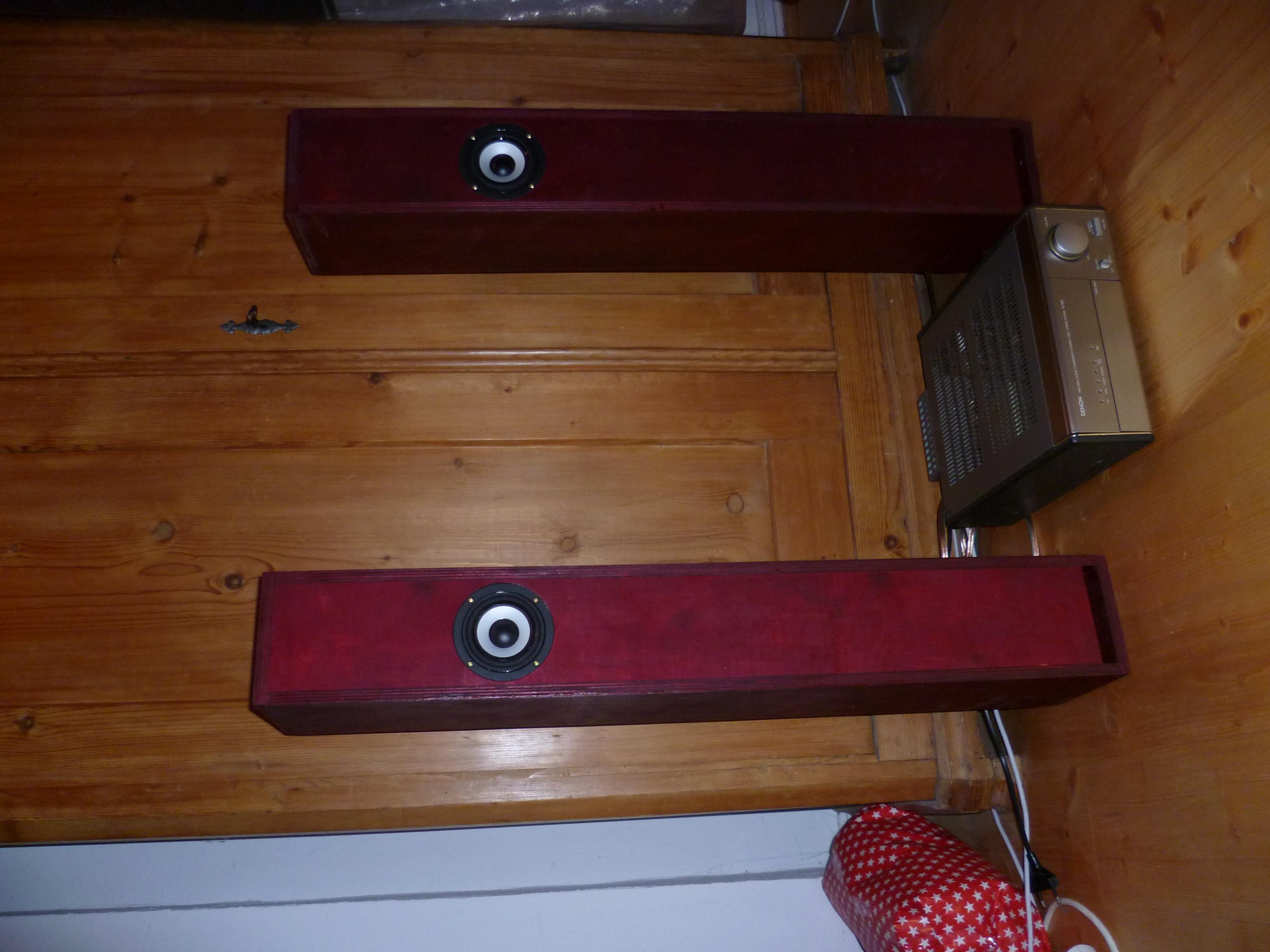

Hi guys,
thänx for your advice! I made a pair of Tabaq, and try to upload a picture. I bought this little Denon amp on the bay for 35 euro-bucks, and the sound is just great for a box of this size. Listening to Victor Wooten's "A Show of Hands" just now. Enough bass allright.

Nice work! Glad you like the design.
PS: I have never tried Vifa drivers but they do look interesting.
