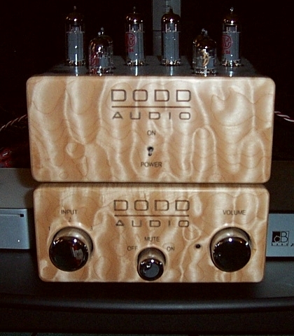

Dodd Audio has just released a kit version of their tube buffer preamp for $350. I own a Pass B1 but every commercial review I've come across on the Dodd preamps rank them as some of the best you can buy. Dodd is offering the kit at a discount on AudioCircle. I wants one bad.
I emailed Dodd yesterday asking how the diy compares with the built unit. You are correct it is looking good.
I would think that the Dodd is OK, but would bet that internet comment is highly boosted by tube-a-holic fan-boy dogma!
My money would be on a B1, and if you need gain stick a 1:2 transformer in front of it. (That would help with any ground-loop issues too).
