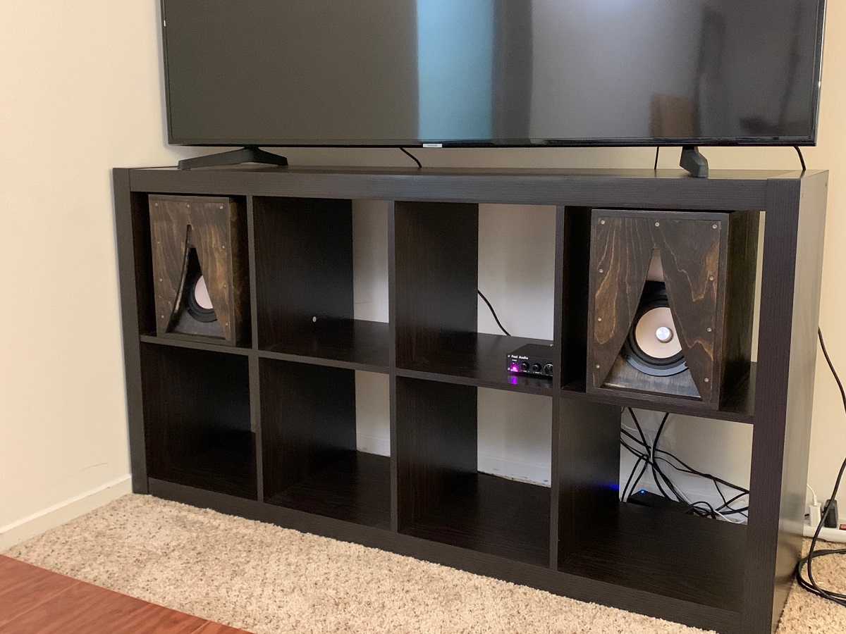

That 7MS could work as desktop if they can be 35cm deep (not specified). That is a 10L tuned to 55Hz (F3 of 49hz) of 15cm widex 35cm high x35cm deep with a frontal slot port at the bottom of the internal width (11.4cm) x2cm high and 18.6cm deep. Line arround the drivers with polyfill to avoid resonances trough the cone, but don't fill the cabinet. This is counting for 18mm plywood (just sand and varnish them for a fast finish).
The 7.3 will tune a little bit lower in that same cabinet, arround 45Hz and the slot port should be 15.3cm deep then. So it would be a better choice. But is that driver still availeble, as i don't see it in shops anymore?

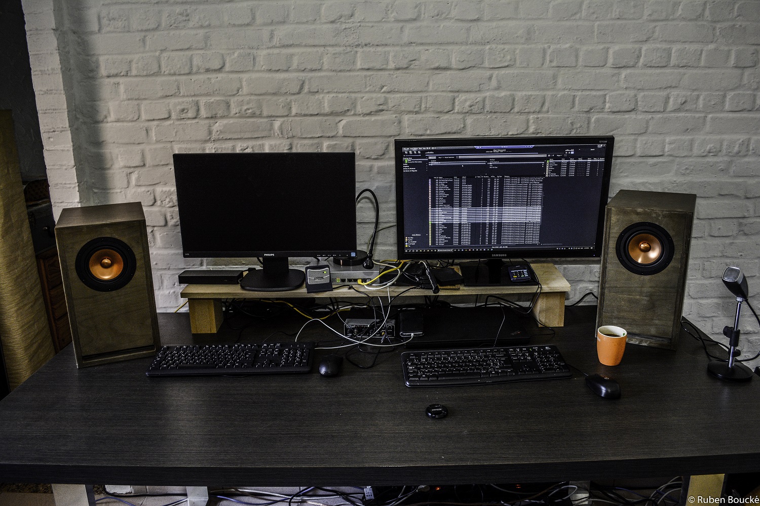

btw, i use a bigger setup at my pc with the bigger brother of the 7.3, the 10.3. But that is to wide for your size limits. It's a great speaker, much better than almost all monitors of that size that i heard...
Thanks Dave. OK, so goodbye Dayton RS100 and 2.83L ported enclosure, hello Markaudio, with 10L.

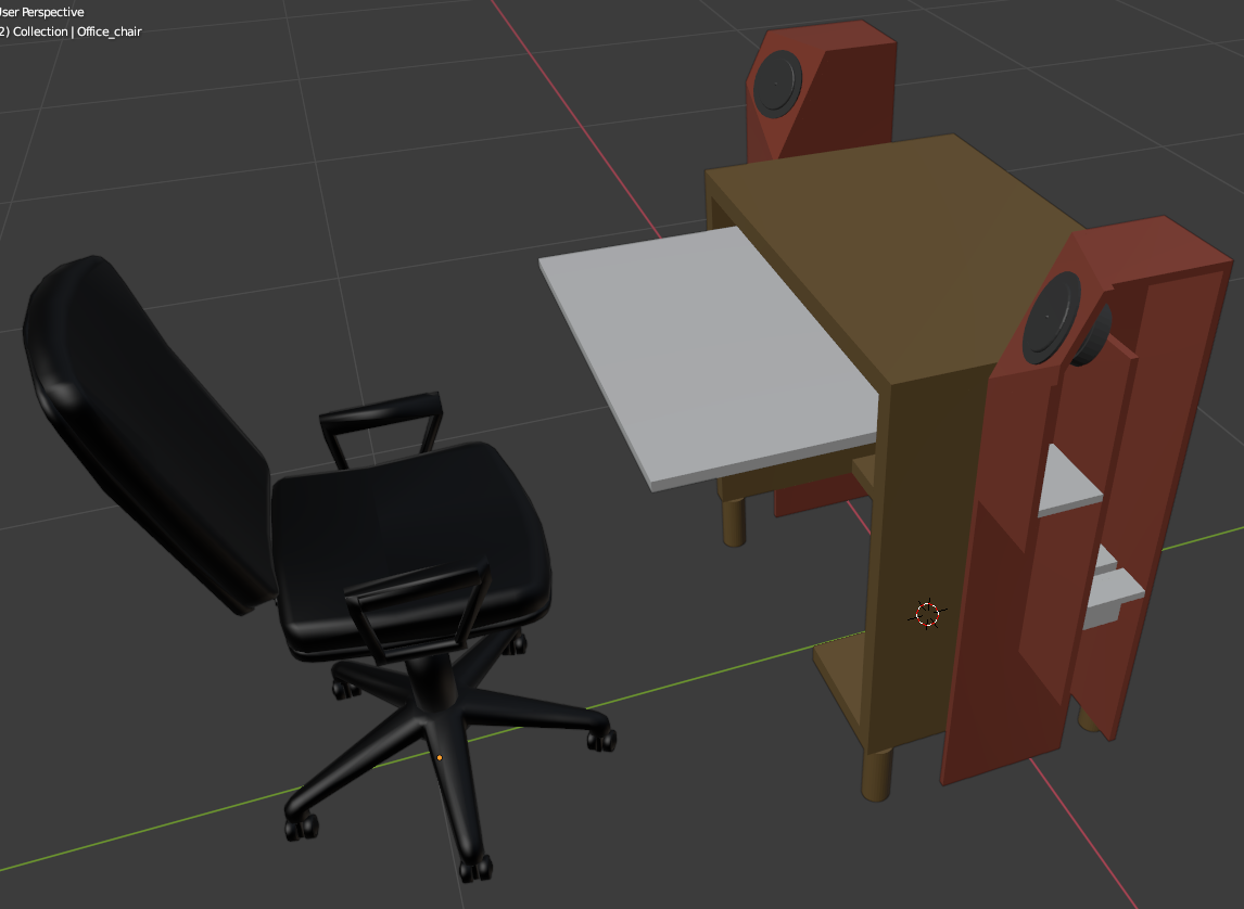

Hey Waxx, nice build! I had spotted it earlier indeed... and thanks for detailed specs!
My desk is much narrower than yours though: 10L is too much to fit on.
Nice build nandappe!
I've let the night pass to challenge your comments 😎
I could make the enclosure half overlap the desk like in picture.
If not heretic sound-wise. Any insight? Could we still go ported in there, or must we go complex?
This solution, together with tilted driver buys width for an Alpair 10 or a Pluvia 11 if desirable.
Pluvia 11 seems cheaper than Alpair 10? Which do you advise?
Represented bounding box is just shy of 50L internal volume, little bit less than MA's "Pensil 11" kit it seems.
Thanks 😀.
Thanks 😀.

Confronting those constraints:
  • speakers >10L so they sound good but too big for my desk
  • Enclosure below eyesight but drivers not far from ears
I realized what I need is basically a small column with driver at the top and tilted towards the geek on the chair...
I ponder folding a Tabaq like attached picture.
Tabaq can work with Alpair 7 it seems
I'll leave some time see if a better idea comes up.
If not, I'll jump to Tabac thread and ask what Bjohannesen thinks of my fold.
