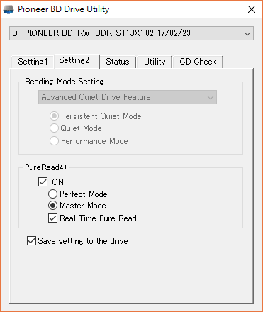

The reading stability of the CD driver itself is very large. If the error is read every time, the converted file is of course distorted. I recommend to try PIONEER BDR-S12J-x, at least try PIONEER BDR-S09J-x for CD ripping. PIONEER BDR-S09J-x has almost no sound and no vibration when reading CD.

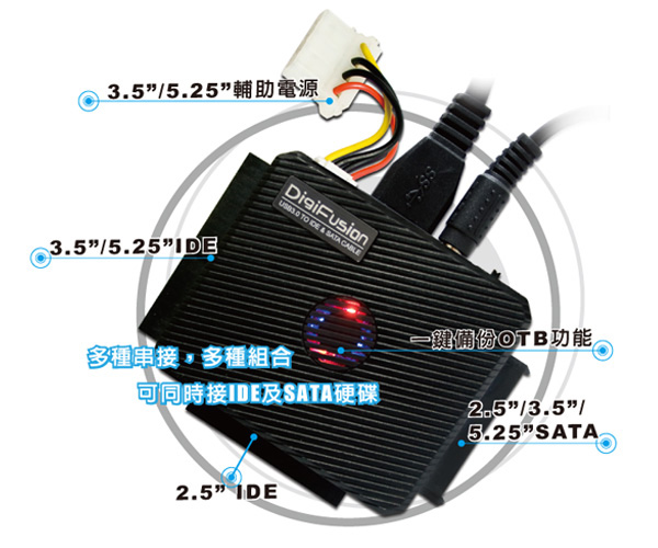

Using the SATA to USB adapter, the CD driver can be placed independently to avoid the vibration from the computer. At the same time, the external power supply of the SATA to USB adapter is used to make the power of the CD driver cleaner.

However, if the cd driver is always in error due to vibration, power supply and other factors, and is still in the same place, no matter how good the software technology is, it is impossible to know whether it is wrong. I suggest you try the PIONEER BDR-S12J-x and then post a your new comment.
