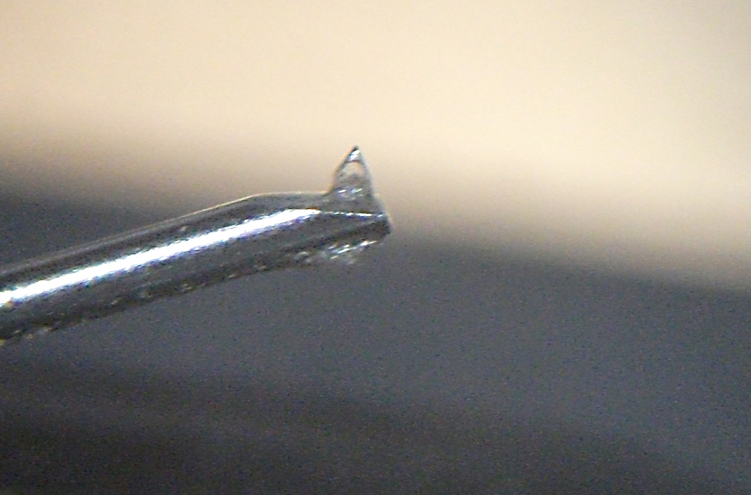

Thank you all for your responses. This cart has been in use in my home for 34 years. It had the original diamond tip that Sugano glued on it with epoxy. It had the ability to reproduce a human voice like nothing I have ever heard up until the glue let go on Saturday. I really don't want anything other than a diamond glued to the end of the flattened end of the boron tube. I know that the chances of a proper repair are slim, but I wanted stories of actual satisfied repairs.

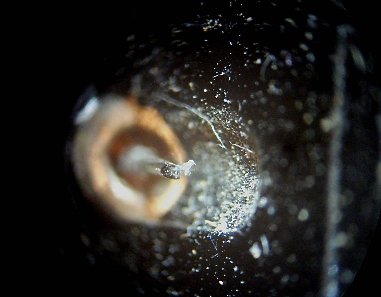

It took me the better part of a decade to find someone, anyone, who could put the diamond (I had it) back on the tip of my Sugano period Koetsu Black. The fellow was well retired for the most part, and did not need the work in the least. He did it merely as a favor.
The discussion via email that it led to was worth the entire wait and all that was involved! I can say only a few things as a result. One is that while I am rather skilled in many areas, I can not begin to understand how the precision work on these cartridges is done! It's so much akin to watchmaking, and I can't really wrap my mind around things like how they cut gears and make screws so small that you need eye loupes to even see them!!
I had to use a good quality stereo microscope to even determine that the stylus was still hanging by a thread off then end of the cantilever! It's smaller than a speck, you could lose it by sneezing funny. How can anyone GRAB it and put it where it needs to be, at the proper angle and rotated in the proper position!! How can you merely pick it up?? So, you can start to appreciate what is involved... this stuff is small, and until you actually try to DO something with it, it looks pretty basic.
