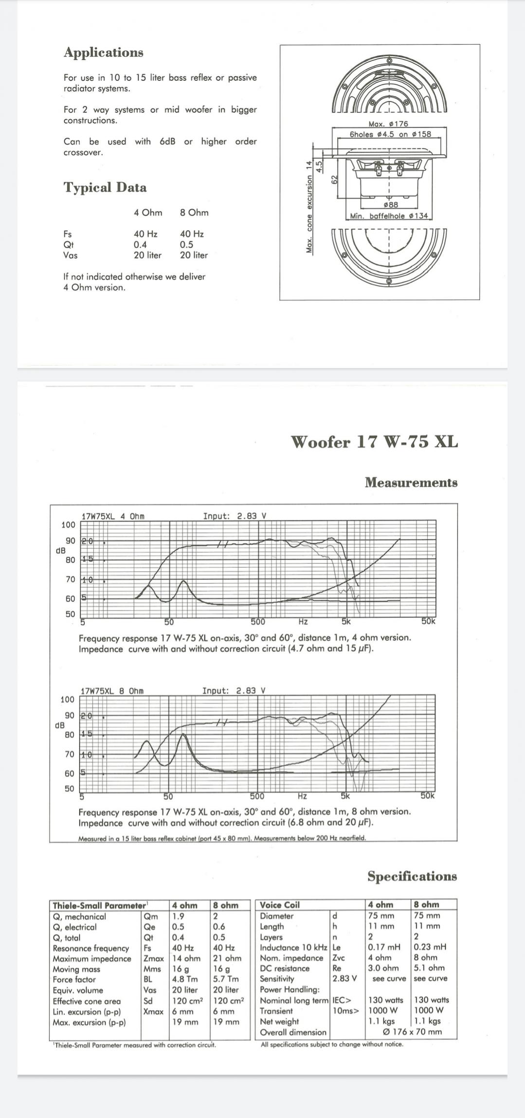

It seems dynaudio 17w75xl drivers are made for vented designs
Is it possible to use it in sealed enclosure?
What's the optimal volume for flattest response..I don't need bass. Just flat sound

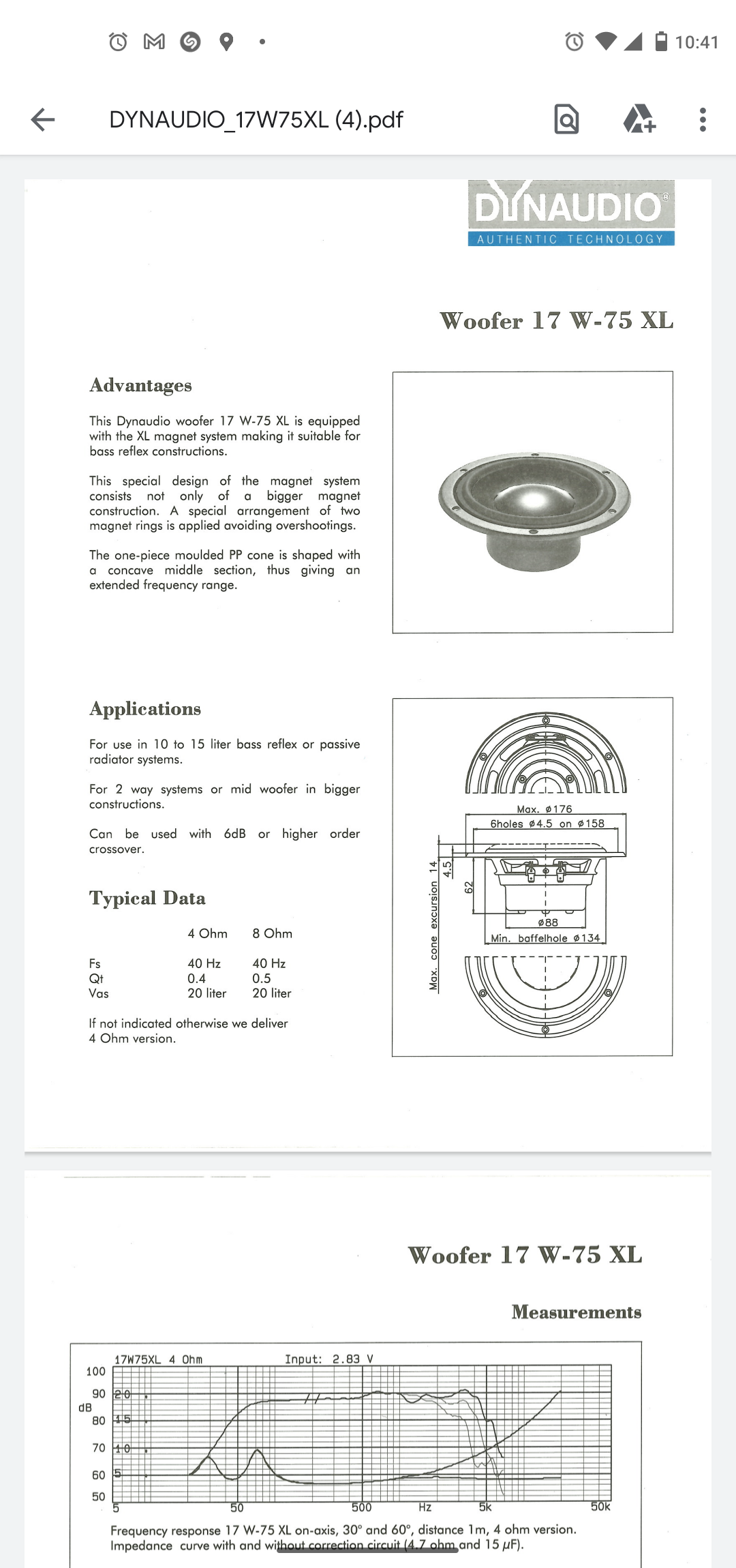

I attached the spec sheet
I have the 4ohm version
10.75 litres gives max flat (Qtc = 0.707) alignment with f3 (ignoring bafflestep & room gain) of 71Hz.
You won't get any lower than this in a sealed box without adding EQ such as a Linkwitz Transform, but if you don't need much bass that may be OK.
