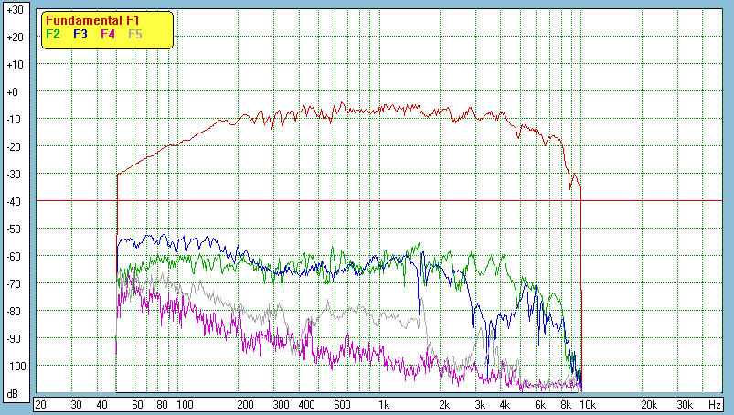

The German test magazine "Hobby Hifi" so as "Klang & Ton" published various measurements from some models of PHL-Audio:Unfortuntely PHL does not publish frequency response info, which makes life more difficult for most of us. People who use them seem to swear by them, though. Tough call. I'm in the same seat as you...
Let us know if you decide to try them!
http://lsv-achenbach.de/images/lautsprecher/test/KT_Test_phl-E17-1120.jpg (1120)
http://lsv-achenbach.de/images/lautsprecher/test/kt_test_phl-M20-2520.jpg 20 2520)
http://lsv-achenbach.de/images/lautsprecher/test/kt_test_phl_4530-2.jpg (B30-4530)
http://lsv-achenbach.de/images/lautsprecher/eigene/point_p/kt_test_phl_3002.jpg (B25-3002)
Under post #1 by the Australian forum in German language you will find more URLs in this case - go to

Thanks for the links! I had not come across these.
Interesting. I was thinking either 6.5" or 8". The 8", being larger, starts beaming at lower frequencies but crossing it at 1800-2000 Hz to the TPL-150H seems a good fit, while having a larger area than the 6.5" - hence more dynamics.

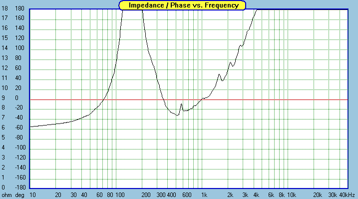

What doesn't look as good about the 2520 is the sagged impedance and phase curves. Do you think it's cone breakup?
"This is the only 8" pro midrange I've ever tested. Very unique driver that reminds me of the previously tested 18Sound 6ND430 in some ways. There is no copper in the motor and inductance is relatively high, however low non-linear distortion is likely obtained through motor strength and heavy saturation of the magnetic gap. Nice midrange driver though there are some serious usage limitations. Off axis of an 8" midrange droops very early and shouldn't be used above 2kHz. The driver is rated at 2mm of Xmax, though the flat foam suspension likely becomes a limit even before that 2mm is used up. For people using this mid, I'd recommend full featured excursion simulations to be sure that low end is not being over worked. That means excursion simulations done with a filter in place."
