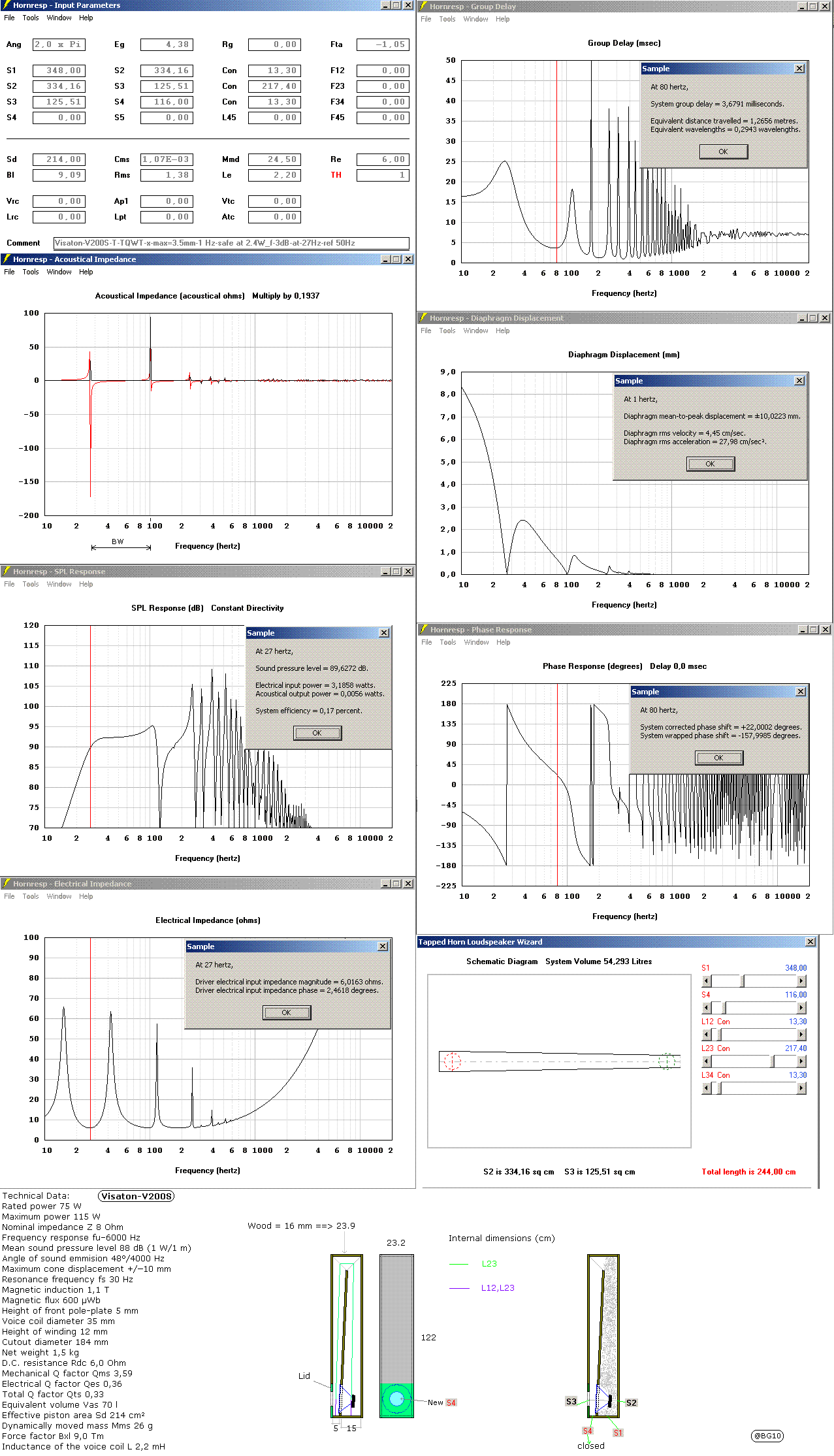

Hi Antripodean,
For SQ and at bed room SPL: s: Here is a design that might suit:

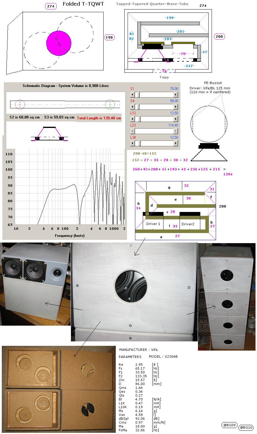

Many Thanks Bjorno, it looks reallygood 🙂 Can it fold in half (to halve the height)? and keep the same efficiency/FR?

Hi Antripodean,
Yes you can and you wont lose overall SPL more than a fraction of a dB in the passband if your fold preserves the minimum requirements of the CSA: s in the bends.
This will make the height of the speaker shorter and as a bonus the folds will LP attenuate the wiggling FR mostly above the targeted passband, more than the stuffing’s does, at least parts of the BW also but depending of the airways section lengths and the of the degree of the bending.
IME, if you fold only ones you need stuffing’s in about half of the line, but about a third is enough if folded more.
So far I’ve made 8 T-TQWT’s and all turned out very well compared to earlier built TLs/TQWT’s/ QWP: s and MLTL: s.
See a couple of small (the cut and paste pictures here below from last year spring and summer) more than once folded T-TQWT’s using buyout and scrap drivers that really sounded IMO very good in their new enclosures.
b

Hi all,
I hope you don't mind me unearthing this ancient thread, but I'd like to build a T-TQWT sub using the W200S as a driver. Trying to do this in a hurry as I need it for a project, so the simpler the better!
It should be a column speaker with just one fold, and I seem to have found what I'm looking for in this design, which was posted by user bjorno (re-attaching his image here).
Problem is, I can't figure out the diameter of the hole in the front 'lid'. Can anybody help here please?
