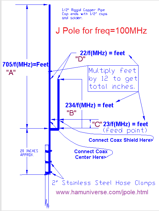

The J-pole is the Best fm antenna I have used so far when it comes to omni directional antenna's and my FM receivers, a Discone is on my list next to build.
I built mine for 101Mhz for WRIF 101 from Detroit up here in Michigan and I am in Jackson +150 miles away no issues with it yet !!

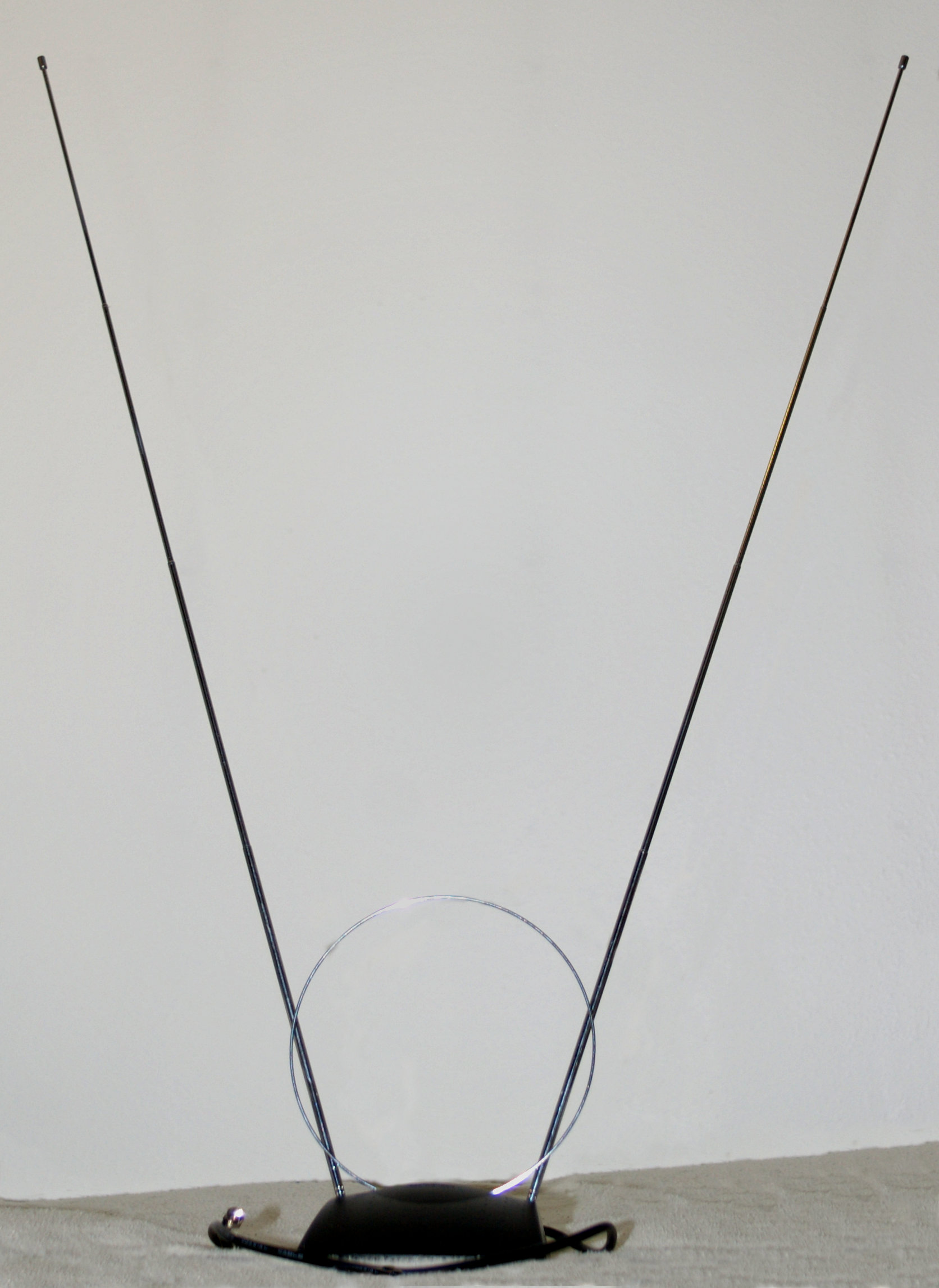

If you mainly tune in local FM stations, then standard rabbit ears should work fine
if you try moving them around a bit.
A Yagi array may be too much for local stations, it can give an overly strong signal.
Also check it for the frequency band if it is an old TV antenna.
