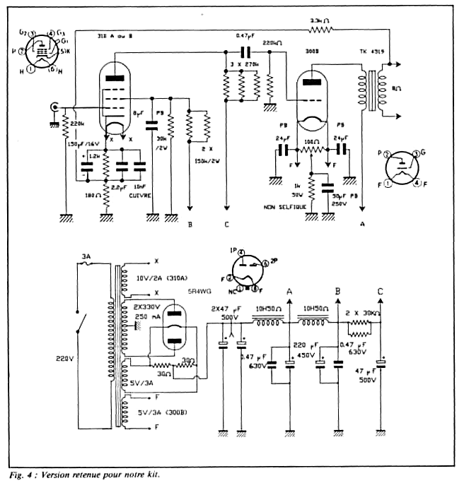

Personally, I dont think there is such a thing as a 'Best Schematic for 300B'.....
Each designer will think that his design is the 'best'
What is best??--For you, one design may sound 'Best' but same design to me,- may sound crap!
Too subjective an issue....

Best I've heard out of all the things I've tried out is 10Y into 10Y into 300b. If you can get good transformers, then get something like two LL1660/10mA - one after the first 10y and one after the second.
you will be all trsanformer coupled and clean as hell. Detail with surprise you. the timbre of instruments will astonish you. The delicacy of the treble will enchant you.
You won't need to go roaming in Slottsparken at nights - you will just stay at home with an insane grin on your face. Gradually you will cease going out at all. You will forget about being samfundsbevisst. You will forget about samfund in general. You will be discovered in 70 years time still grinning.

I don't know what would constitute the best, but here are three intellectually interesting designs that are not just a 6SN7 SRPP cap coupled to a 300B.
http://electra-print.com/300bdrd.php
http://nutshellhifi.com/IT-Triode-Amp.gif
http://tubelab.com/TubelabSE.htm

Andy do you happen to have a simplified schematic? I've collected my stash of 210 tubes and want to try this exact configuration. What did you use for plate / bias voltages, etc? OPT impedance suggestions? 3K, 5K? Lundahl as well?

The schematic I posted above is the best amp I have ever heard. (FWIW). It was a great amp with the Tango budget iron, sublime with the much more expensive iron. Still the same amp, tho. Just better with a better OPT.
Partial to this one...after modifying to get op of driver to 12ma.
http://gallery.audioasylum.com/cgi/gi.mpl?u=45887&f=Gemini_Mono.jpg&self=897459538
