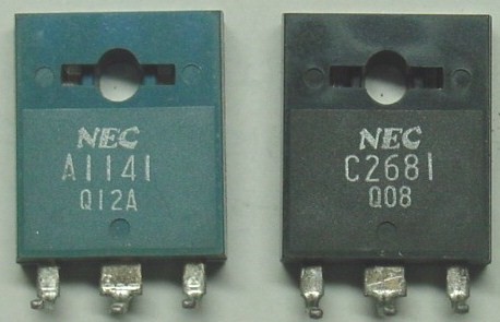

I know most of them here are maid by Toshiba, but they really doesn`t sound the way they should 🙁
So which one is the best of the best for you 🙂 ?

homemodder said:Theres is also harder to get NEC parts
