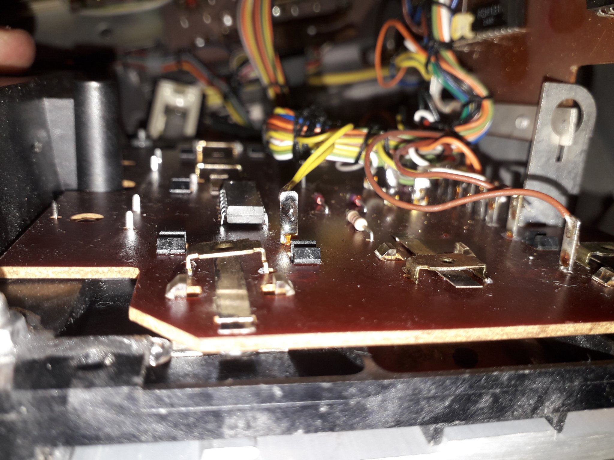

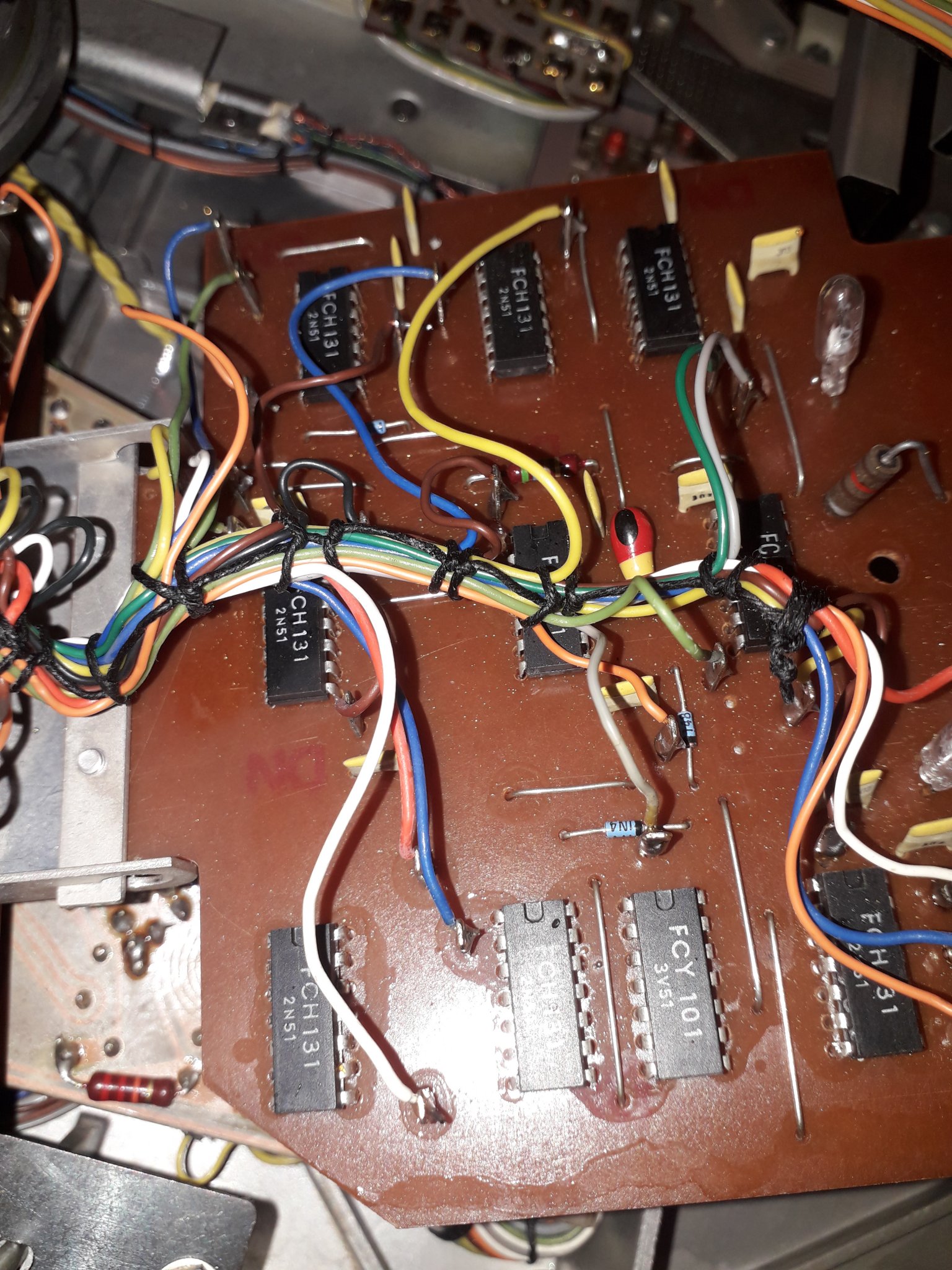

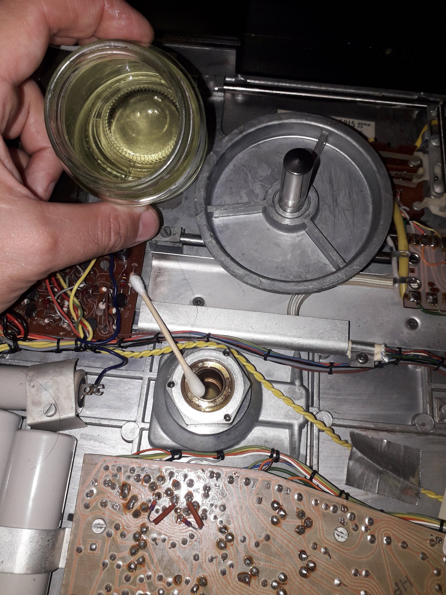

I got this to make it work for a friend.The Off and left right switches were not working,cleaned and made them straight...then lubed the platter bearing with compressor oil .Tomorrow some white lithium grease and fine silicon oil will find its way to the tonearm sliding mechanism, all grease and oils being brought to me by a very good friend @sergiu2009 .
It came without the cartridge and having one unused I got the full refurbishment job.
Some minor problems need to be chequed.

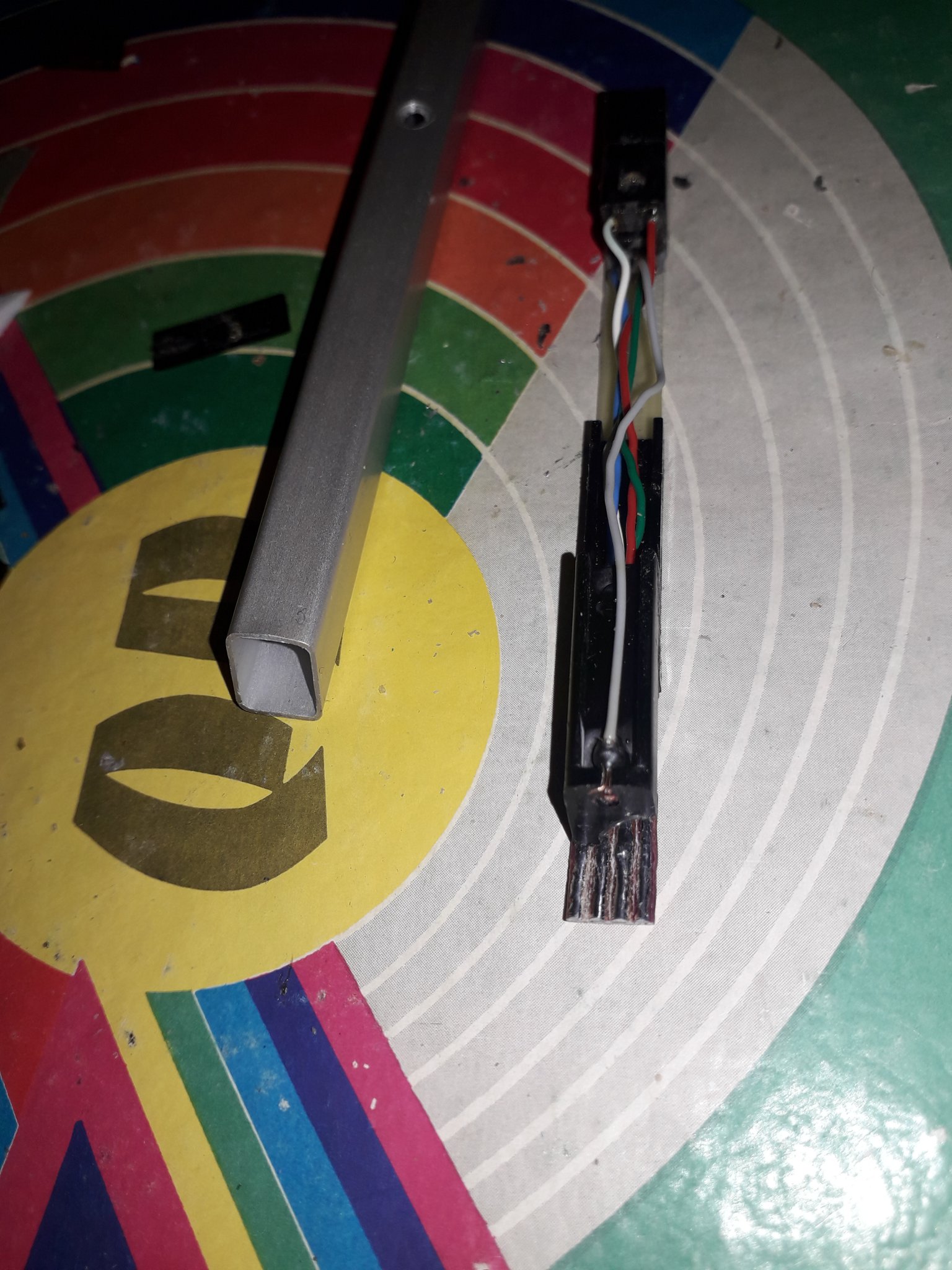

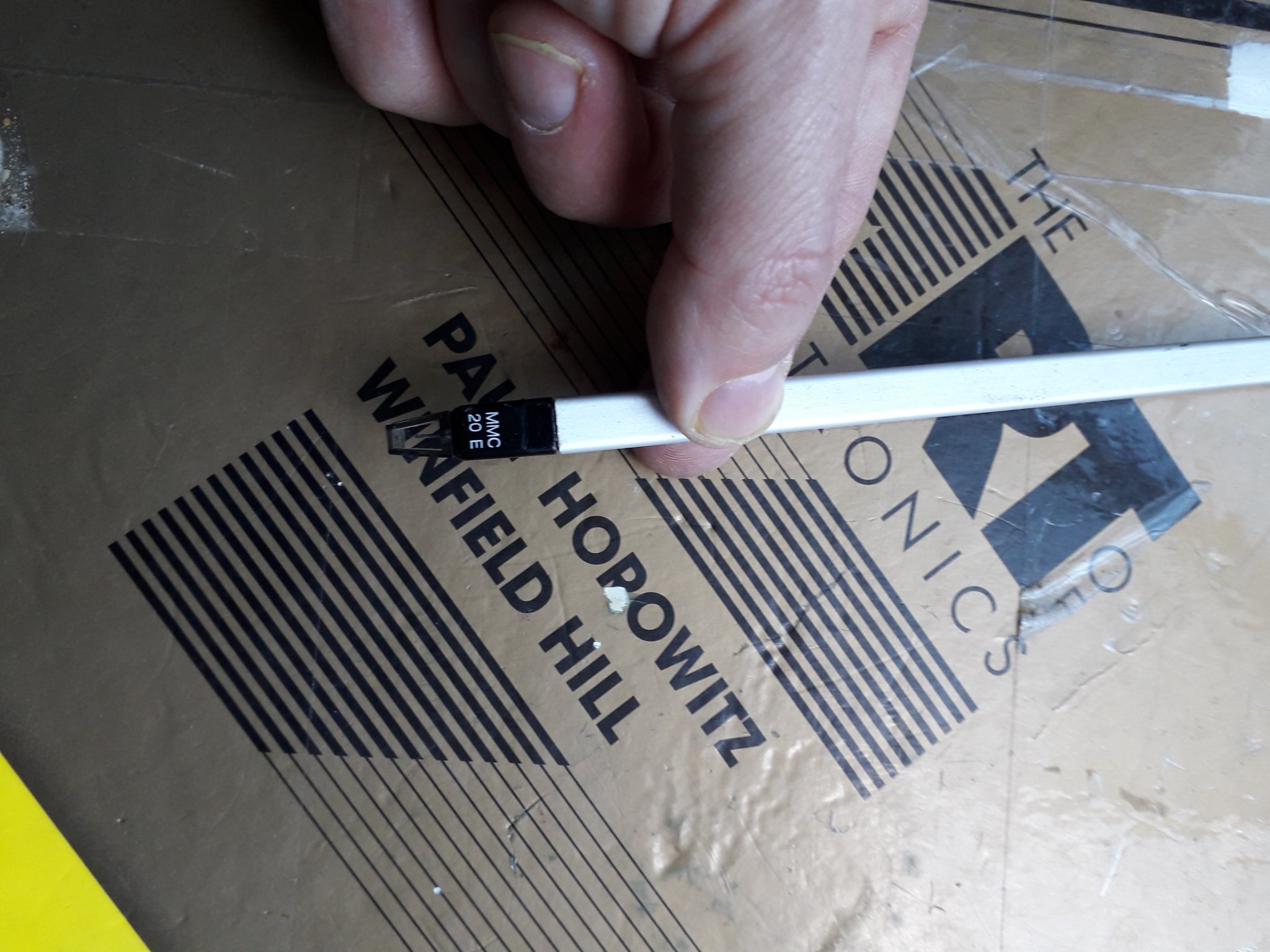

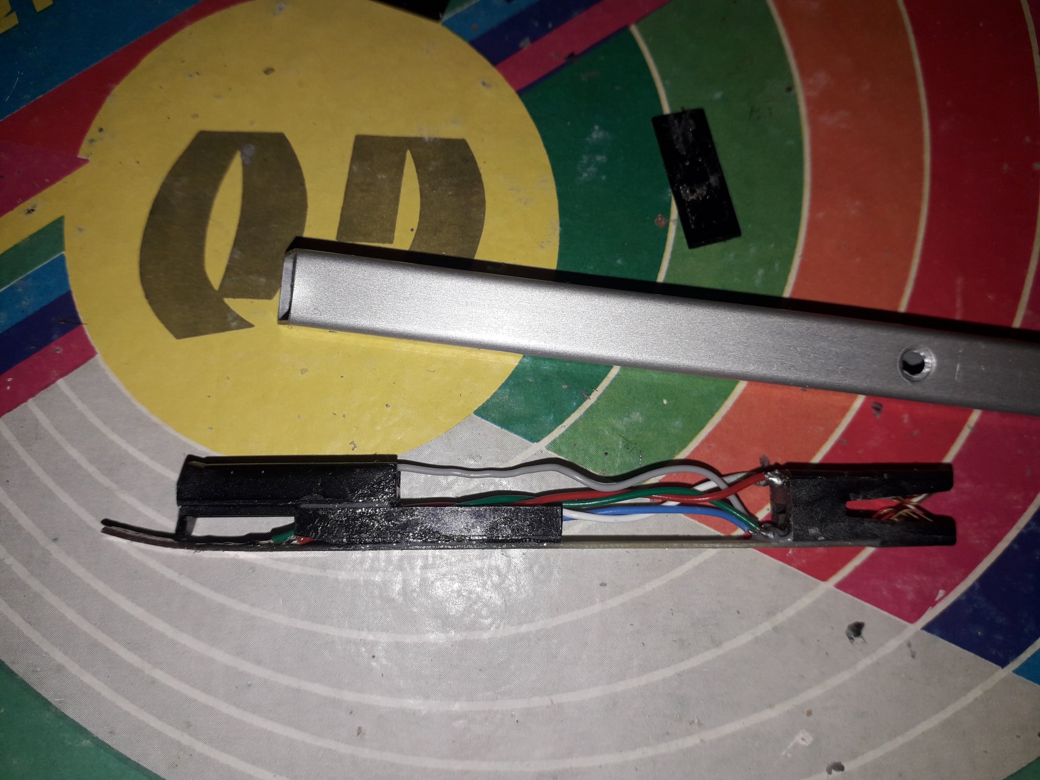

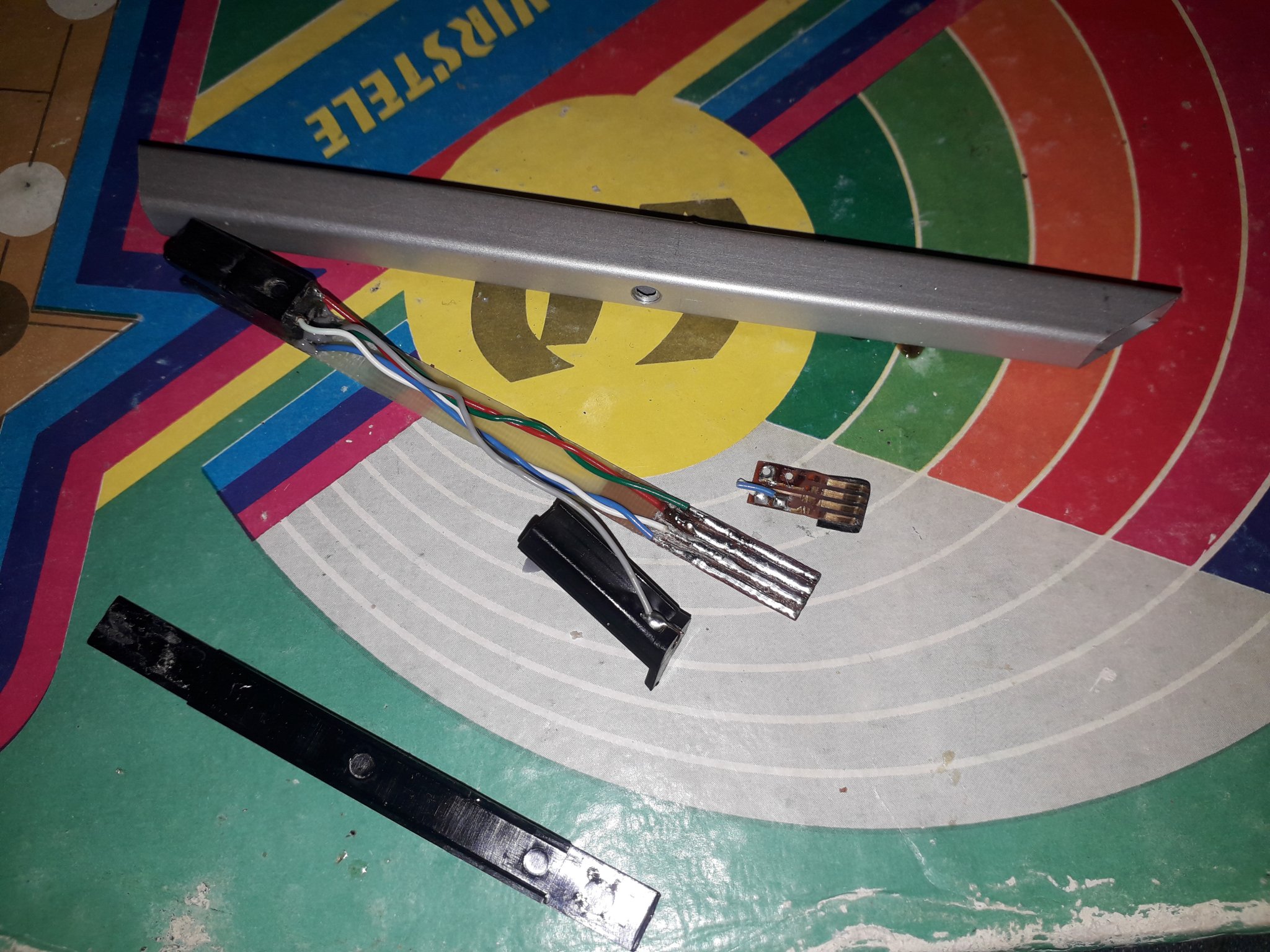

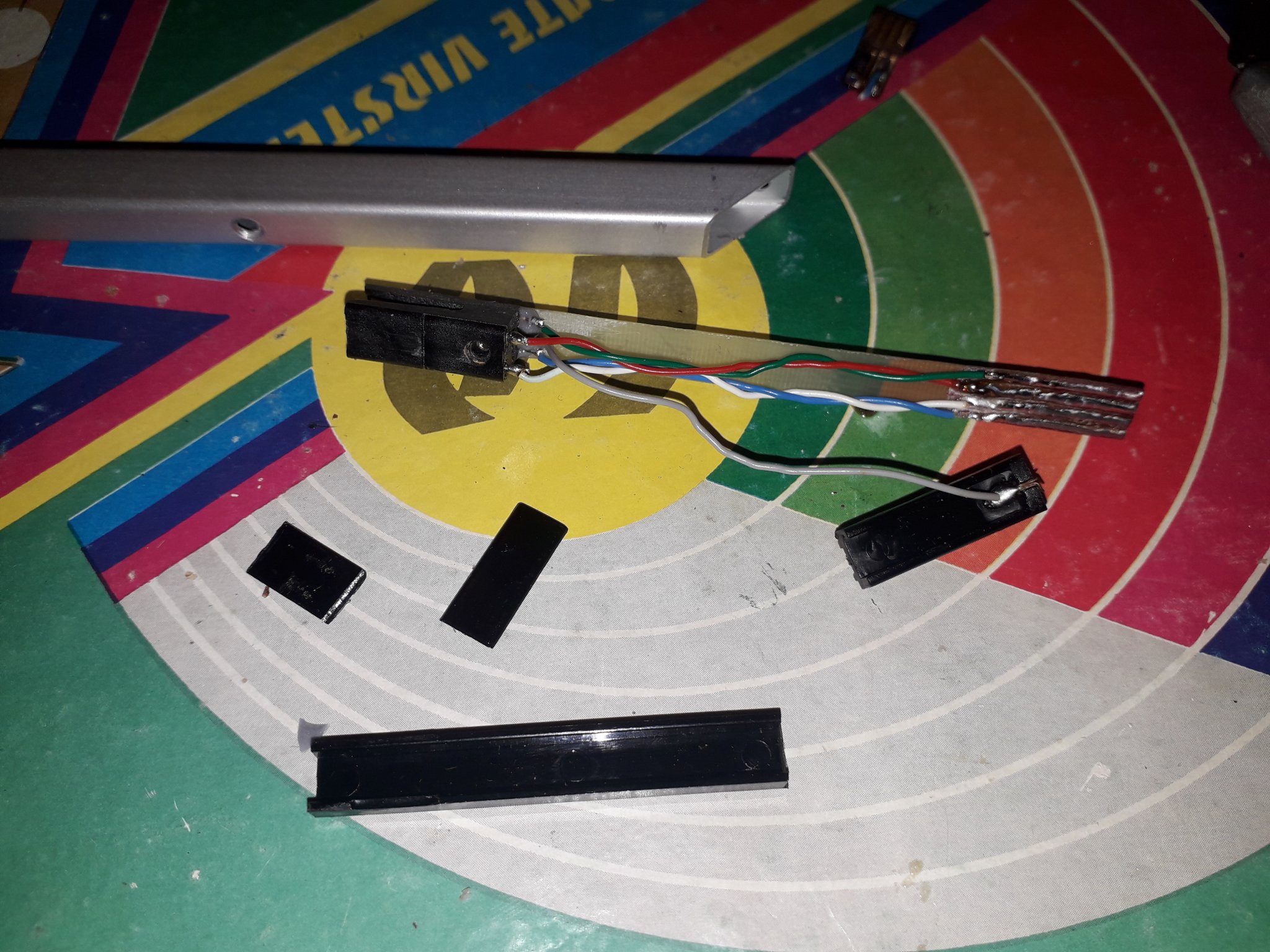

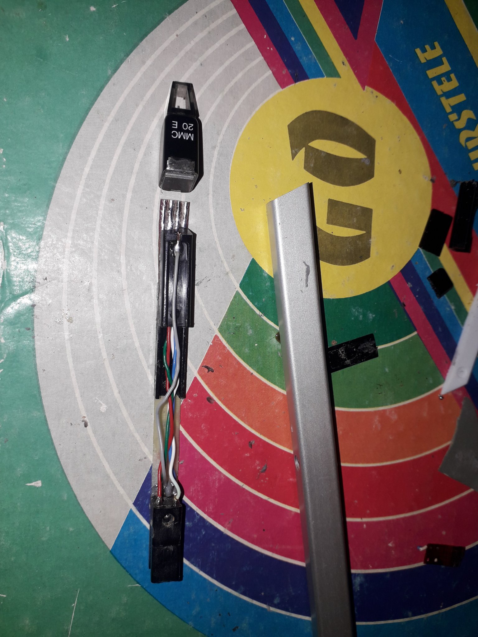

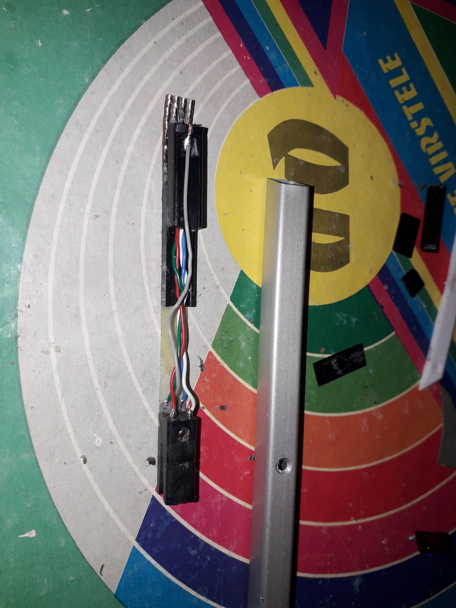

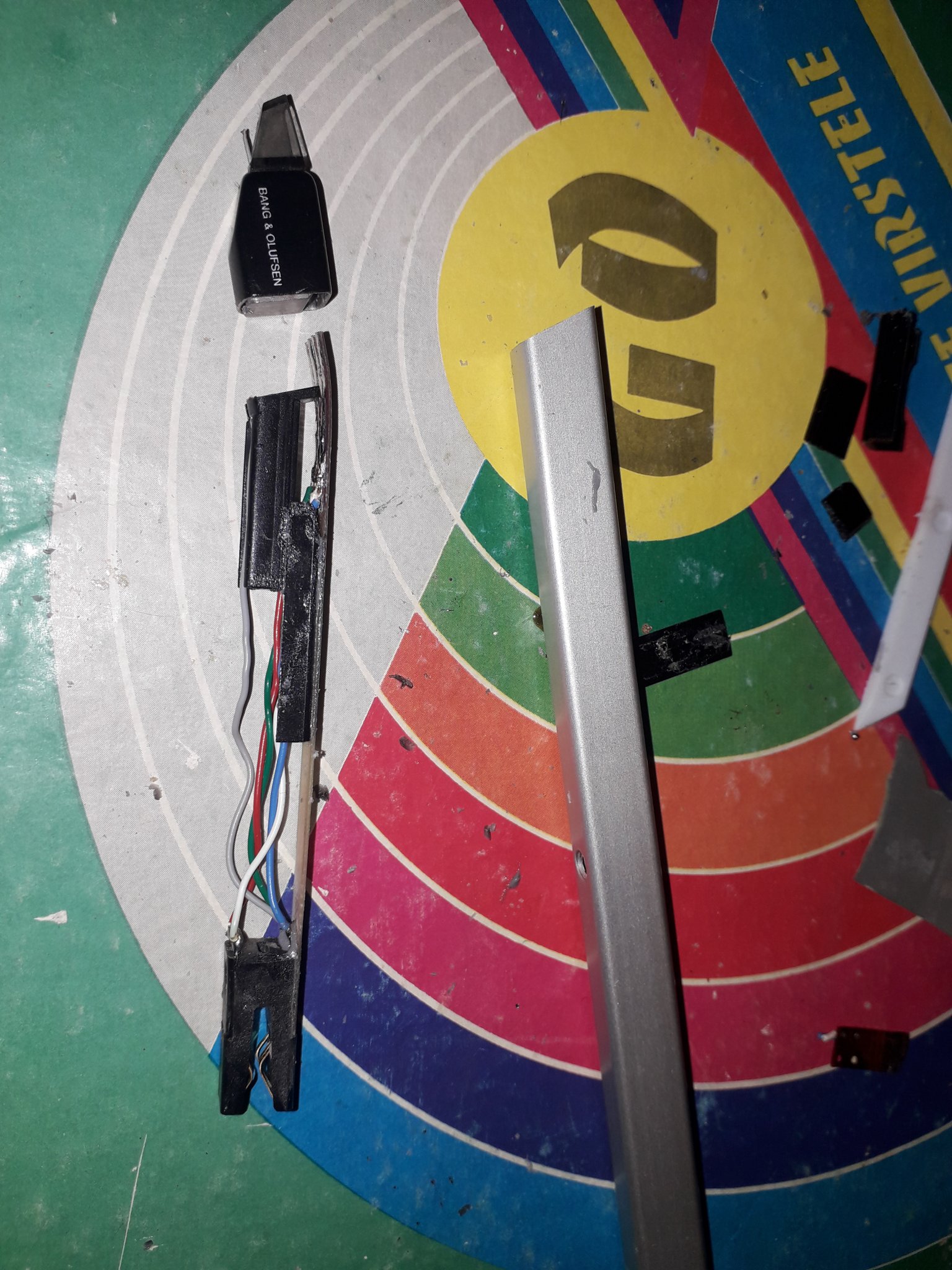

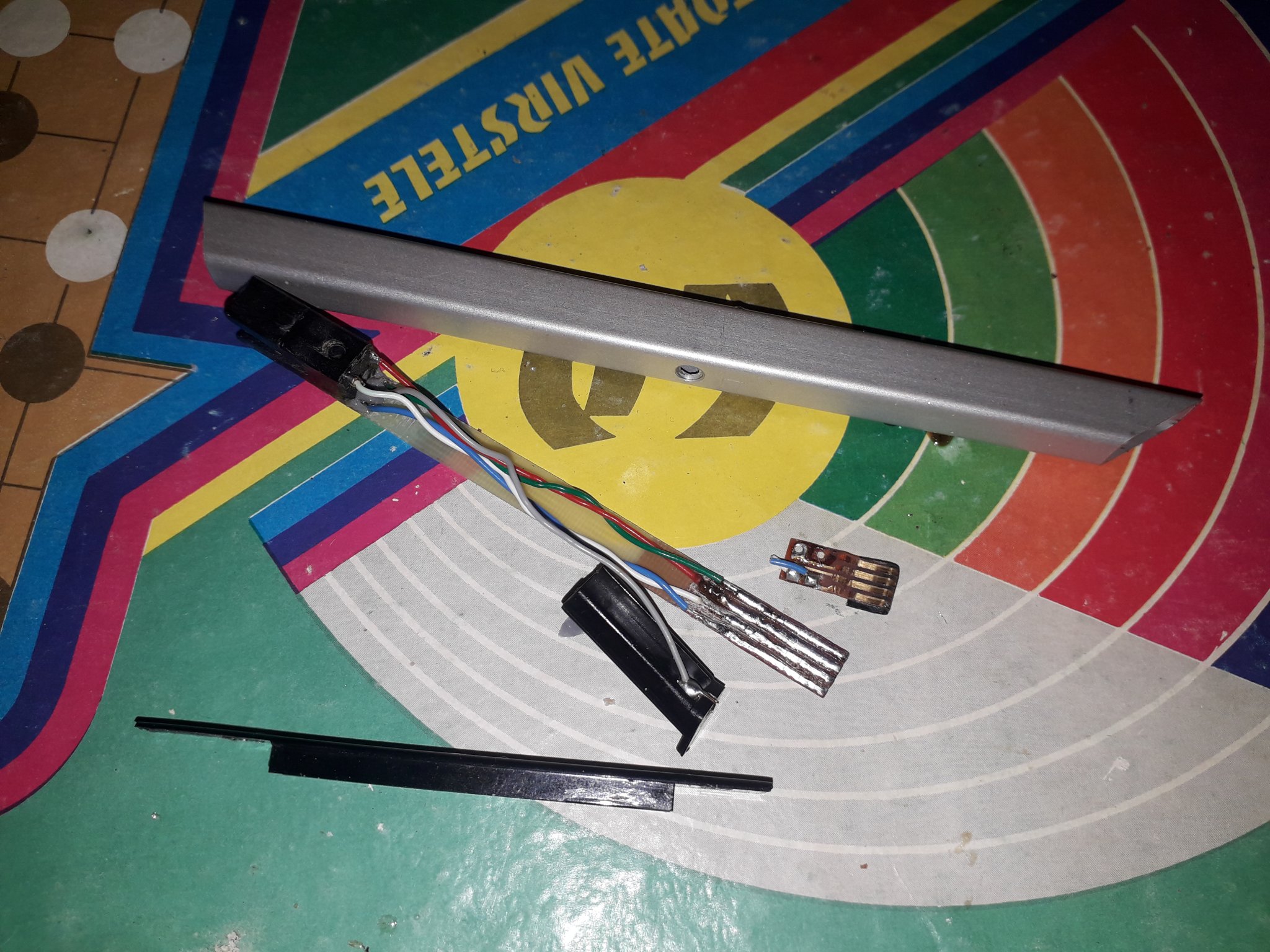

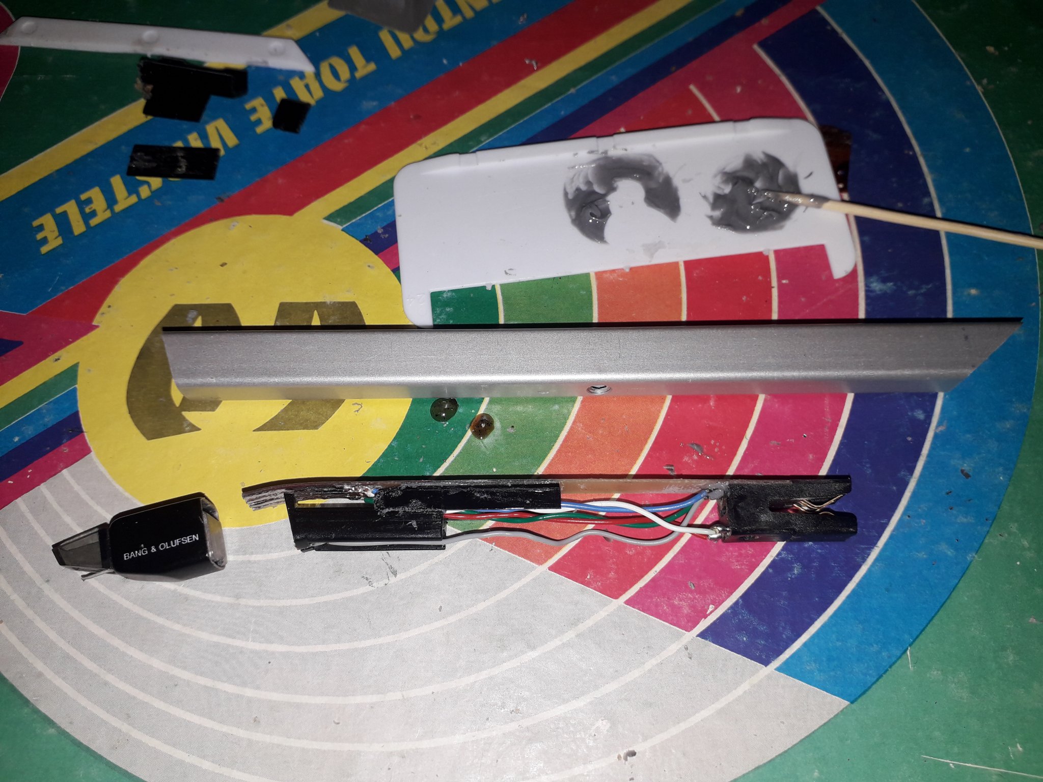

After failing to find a 3d printing service around to make me the most difficult part, i disassembled then rebuilt the internals of the tonearm with some 0.5mm pcb...Really curious to see it tomorrow at work...the loading seems ok at the moment.

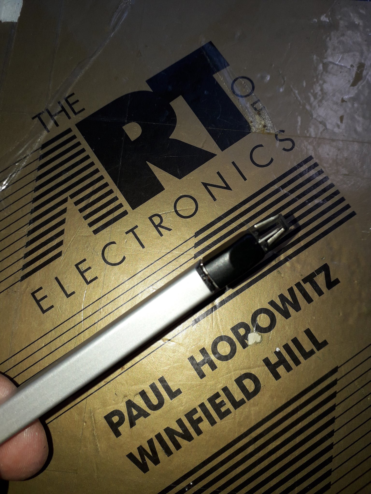

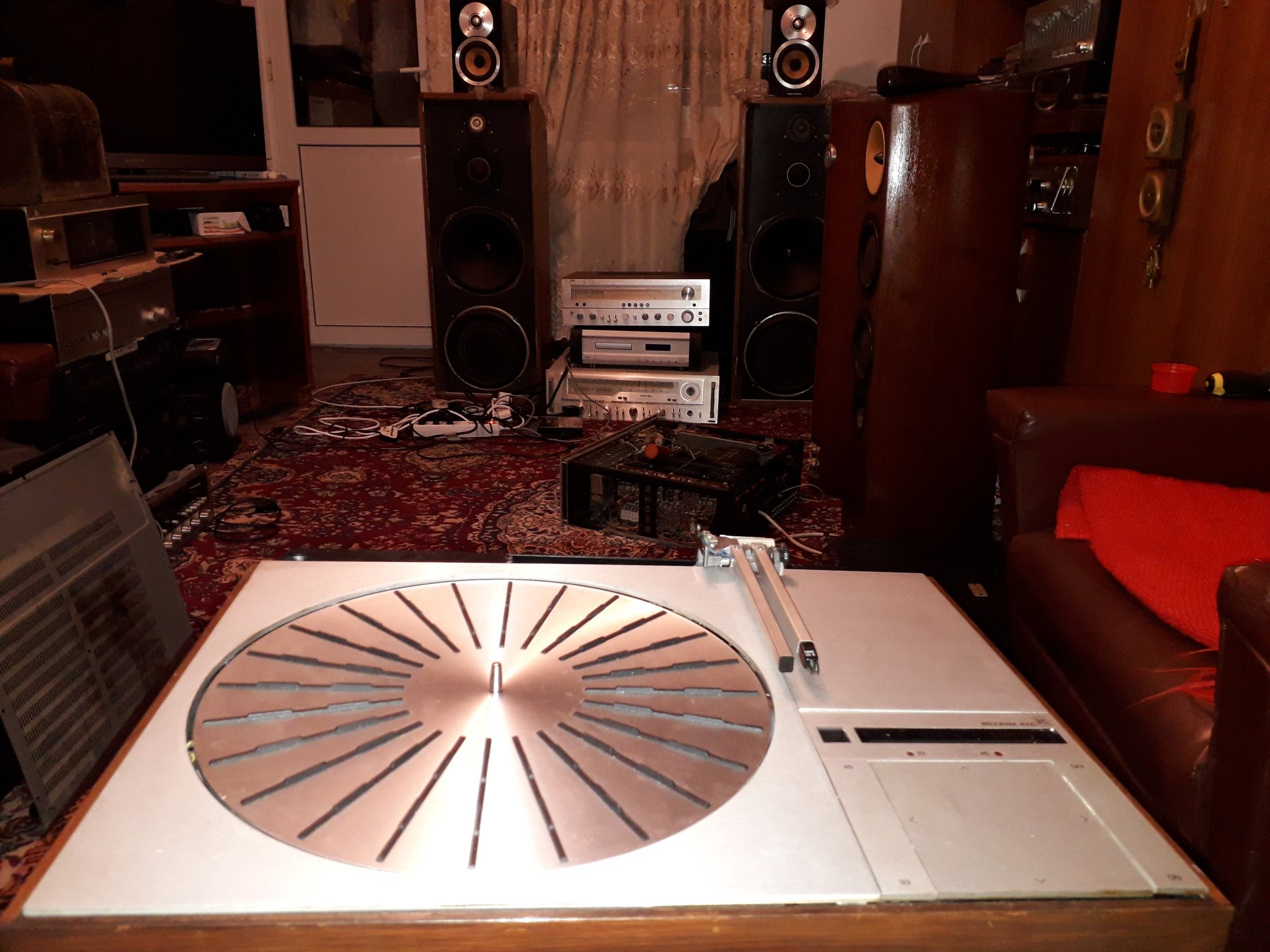

Some more adjustments were needed unfortunately...but it worked in the end very well.The on off button is a bit off...i see it only now in the pictures, but i still need to get there for a final touch and an audition.It wasn't the time for that yet.
