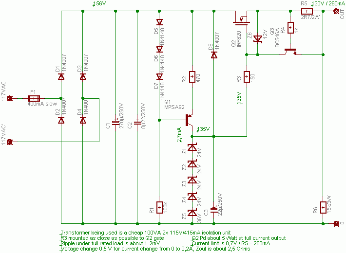

Another idea to keep costs & dissipation low is to use several cheap 100VA isolation PTs.
Build several separate fixed stabilized voltage PSU units with them, then "stack" those units on each other to one unit below the desired voltage, and stack another variable regulated PSU on top for fine voltage adjust.
Be aware that safety relies on the isolation of each unit from the mains! Be sure you know what you are doing!
Neverteless, I often use this method on the bench, from zero up to 4 units stacked as needed, and a variable Gossen/Metrawatt 0-160V/300mA PSU unit on top.
Attached the circuit for one of the fixed & stabilized voltage PSU units.
The MPSA92 + surrounding parts forms a temp-comp´d CCS for the Zener string (very good voltage stability, low temp drift). B546A, R4 and R5 form a current limiter.

Sorry for digging up an old topic, but recently I came up with this same idea of stacking up fixed regulated PSUs on top of a variable one for HV bench supply.
Currently I have a Kikusui PCM350-0.2A which can vary from 0-350V @0.2A, and the maximum desired B+ is approx. 1kV so all left is to build 2 units of fixed 300-350V/0.2A.
I did some quick searchs thru the forum but havent found any design which can withstand multi-purposes need: short circuit protection, high capacity load, decent quality... yet simple enough for homebrew (I tried open the Kikusui but the inside is way too complicated to follow).
