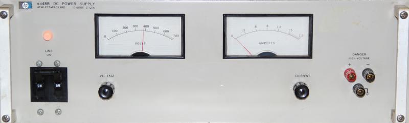

Bench Power Supply Questions ?

The 6448B is an old style 60 Hz switcher. Its control loop is VERY SLOW, hundreds of milliseconds reaction time. The current limiting is equally slow. There is also a quart sized electrolytic cap directly across its output. Have you ever shorted its output while it is operating at 650 volts? It will blow a #18 wire in half, or blow an electrolytic cap right off a PC baord. Don't even think about fusing its output with a glass fuse. Yes, I have one, and yes, I learned all these things the hard way!
I think seriesing two of these is a good way to blow up one or both of them. Each one will output 1 Killowatt, and draw about 1200 watts at full tilt. Can you even power two of these. I have blown my 15 amp bench breaker with mine several times, under normal operation, no shorts, just a 525 watt tube amp. What are you building?????

If I have 2 HP 6448B, can I hook them up in series to get 1200V ?
Each 6448B is 600V max.

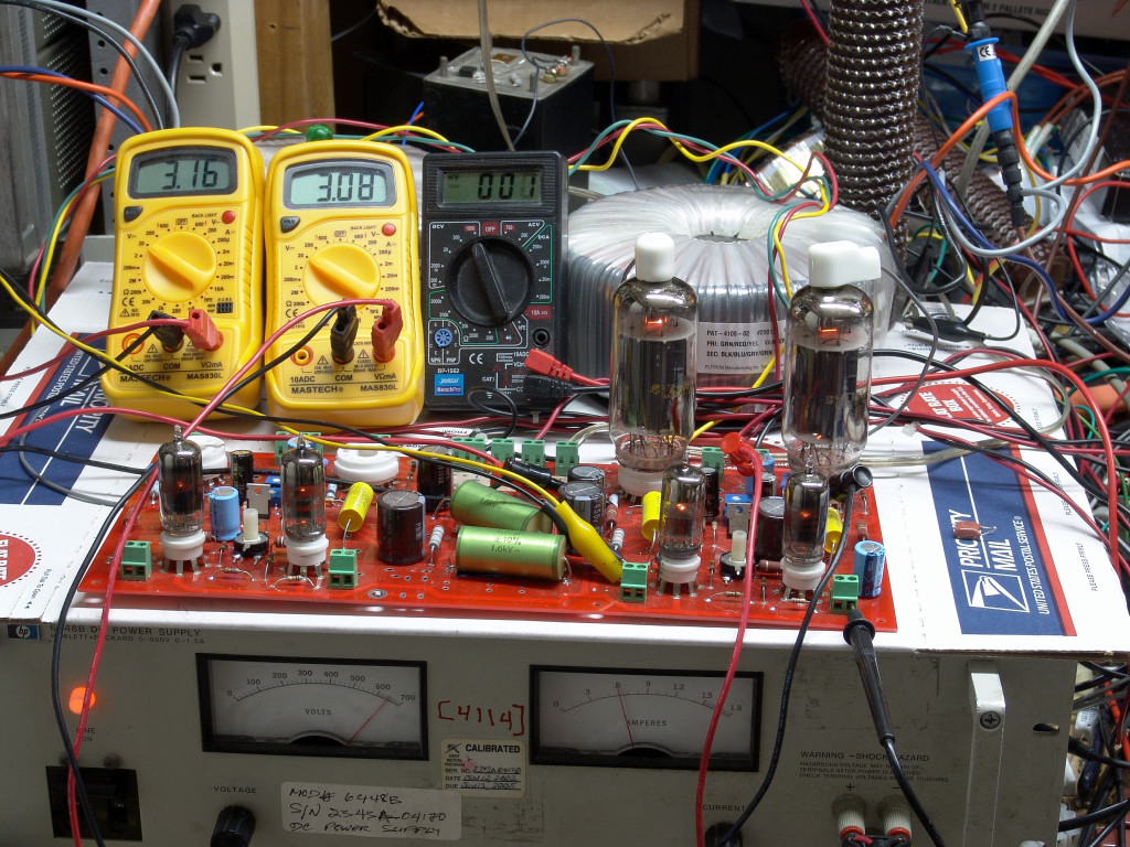

I only use the big guy when it is needed. The same board with new caps and bigger tubes:
The first picture shows one of Petes boards with a single channel being tested. The big HP is set on 650 volts and one channel of the amp is drawing over 624 mA. The yellow meters read cathode current (volts across 10 ohms).

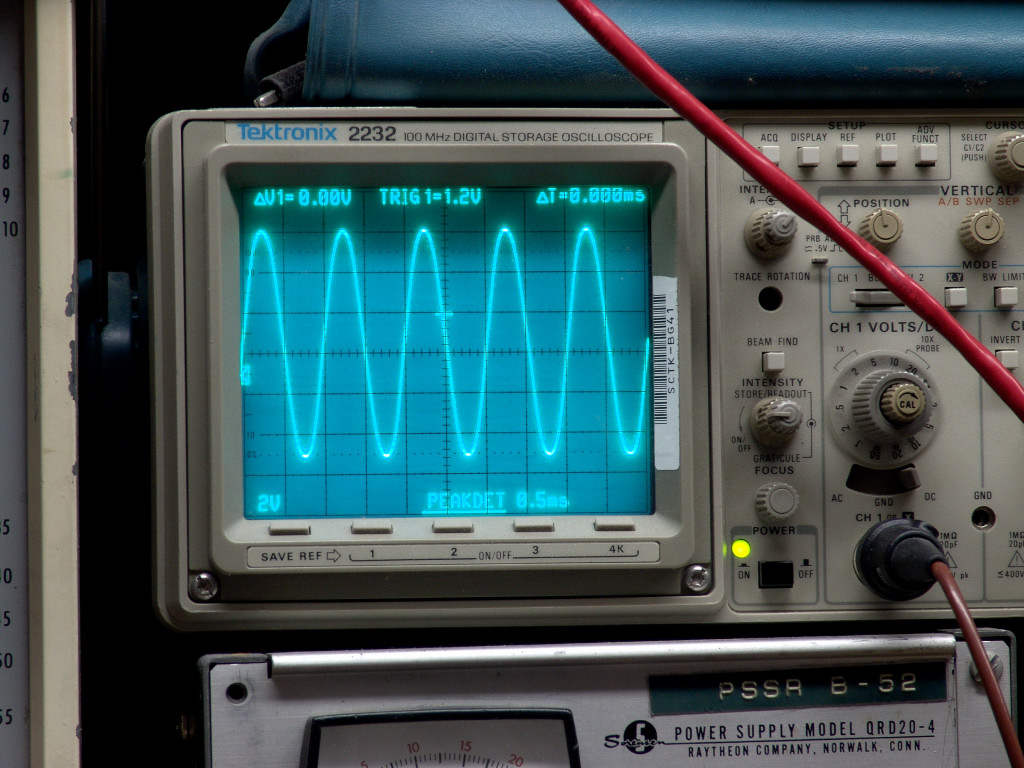

Second picture shows the output trace at 266 watts. Note the Sorensen QRD20-4. As you stated it's good for heaters, bias and solid state stuff, makes about 24 volts all the way up. Rated for 4 amps, mine goes to about 4.5.

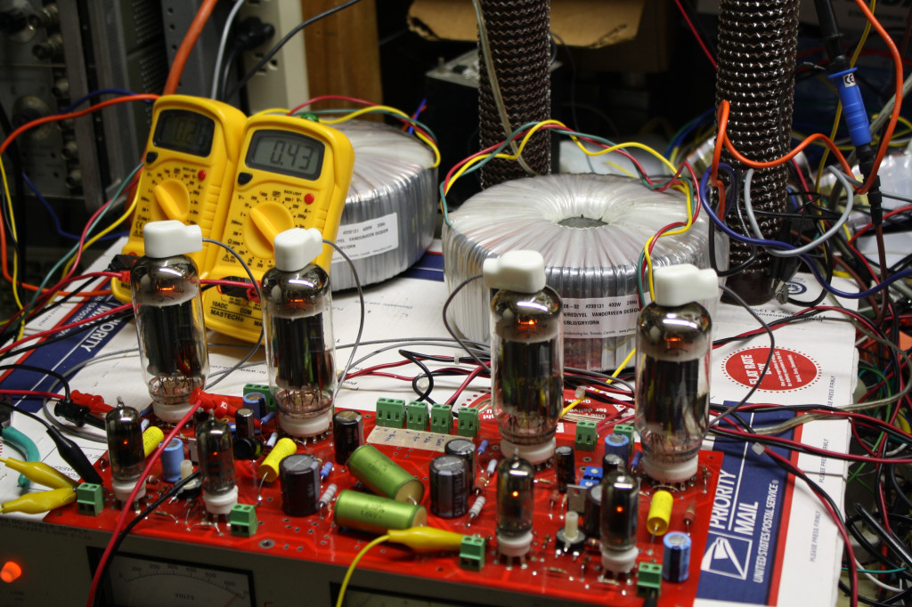

Third picture shows the second channel now operational and wired in parallel with the first through a common OPT. Still idling here.

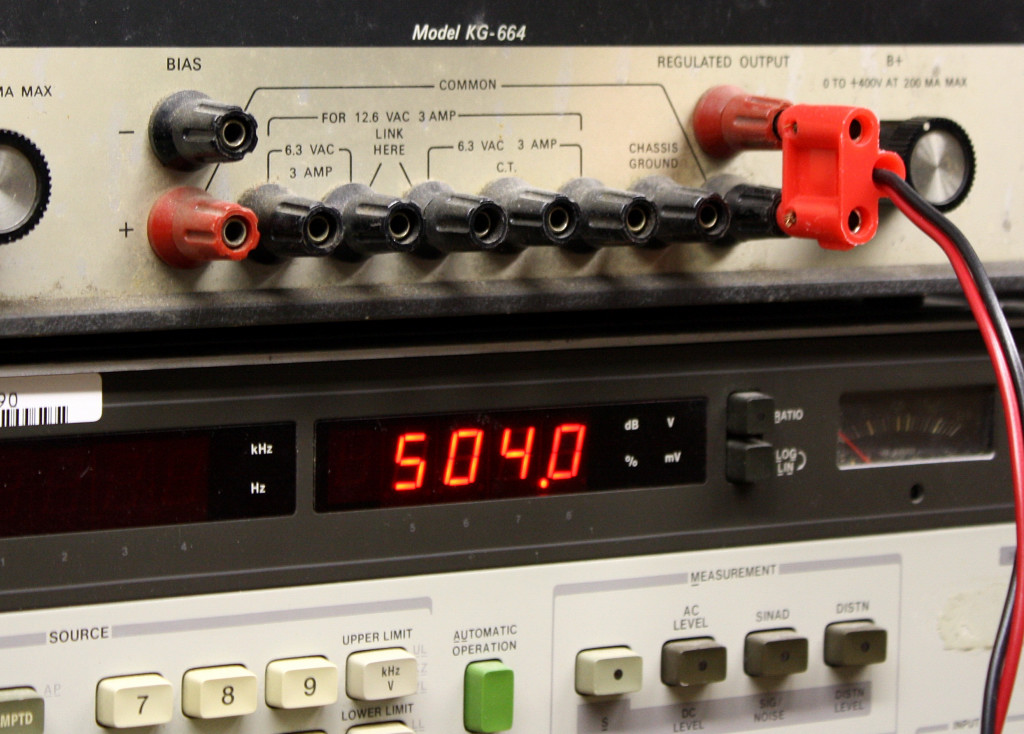

Fourth picture shows the 8903A reading "watts in to 8 ohms" (19.0 SPCL). 504 watts! Note the Knight KG-664 (I had the # wrong in the previous post). This was a $25 hamfest find and goes from 0 to 400 volts at 200 mA.
