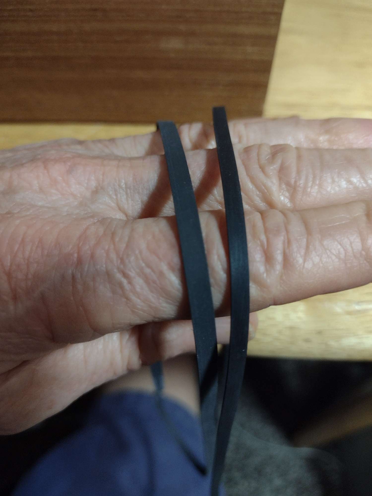

The turntable belt looked old, and I figured it might be original. I ordered a good replacement, but it would not stay on the pulley.
Another thing I noticed was that the belt was thinner than the standard replacement belt.
I purchased a replacement pulley. But it suffered from the same difficulty - it would not stay on the pulley. It works fine at 45, but will not work at 33.

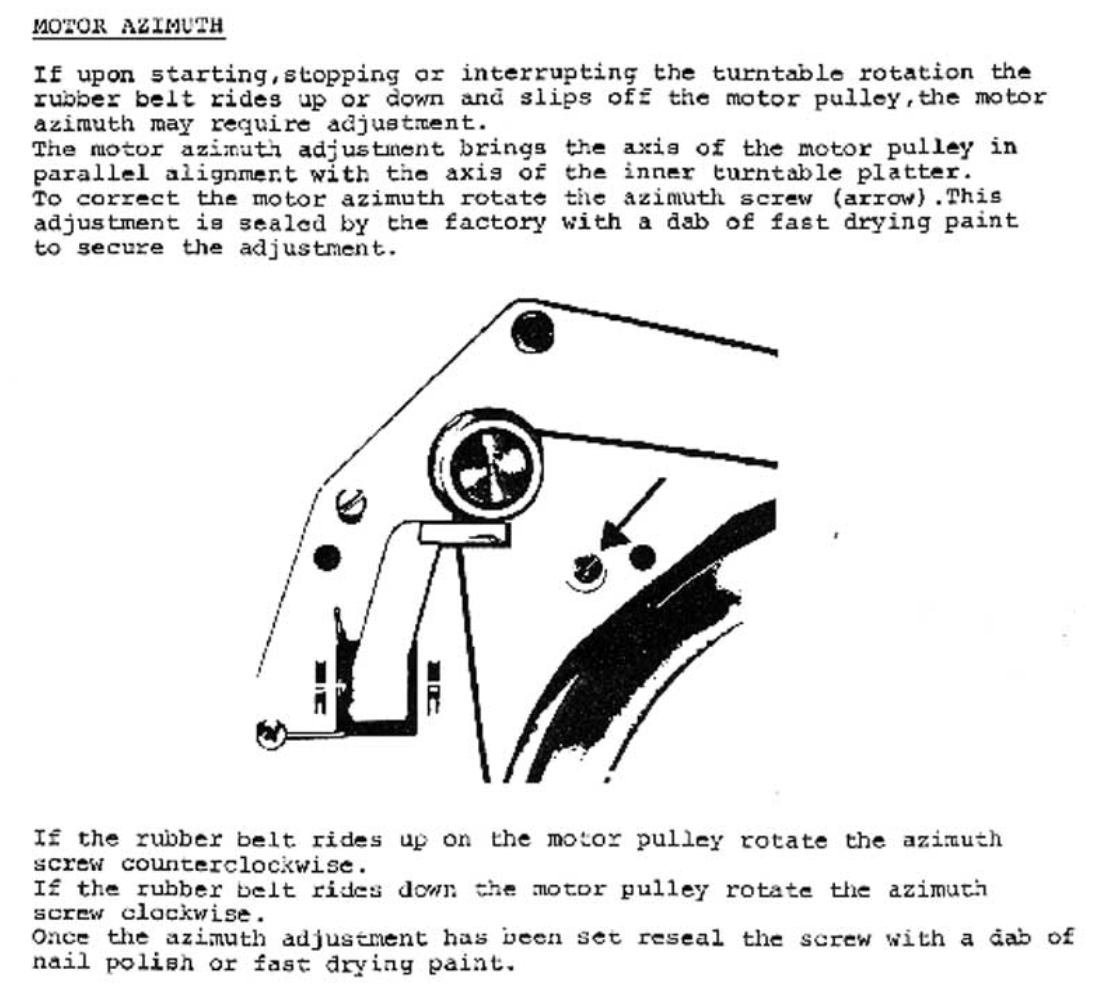

It appears that the belt won't stay on the pulley because the motor shaft is not parallel with the platten shaft, since the belt seems to fall off at the bottom, it makes sense that the motor shaft should be pitched more toward the platin shaft. One way to do this would be to tighten the two screws that are farther away from the platinum and loosen the screw closest to the platten. This did not work.
The next step would be to get a screw with a longer thread shaft so that the top of the motor shaft could be tilted even toward the Platten.

Thanks for the responses. At least I know that the spring on the motor mount was for the azimuth adjustment, and not for vibration.
I literally spent hours trying to get the screw into the azimuth adjustment motor mount, but without success.
As of right now the pulley and belt are working properly without the spring. I will keep the spring, so that if the belt no longer stays on the pulley, I will find a way to attach it and use it to adjust the azimuth.

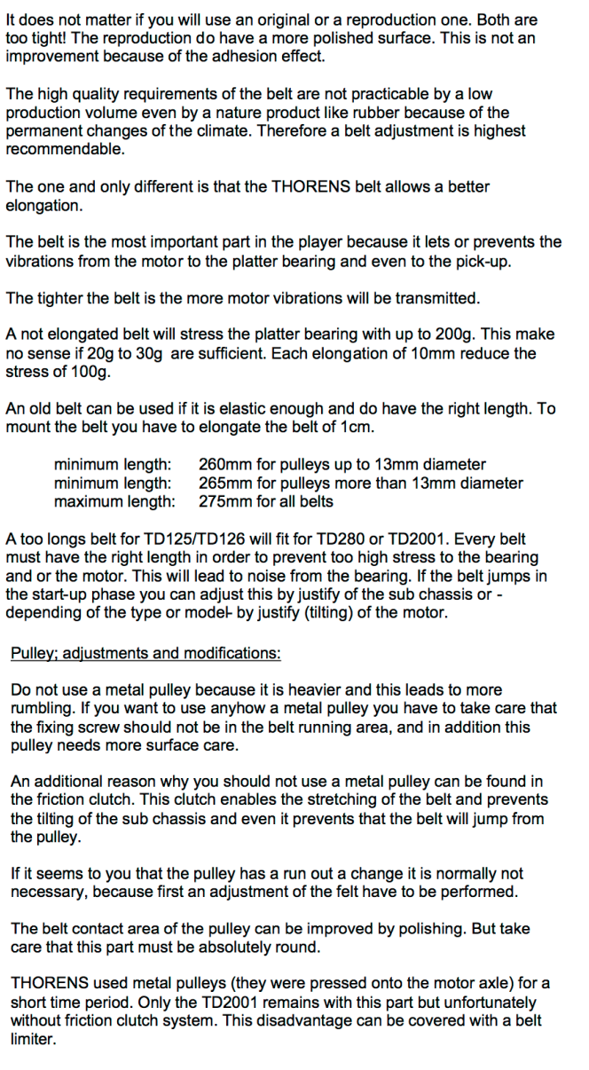

I mentioned pulley position, when you replace the pulley, it can be set too high or low, which can be a problem for the belt position. 0,5mm too high or too low pulley can lead to belt issues.
Regarding the PDF by Logon; not an official Thorens document. There's too many belts to say all are too tight, in my experience they are not.
