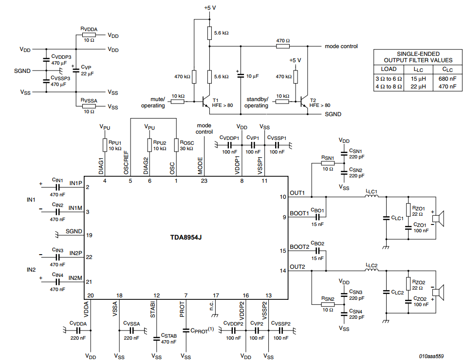

Can you please help me to repair Behringer Subwoofer (B1200D Pro). I didn't find the schematic. I used TDA8954 datasheet as a reference. I attached the schematic from the datasheet.
I replaced the chip but the subwoofer stayed silent. After checking I found a broken leg of Llc1 (restored it) and strange value of Rvssa (150 ohm instead of 10, changed it).
Now all voltages seems ok (+-37V), but OUT1 is -20V, OUT2 is -12V.
Each measurement was done in seconds (less then 5 sec I suppose), because TDA8954 worms up greatly, and I had to remove it from the heatsink to be able to measure.
Can I check something more?
Is the chip dead again?
Thanks.

The first thing to do is place a heatsink on the ic. With no load,VDD and VSS OK? Does it oscillate pin 10 and pin 14? If not it is probably damaged.
With no load VDD and VSS are ok (+-37V). There is no oscillation on pins 10 and 14 (just constant negative voltage: -20V and -12V...The first thing to do is place a heatsink on the ic. With no load,VDD and VSS OK? Does it oscillate pin 10 and pin 14? If not it is probably damaged.
Ok, it seems it is damaged. What should I check before replacement? How can I find the reason of the damage?
PS: The voltage from Rvssa is applied to VSSA pin of the chip. Before the replacement of Rvssa there was -3V. Can this be the reason of the chip damage?

VSSA is the driver supply internally. I should think the chip just died, either of natural causes or overload. Make sure the Boot Strap capacitors are not leaky!

Maybe the -VSSA pin is the most negative pin in the internal IC substrate and because of 150R "initial" value, the voltage here goes less negative than output and this *maybe* have destroyed the chip due some internal parasitic thyristor or bipolar action.
For example, chips like TDA7293 explode if the output -V pin is more negative than pre -V pin.
So *maybe* with all correct values and legs in place, the amplifiers works again.

Thank you for the thorough checking algorithm. I didn't measure the ESRs - I need to buy or make the device. I ordered one more TDA8954. Waiting for the arrival. I managed to obtain correct voltages with the burned chip, except the absence of the oscillations on the output pins (there was constant negative voltage on them).So, did you make any progress repairing your amp ?
By the way, when I changed the chip, I turned the amp via filament lamp, but the amp didn't turn on. It looked like this: the lamp gradually started to glow in full force (it took about a second) then abruptly turned off, then the process repeated. So I excluded it. I suppose such behavior was determined by a switching power supply.
