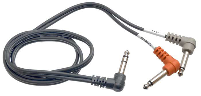

You mention TRS cables, but in an insert, you need special cables. The TRS plug goes into the insert jack itself, then the other end of that cable becomes two TS plus - a sort of Y-cord. What are you trying to connect to the inserts? Usually the snake takes something on stage and connects it to a remote mixer. Anything I put in an insert, I kinda expect will be where the mixer is, not back on the stage. SO at the moment, I can't think of something to send down a snake.
And just to be sure, when I say "insert jack" I mean the jack on each channel marked "INSERT".
Here is an insert cable:
It is a 10 ft long snake that has the 6 TRS plugs at one end and the 6 TS Y plugs at the other end. It is for hooking multiple effects to multiple channels. It's just 6 separate cables wrapped in a snake.

SO with nothing in the inserts, the mixer works OK, but shove an insert cable into the jack and it kills the channel??
If so, get an unwired TRS plug, and short the tip and ring together. Put it in the insert jack. That shunts across the send and return. DO you still get sound, or does that also kill sound?
