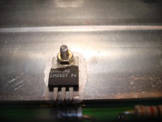

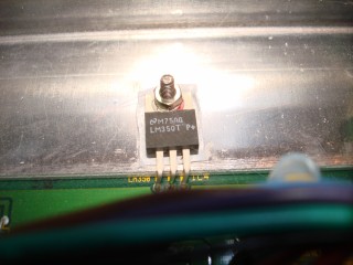

ICs 1 and 4 - Metal LM350T's with rubber/silicone insulators

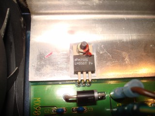

IC2 - Metal LM350T, which is chipped (from heat???) with two (2) mica insulators and thermal compound. This definitely looks like it has been replaced!

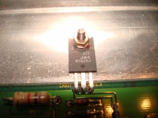

IC3 - Plastic 317/JRC/M7028J with no insulator.

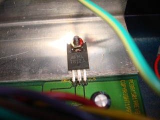

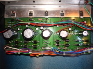

Ok, finally I'm attaching some pics of the ICs 1 through 5, and PSU board...
You can see where IC2 is chipped/broken.
Voltage Readings
I traced the wires from the PSU circuit board to the connector plug and took voltage readings. I'm not getting anything on pins 5 and 6 (+12v and +5v, respectively), so it would appear IC4 is the culprit. All other pins are showing correct readings.
I'm aware of the IC upgrades for these PSU's, but don't know of a supplier. :wink:
There are two separate grounds, one for the audio supplies and another for the digital/control supplies. If the supply unit is connected to the mixer they may all be connected together inside it, but not in the PS unit alone. The 12 and 5 are those digital/control supplies. 12 and 5 have nothing to do with either 17.
The IC is not chipped from heat as in heat inside the chassis, it might be chipped from heat as in the heat inside it as the silicon boiled when it failed.
Look on the board, are there not points on it labelled +17, +5, etc? And some marked as GND? If you see AGND and DGND or some variation, that indicates the digital ground versus analog ground. IN any case, on the cable to the mixer there are two ground pins, and to make measurements of the 12 and 5 outputs you need to use pin C rather than the center ground that serves the 17v rails.
